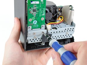

The Boxee Box' wireless board is secured to the metal frame by more Phillips screws.
It certainly is refreshing to see common screw types in electronics. When you don't need special tools to repair devices, it's easier to fix it yourself.
The wireless board is held on by a data connector and a couple antenna cables.
