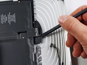

Insert the flat end of a spudger under the top edge of the battery and continue to separate the adhesive.
Continue doing so until the top of the battery is free from the rear panel.
