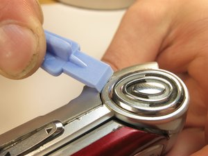

Using a spudger, pry off the phone casing near the speakers as shown. Tabs located on the inside of the phone may make this difficult and some force may be required.
Slide the casing slightly forward towards the top of the phone to remove.
