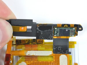

It appears that Apple left in room for a camera in the top of the device. There is a 6mm x 6mm x 3mm space between the Broadcom chip and the wireless antenna. There isn't enough depth for an iPhone-style autofocus still camera, but just enough room for the camera that Apple used in the 5th generation iPod nano.
