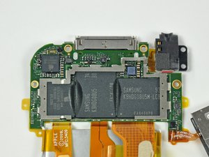

The Samsung branded NAND flash.
There are two 128 gigabit packages, for a total of 256 gigabits. Divide that by eight, and that's 32 gigabytes of MLC NAND flash.
The chips looked like that when we removed the speaker, we didn't damage them ourselves. We're not sure if that's just adhesive, or if the packages were actually slightly melted.
