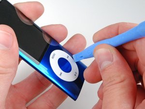

Apple has redesigned the click wheel on this nano. Instead of being (fairly permanently) affixed to the case, we were able to rotate and lift the click wheel.
You can use a spudger to completely remove the click wheel without taking the rest of the iPod apart.
