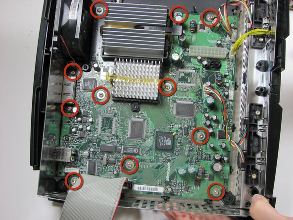

  • Remove eleven 3mm screws from motherboard, using a T10 Torx screwdriver. Refer to the picture to find all eleven.

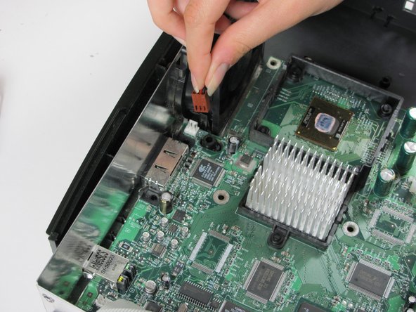

  • Unplug the power cable attached to the fan.

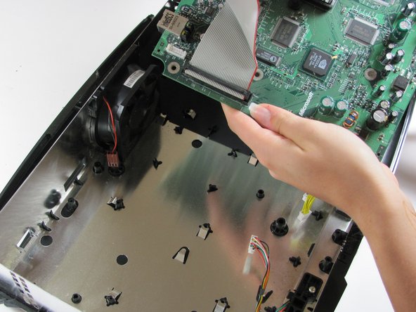

Add Note Edit Step 18  ¶
  • Remove the motherboard from the Xbox. As long as all of the screws are out and the fan is disconnected, it will lift out easily.
