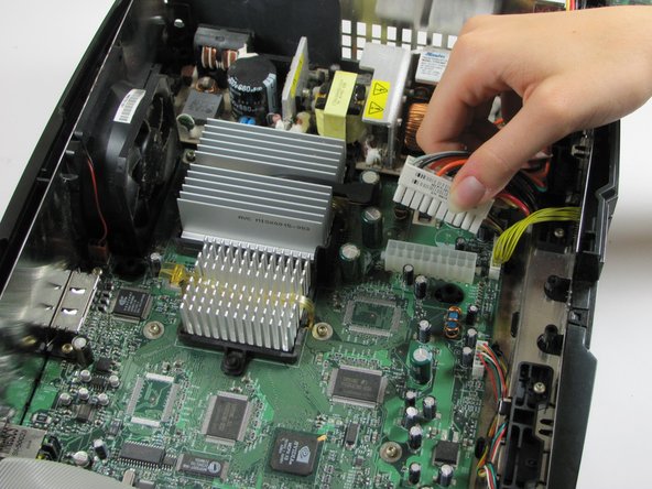

Add Note Edit Step 13 — Power Board  ¶
  • Unplug the multi-colored power cord from the motherboard. It is in there pretty tightly, so it may take some effort.

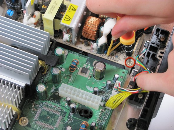

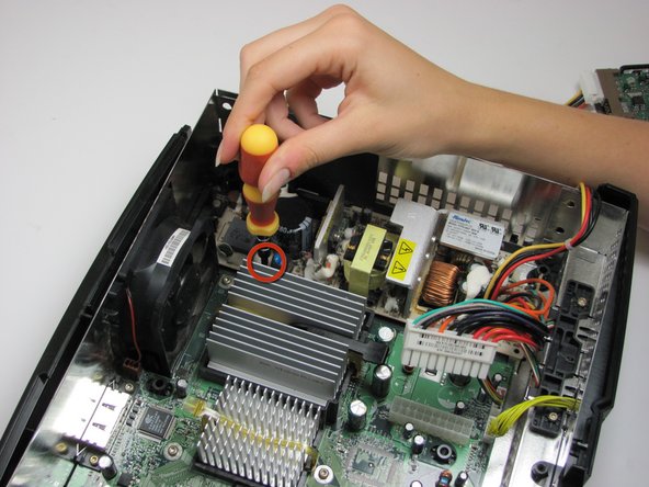

Add Note Edit Step 14  ¶
  • Using T10 Torx screwdriver, remove two 3mm screws from the tan power supply board.

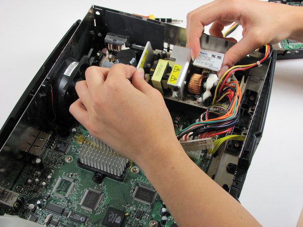

  • Remove the power supply and set it aside. It should lift right out.
  • Be very careful not to touch the copper coil or capacitors on the power supply. They may shock you.

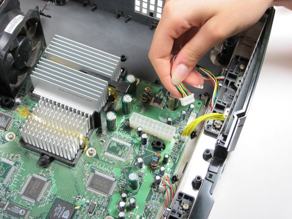

Add Note Edit Step 16 — Motherboard Replacement  ¶
  • Unplug the bundle of yellow cables as well as the rainbow cord from the motherboard.
