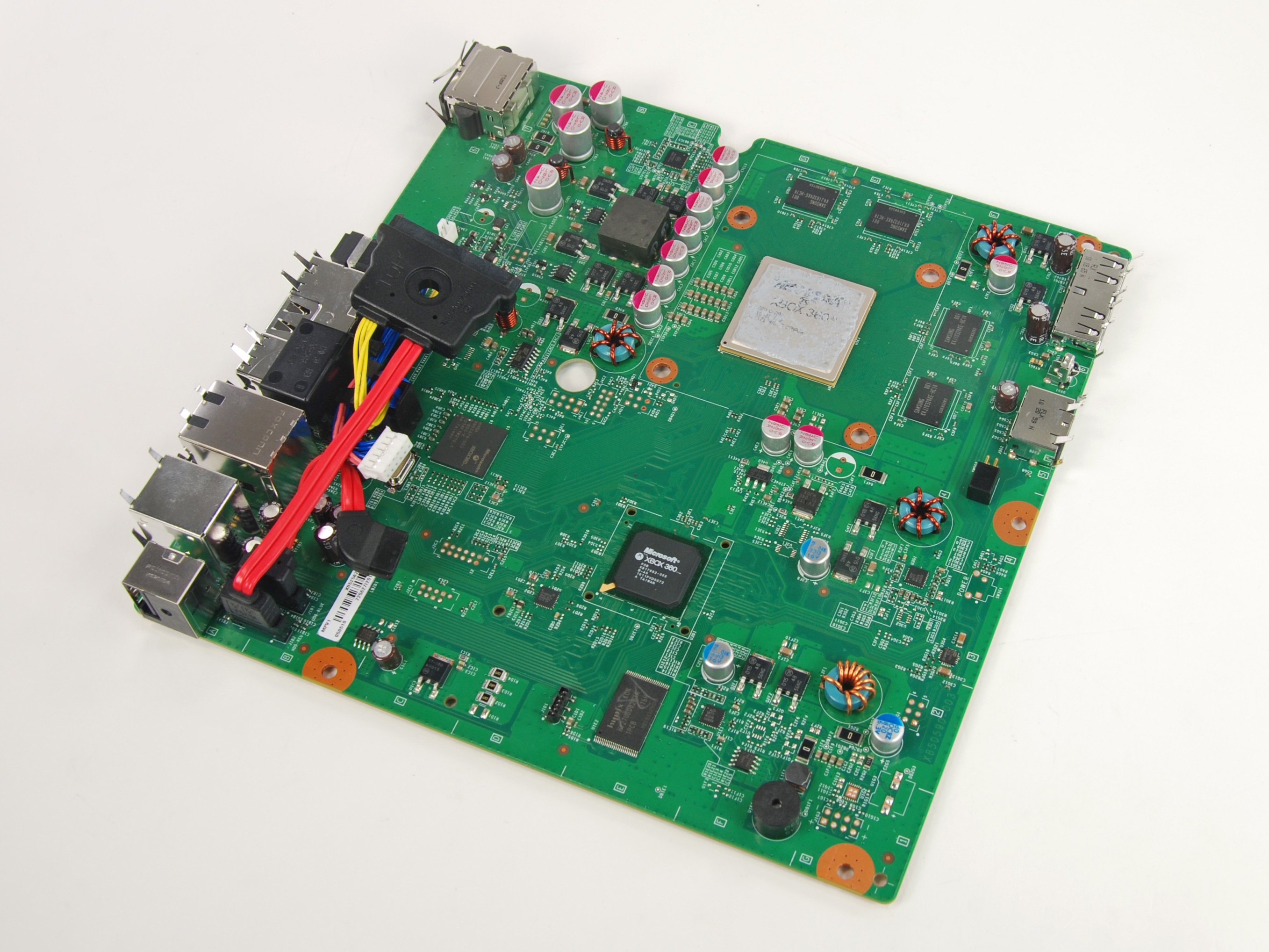

Image #1
Add Note Edit Step 59 — Motherboard Replacement  ¶
  • The logic board and its connectors remain.
  • When reinstalling a new board, remove the cables from this board and place them on the new board.
