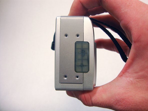

Add Note Edit Step 1 — Batteries  ¶
  • Flip the camera over so the bottom is facing you.
Image #1 Image #2
Add Note Edit Step 2  ¶
  • Slid the casing on the bottom right out in the direction of the arrow.

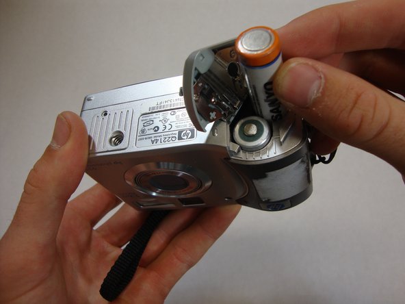

Image #1
Add Note Edit Step 3  ¶
  • Remove the batteries by pulling up on the top with your fingers.

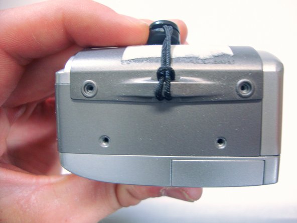

Image #1 Image #2

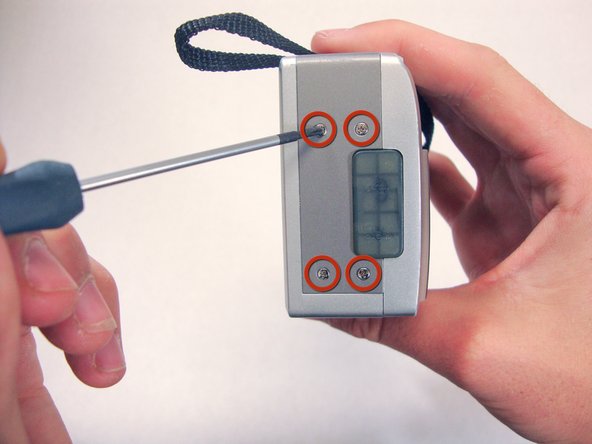

Add Note Edit Step 5  ¶
  • Remove the four 4.70mm screws in the left side of the camera.

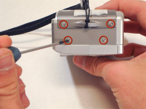

Add Note Edit Step 6  ¶
  • Now on the side with the strap, remove the other four 4.70mm screws.

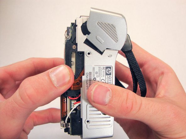

Image #1 Image #2 Image #3
Add Note Edit Step 7  ¶
  • Use your thumbs to pry the case apart.
  • It is easiest to pry to case apart if your start at the bottom.

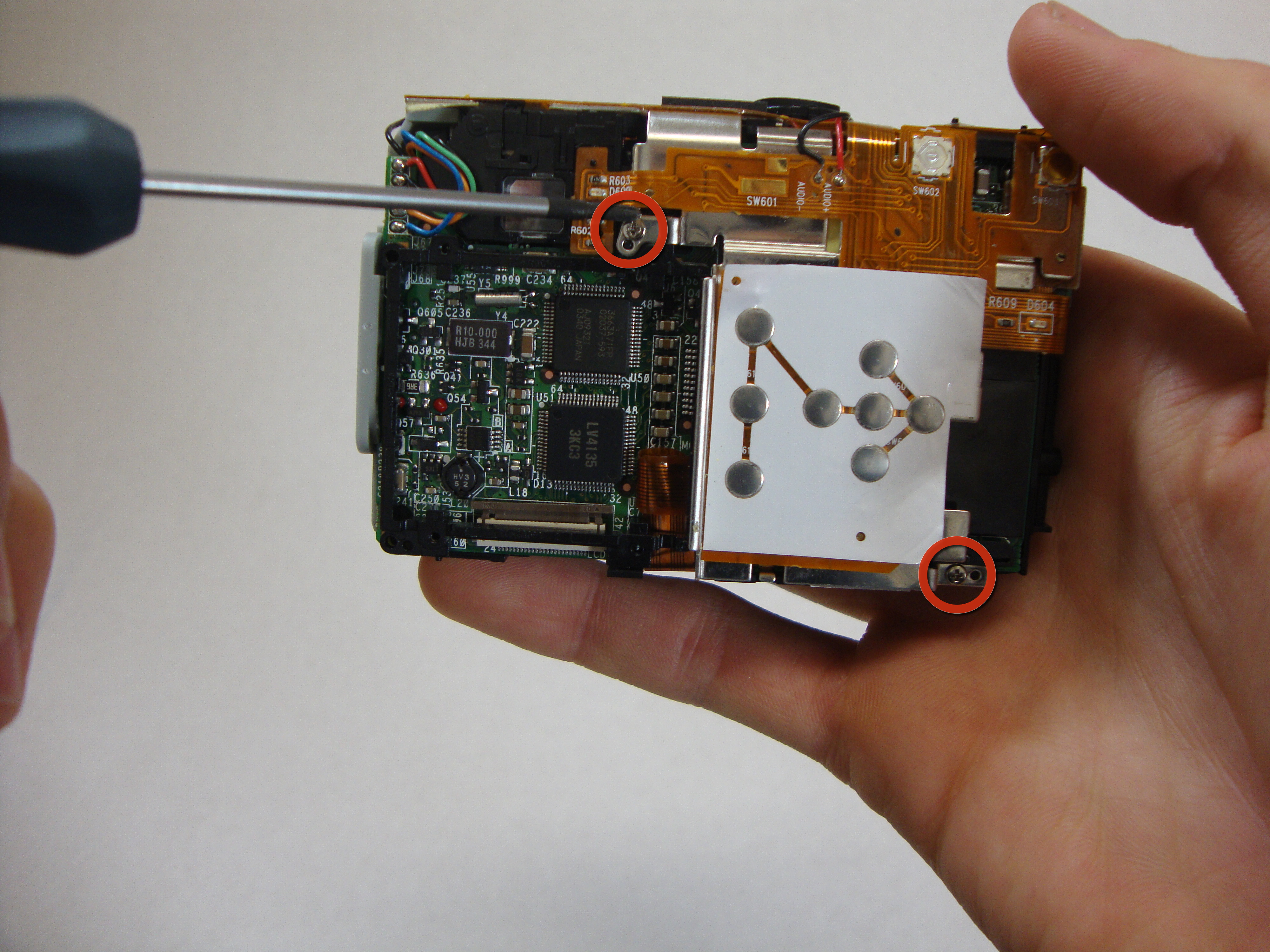

  • The case should come apart with minimal effort. If it doesn't, you can use a tool such as a Spudger or Plastic Opening tool.
Image #1
Add Note Edit Step 8  ¶
  • This step requires a significant amount of force.
  • Pull the bottom half of the inner camera out of case about half an inch. This may be difficult and force is necessary.
