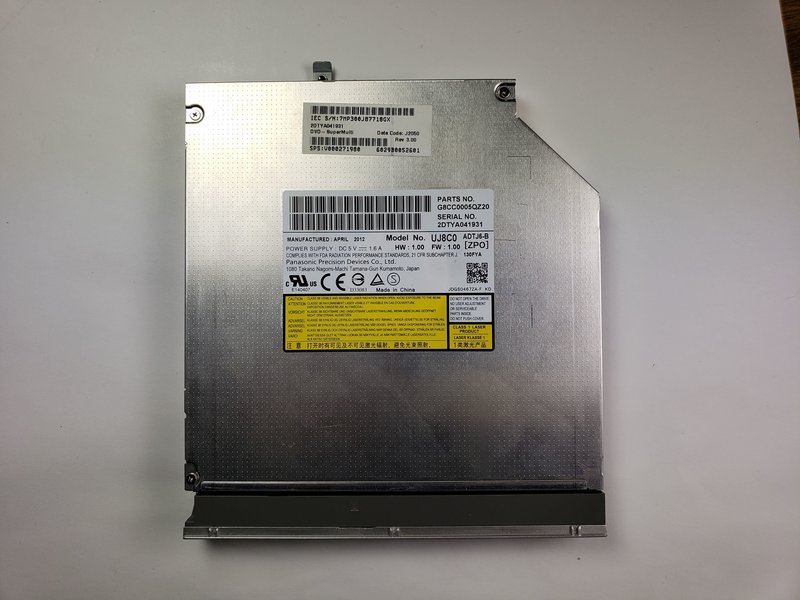

  3. Toshiba Satellite p875 s7200 Disk Drive Replacement: step 3, image 1 of 1
    • Use the Phillips head screw driver to remove the 6mm screw holding the disk drive in.
  4. Toshiba Satellite p875 s7200 Disk Drive Replacement: step 4, image 1 of 1
    • Removed Disk Drive.
