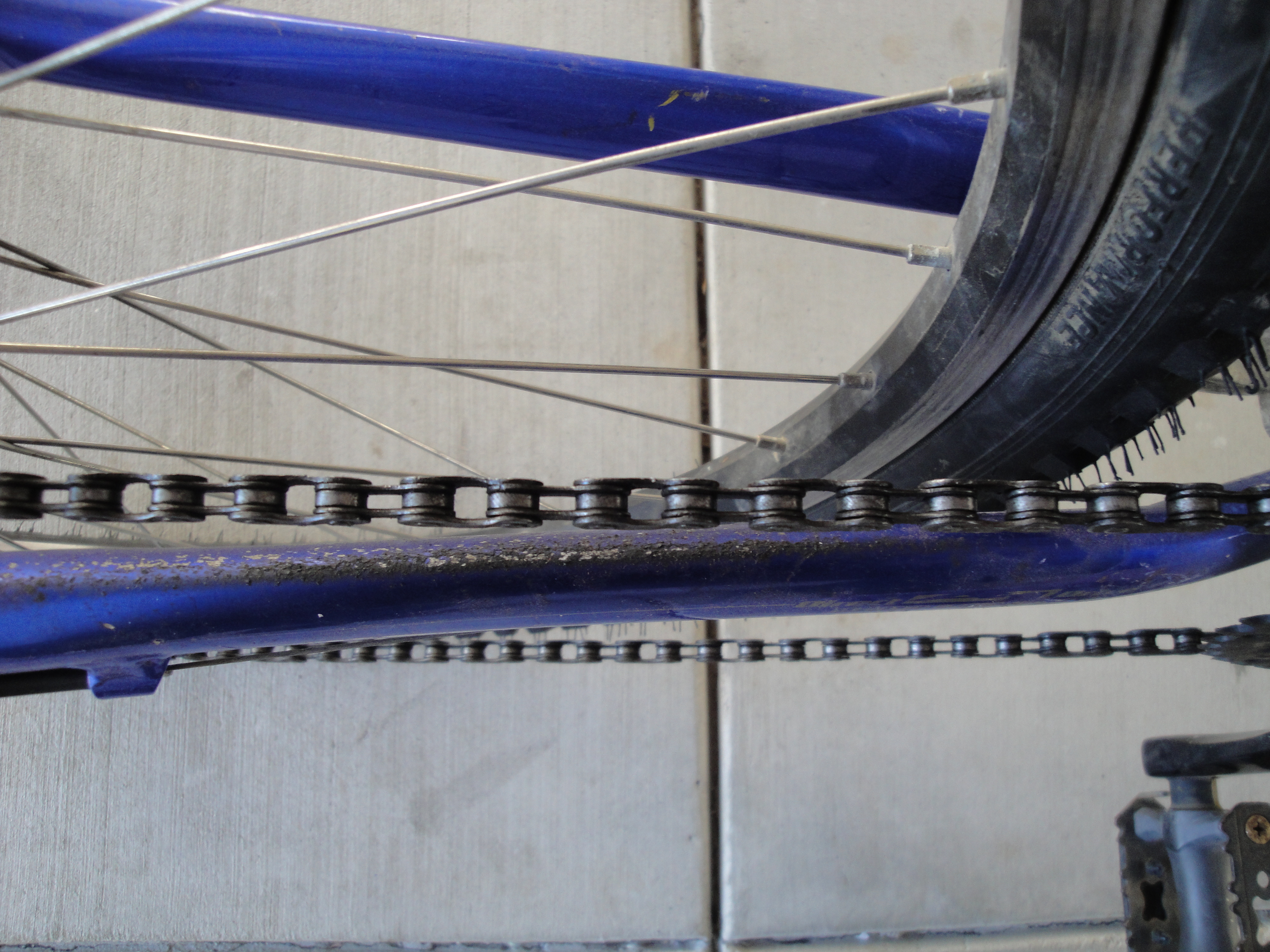

  • Slide the chain cutting tool onto the desired link.
  • Align the push pin of the tool with the pin on the chain, and tighten the tool until the pin protrudes out the other side without falling all the way out.
Image #1

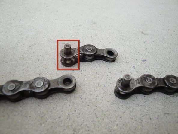

Add Note Edit Step 2  ¶
  • Stop pushing the pin out when it is just held in by the outer link, so it doesn't fall all the way out. You will still be able to separate the links.
  • Repeat the previous step to take off sections of links.
