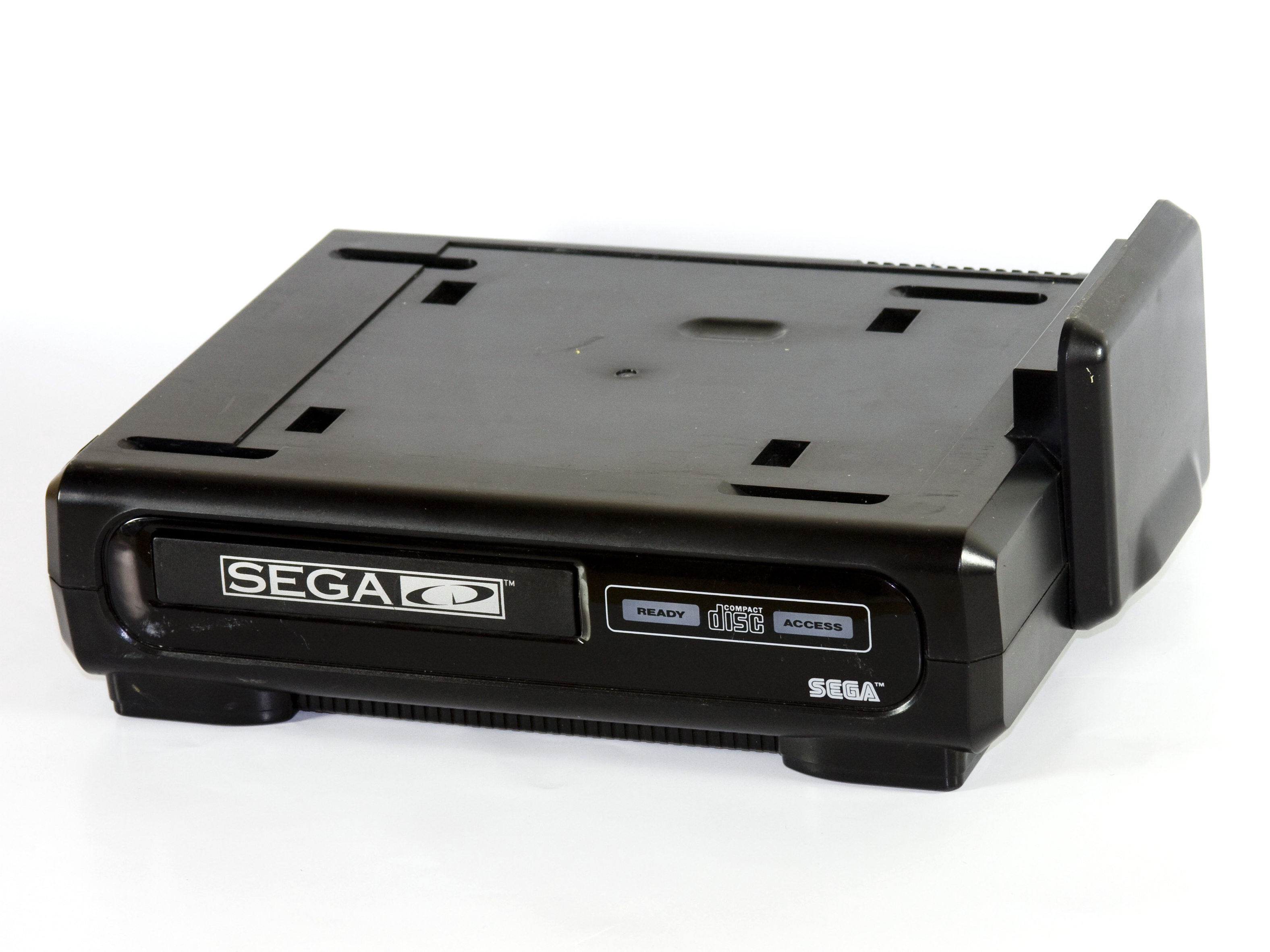

A list of all screws and their sizes that were removed while disassembling the Sega CD.
Main Case Screws: Six .46 x .1 in screws
Genesis Adapter: Two .38 x .09 in screws
Large Metal Plate: Three .46 x .1 in screws
CD Tray: Two .38 x .09 in screws
Small Metal Plate: Two .46 x .1 in screws
Motherboard: .475 x .115 in screws
Power Supply Board: Three .46 x .1 in screws
Optical Reader: Four .37 x .08 in screws
