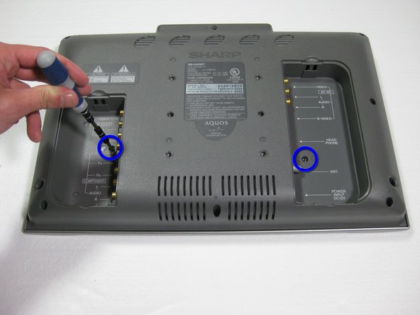

Add Note Edit Step 3 — Back Case  ¶
  • Remove the two back panels to display the audio and video inputs..
Image #1 Image #2
Add Note Edit Step 4  ¶
  • Remove the eight 6mm Phillips screws around the edge.
  • Remove the two 6mm Phillips near the inputs.

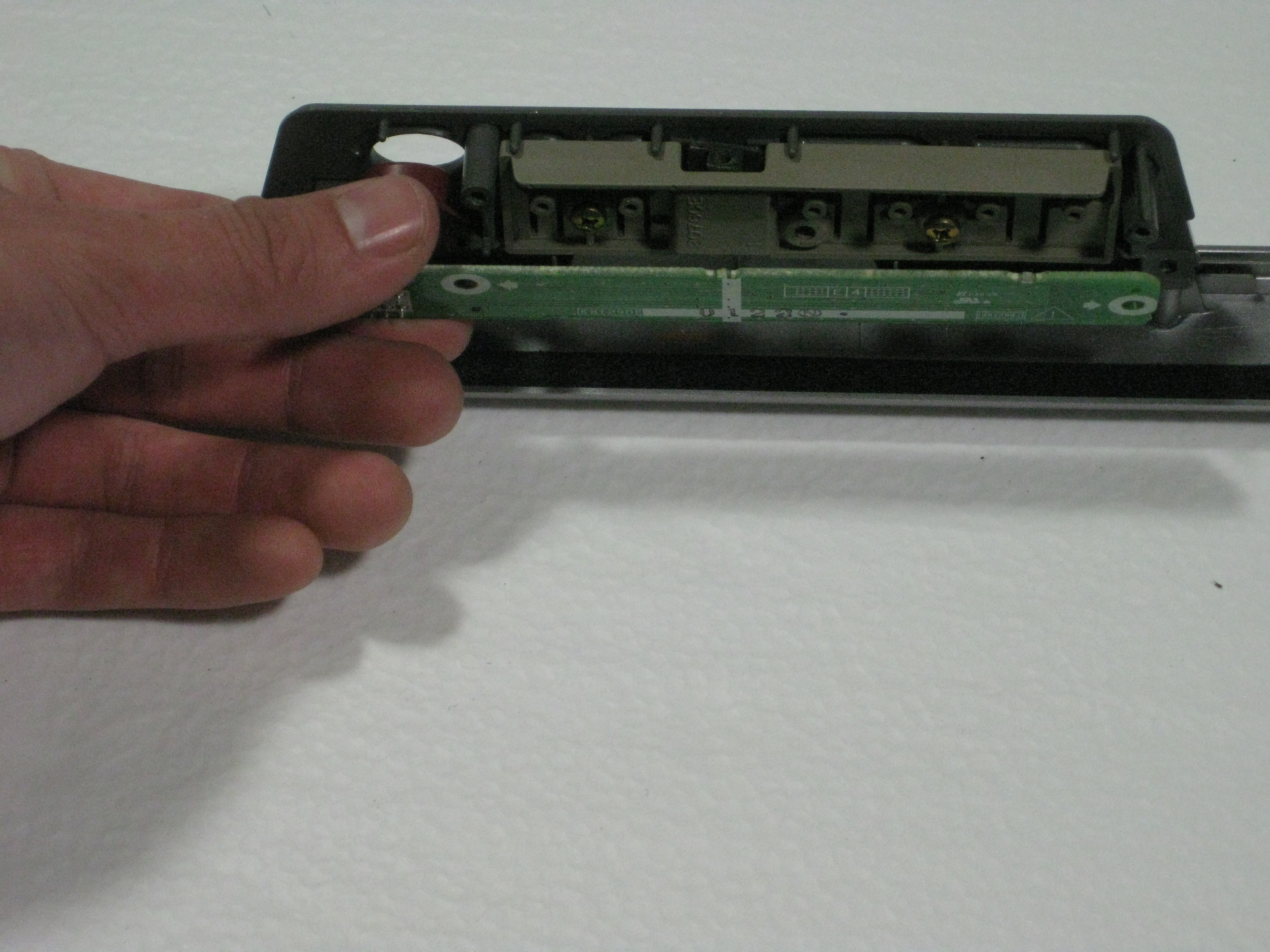

Add Note Edit Step 7  ¶
  • Remove the green and gray power connector from the side of the buttons panel at the top of the television.
  • Remove the green/gray to orange/gray connector from the center of the circuit board.
Image #1 Image #2
Add Note Edit Step 8  ¶
  • Remove the four 5mm phillips screws attaching the LCD and circuit board to the front case.
