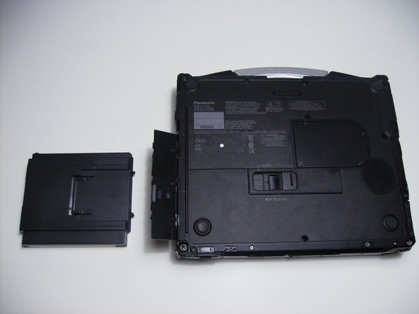

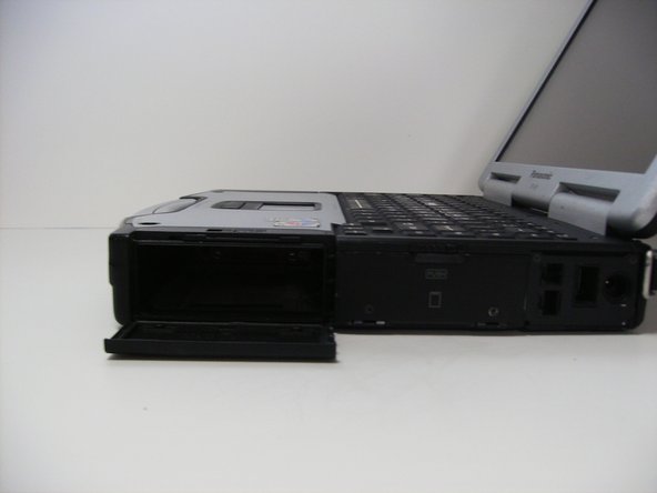

  • Locate the bay door for the battery on the left side of the laptop.
Image #1 Image #2
Add Note Edit Step 2  ¶
  • Slide the latch to the right and then down to unlock it.
  • Pull out the battery.

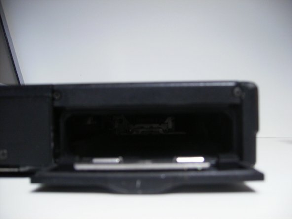

  • Locate the door for the hard drive on the right side of the laptop
Image #1 Image #2
Add Note Edit Step 4  ¶
  • Push and slide the latch up to open the hard drive door.
  • Pull out the hard drive.

Add Note Edit Step 5 — Optical Drive  ¶
  • Flip the device upside down with the handle facing away from you.
  • Open the optical drive bay by sliding its latch to the right.
  • Locate optical drive release mechanism on the bottom of the laptop.
Image #1
Add Note Edit Step 6  ¶
  • Slide the latch cover to the right.
Image #1 Image #2
Add Note Edit Step 7  ¶
  • Push the exposed switch to the left to eject the optical drive.
Image #1

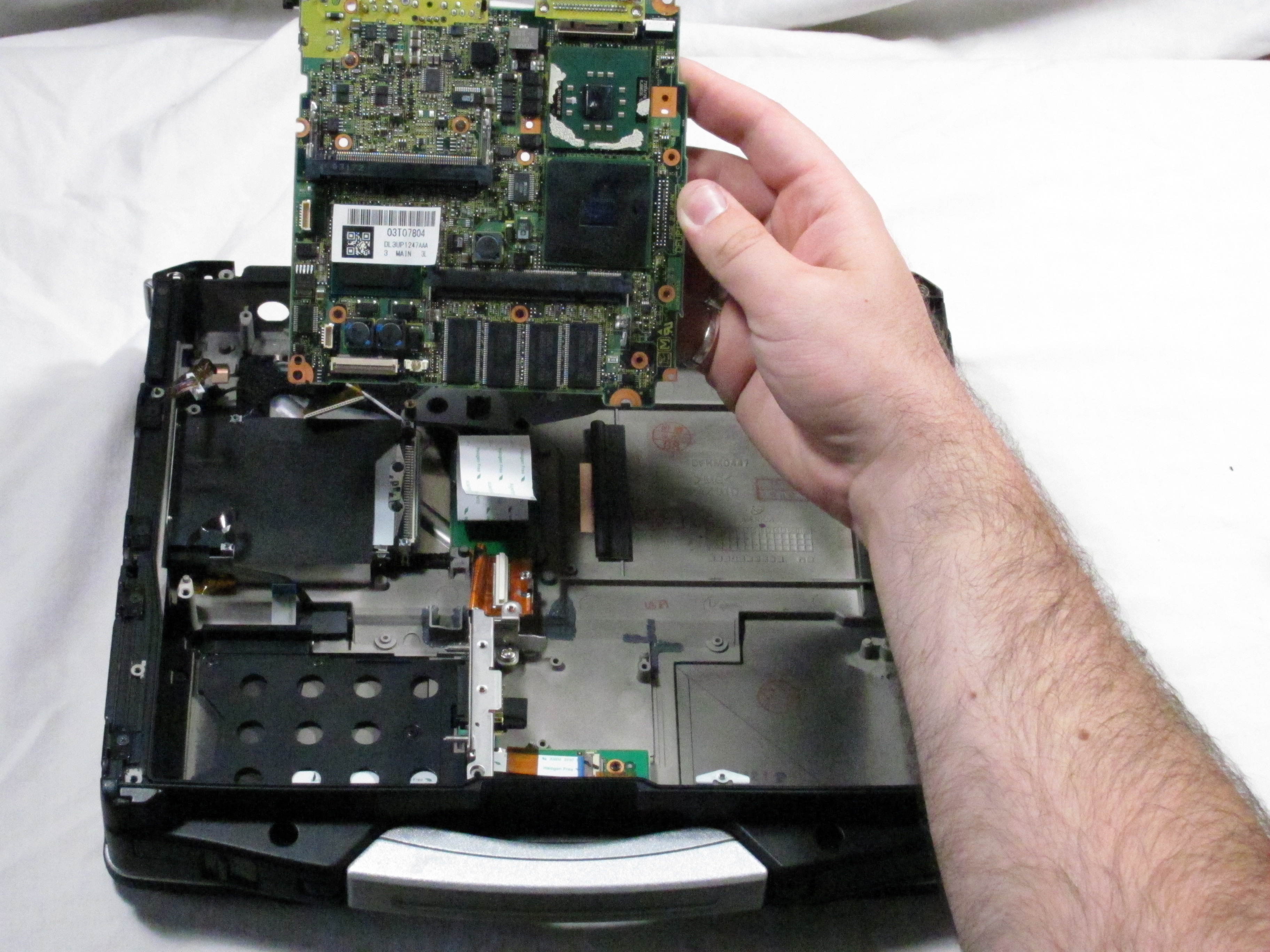

Add Note Edit Step 8 — Back Cover  ¶
  • Begin by turning the laptop upside down with the handle towards you.
  • Use a Phillips size 0 screwdriver to remove the 4 screws holding down the ram cover.
