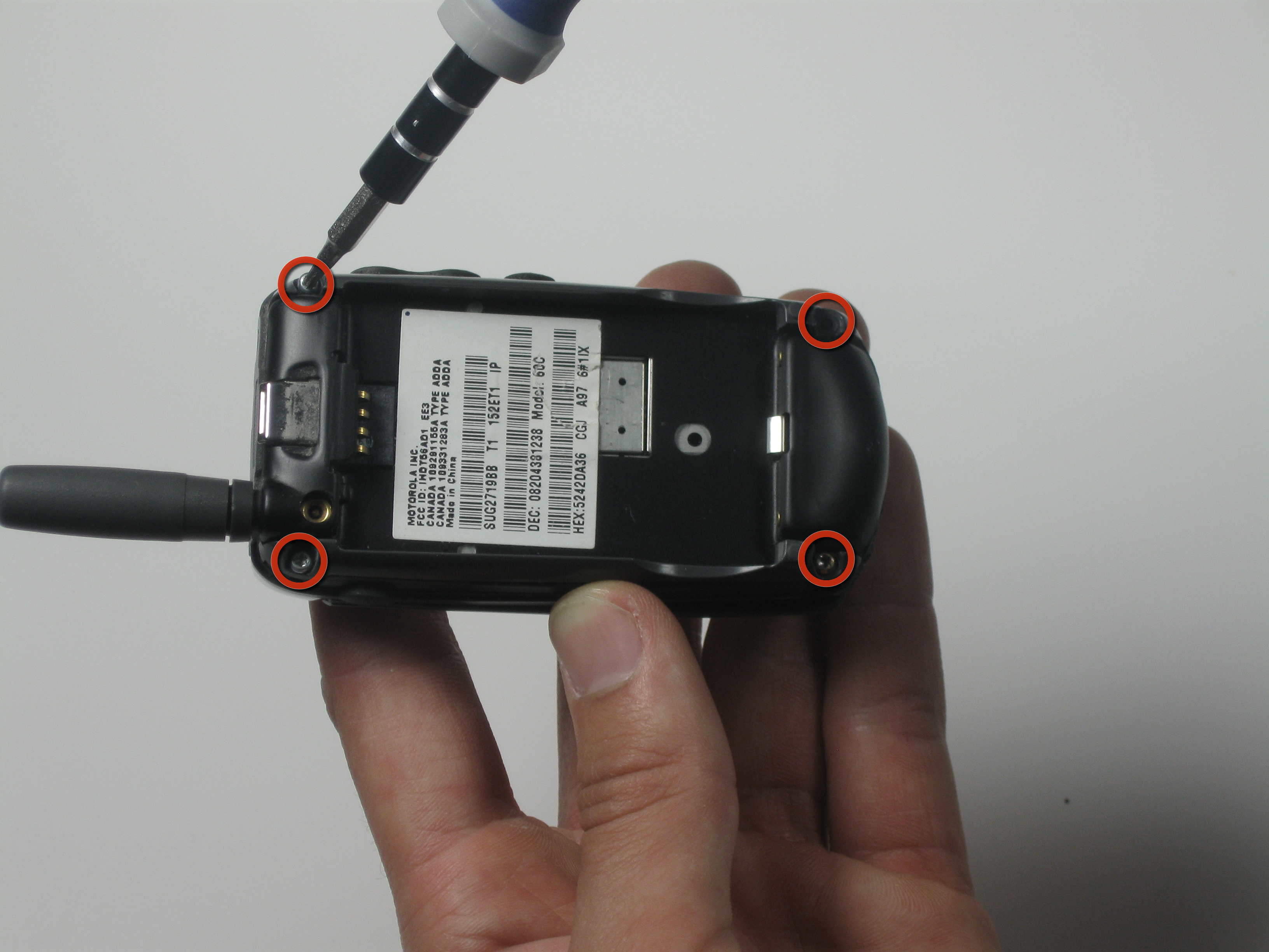

  • Remove 4 screws from corners using T-6 screwdriver.
  • NOTE: Bottom two screws are gold.
  • NOTE: Make sure screws return to correct place when reassembling.

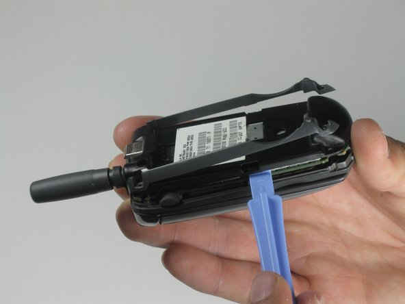

  • Use a plastic opening tool to pry up back cover from two side clips.
  • NOTE: sticker might be attached to rest of phone.

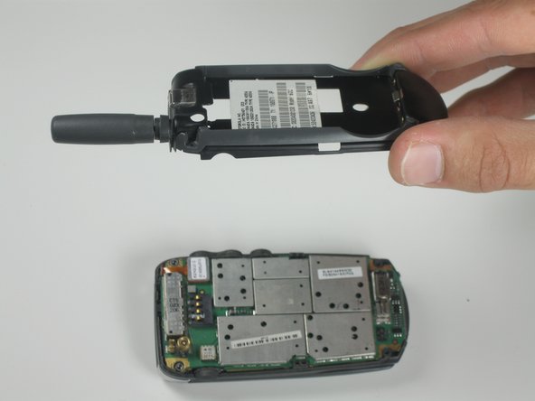

  • Remove the back cover.

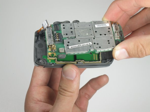

  • Use a plastic opening tool to gently remove the orange ribbon cable.
  • Lift up the main logic board.
  • NOTE: Rubber side buttons are not secure and might detach from the main logic board during removal.

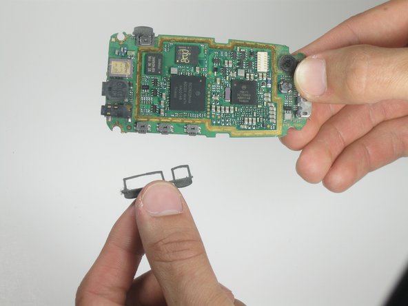

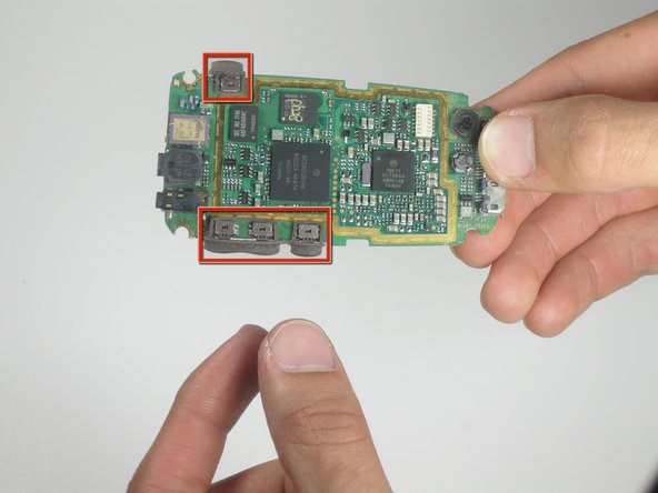

  • Carefully flip over main logic board.
  • Remove rubber side buttons.
