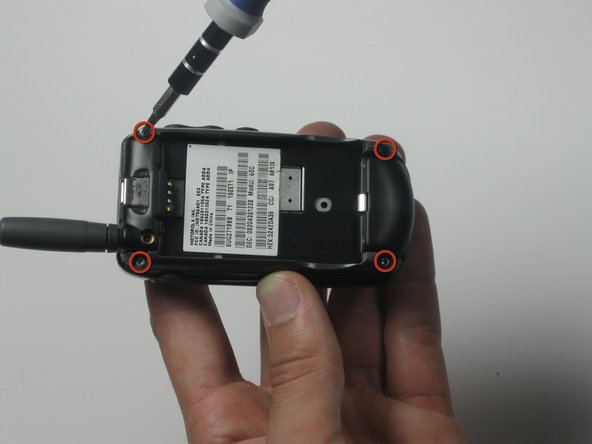

  • Remove 4 screws from corners using T-6 screwdriver.
  • NOTE: Bottom two screws are gold.
  • NOTE: Make sure screws return to correct place when reassembling.

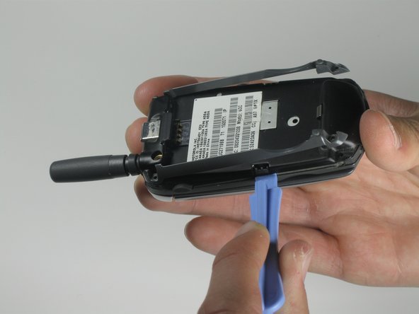

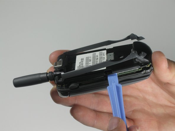

  • Use a plastic opening tool to pry up back cover from the two side clips.
  • NOTE: sticker might be attached to rest of phone.

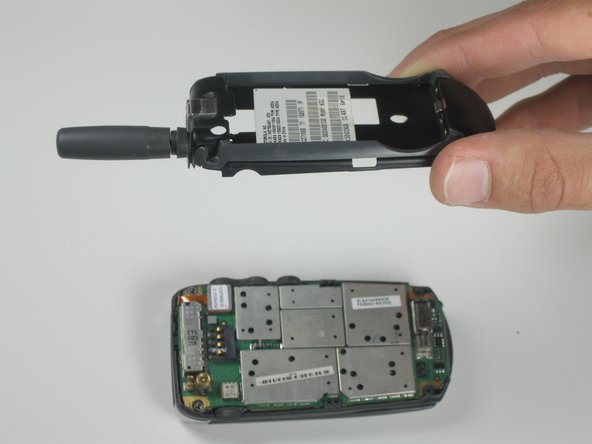

Add Note Edit Step 5  ¶
  • Remove the back cover.

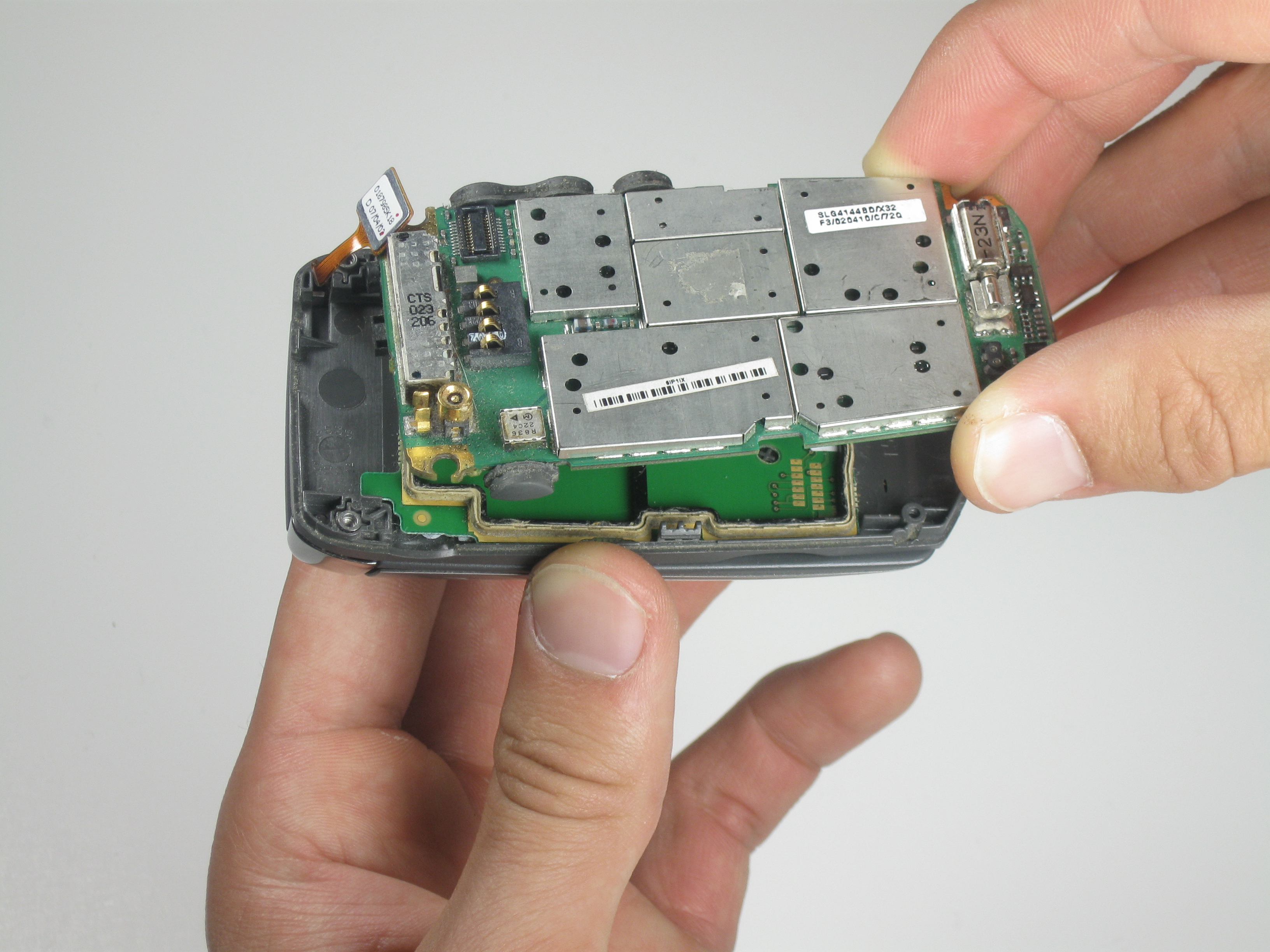

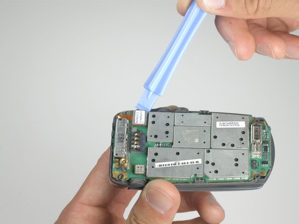

  • Use a plastic opening tool to gently remove the orange ribbon cable.
  • Lift up the main logic board to remove.
