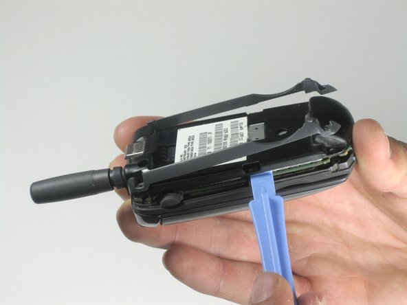

  • Use spudger to pry up back cover from the two side clips.
  • NOTE: sticker might be attached to rest of phone.

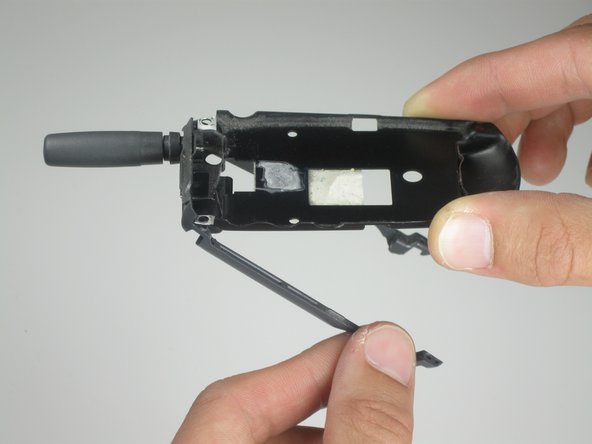

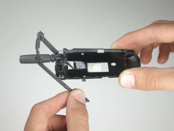

  • Flip over the back cover.
  • Remove the plastic frame.

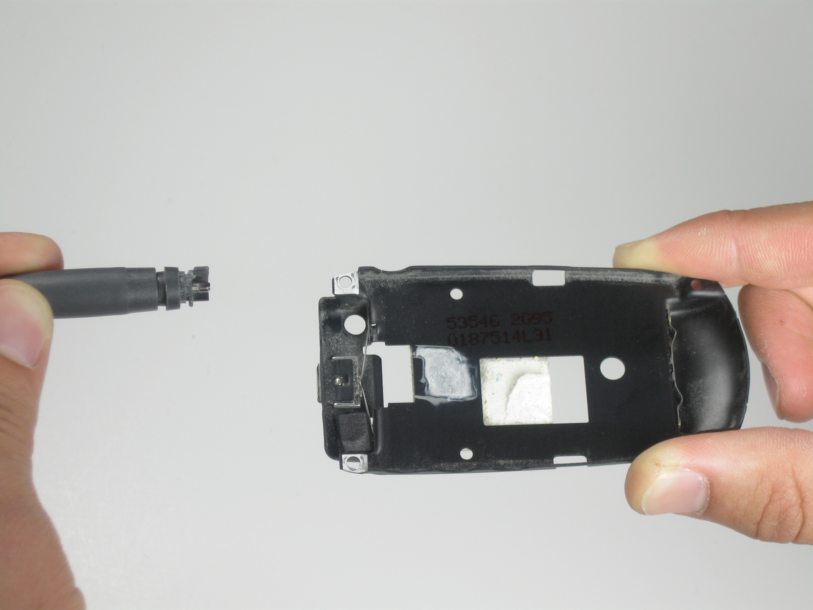

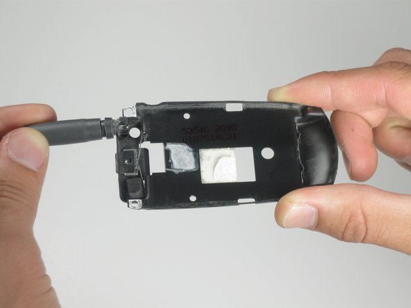

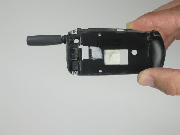

  • Lift up antenna.
