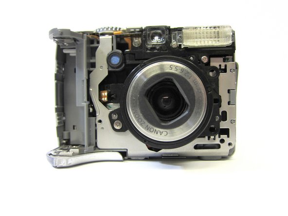

Add Note Edit Step 5  ¶
  • The camera should look like this once the front cover is removed.
Image #1 Image #2 Image #3

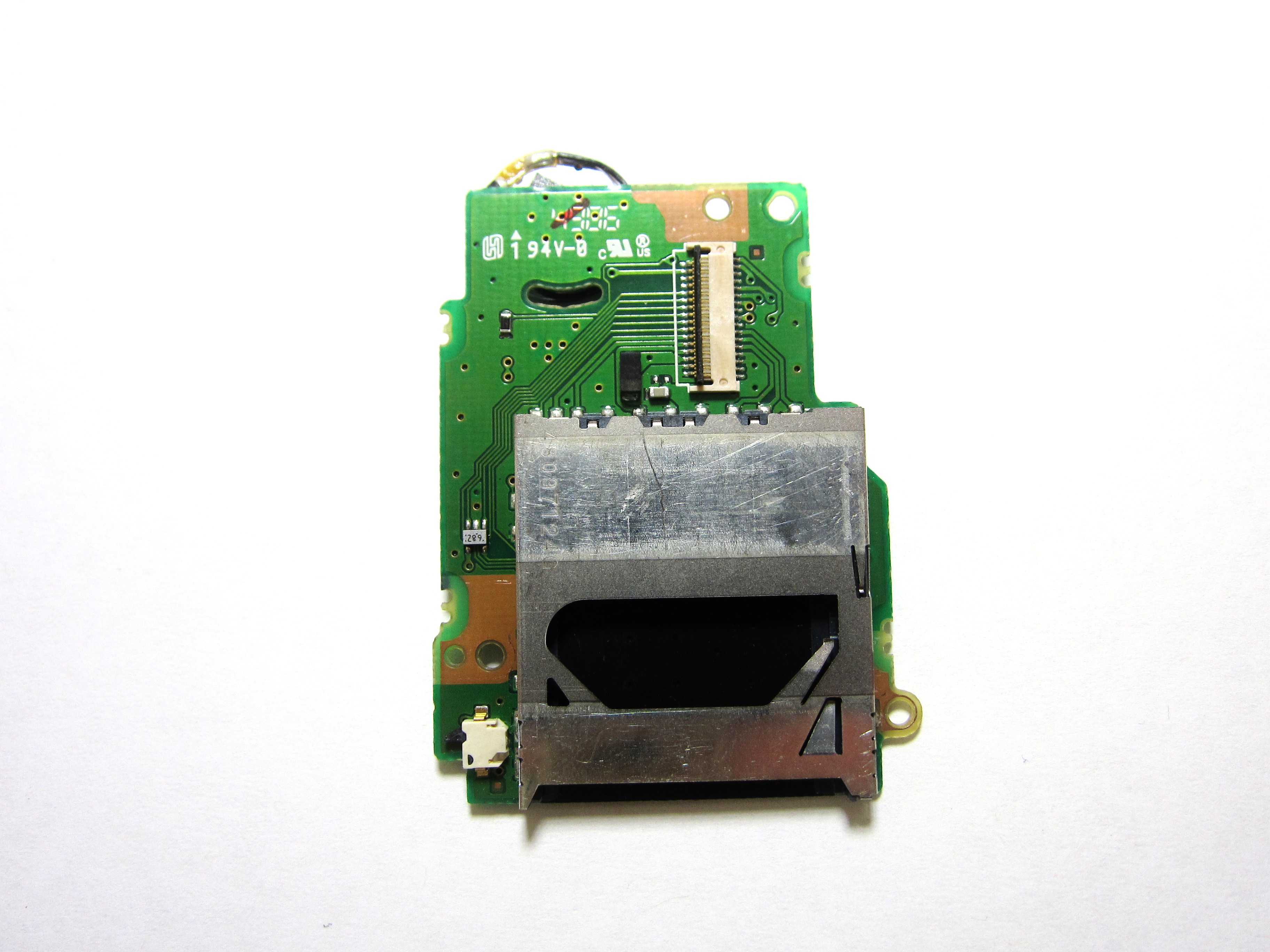

Add Note Edit Step 8 — SD Card Reader  ¶
  • Remove two 4.35mm phillips head screws from around the LCD screen using a #00 phillips head screwdriver.
  • Caution: Do not tug on the LCD screen. This will tear the ribbon connecting the LCD screen to the body of the camera.
  • Loosen the black ribbon clamp using an iPod opening tool
  • Release the LCD screen by removing the ribbon from the body of the camera.
