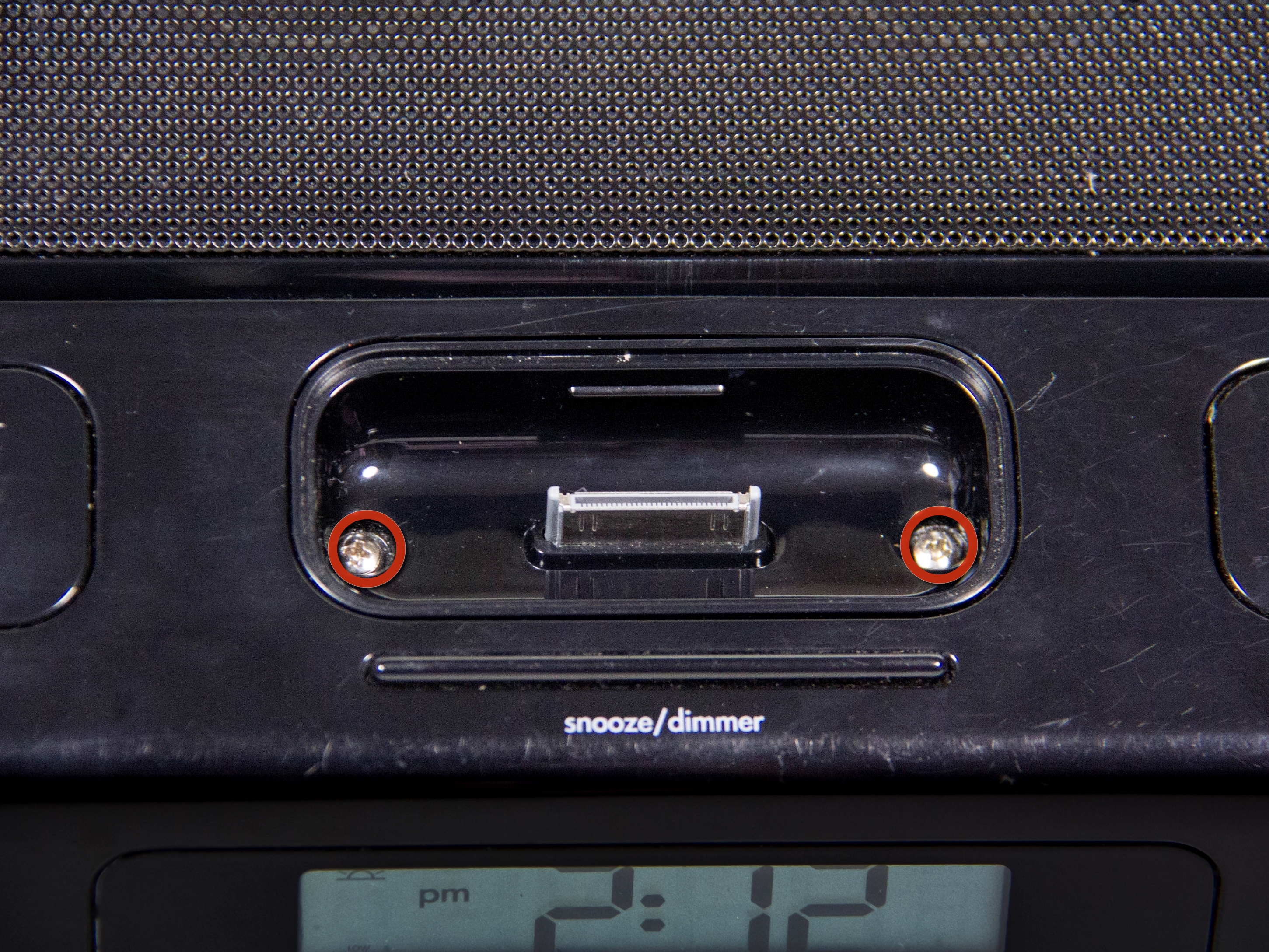

  • Set the device with the adapter facing up.
  • Remove the following screws:
    • Two 10 mm Phillips #0

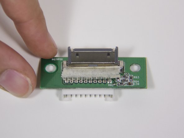

Add Note Edit Step 4  ¶
  • Carefully pry apart the bundle of white wires connected at the junction with the plastic opening tool.
  • Do this slowly. Don't scrape the covering off the wires.
  • Lift out the circuit board that has become loose.
Image #1
Add Note Edit Step 5  ¶
  • Pull out the adapter, and replace it with the new one.
