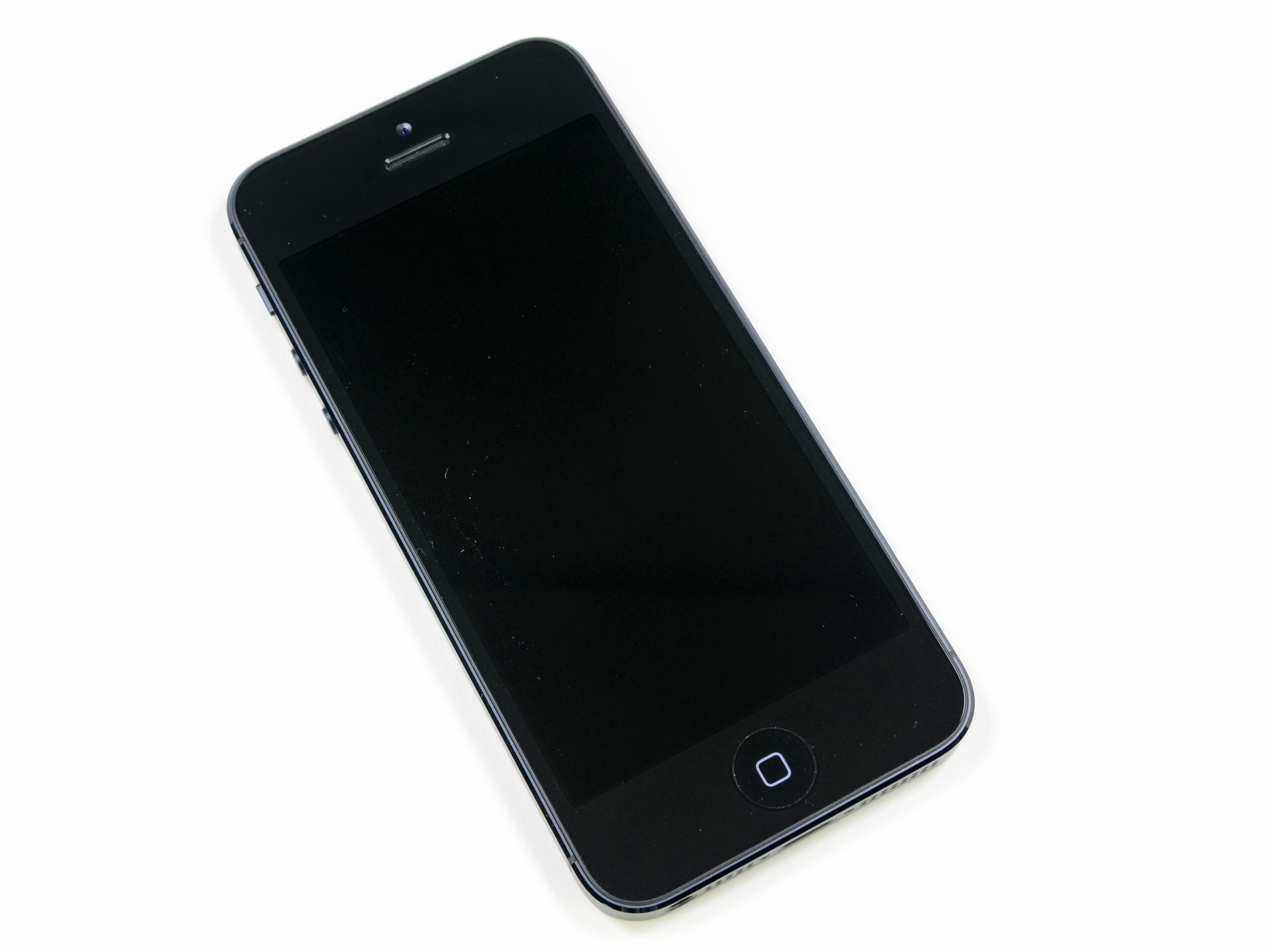

  • This Guide will teach you how to replace the iPhone 5 screen if it is cracked, damaged, scratched, or because you want to change the colour.
Image #1

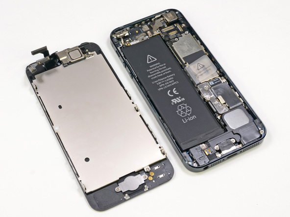

Add Note Edit Step 3 — Extract the screen  ¶
  • Now you need a Small suction cup to extract the screen.
  • Lift the screen carefully.
  • Don't pull the screen right now, there are some cables that you need to unplug.
  • If your screen is broken, you may have some difficulty in raising your screen. In this situation, you can put the tape properly on your screen and use the small suction cup to lift the screen.
Image #1 Image #2
Add Note Edit Step 4 — Unplug connector  ¶
  • Remove these 3 #00 Philips screws and lift the aluminum cover
  • With the Spudger, unplug the connector carefully and lift the screen
Image #1
Add Note Edit Step 5 — Finish  ¶
  • Now the screen is free, and easy to replace
