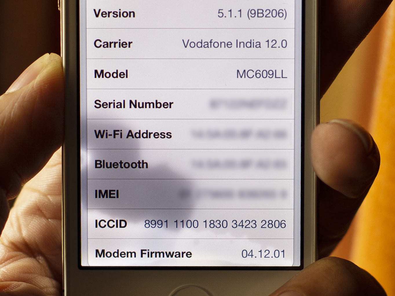

  • Anyways this is what the damage was, touch was fine, pixels were fine. I guess it was the backlight.
  • As you can see, the screen was damaged by a liquid known as Acetone/nailpolish remover which trying to fix the home button. Some of it seeped in the screen because i tilted the device upside down :/

  • Follow the steps to open up from the iphone screen replacement guide.Going to do the repair. Well i had no idea if i could fix it, just wanted to find out what exactly was wrong.
  • now we have the screen out, and that chrome with while border is a casing like stuff on the backlight, so i took it apart by peeling it off gently by the white plastic frame.
  • There we are, the chrome part is out, the backlight is naked and you see that transparent plastic part lying there, that is like a fiber optic transmitting light from the LEDs to the whole screen. That was basically damaged by that acetone/nailpolish remover.

  • This is the plastic part (ignore the crack because it broke while taking it out). But you see that damage on the top. Looks as if someone spilled acid :O. So basically light transmittance was obstructed to that part hence the dim spots.

  • took out the part, extracted the fresh, non damaged plastic backlight part out from it.
  • And just replace the part and put everything back with the chrome cover with plastic frame back on and reassemble your phone.
  • Sure looks back to what it was. at least 95% of it. Well its a job involving no cost at all ! worth that effort :)
