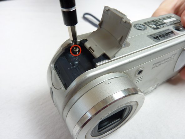

Add Note Edit Step 2  ¶
  • Open the memory card compartment.
  • Remove the screw next to the memory card slot.

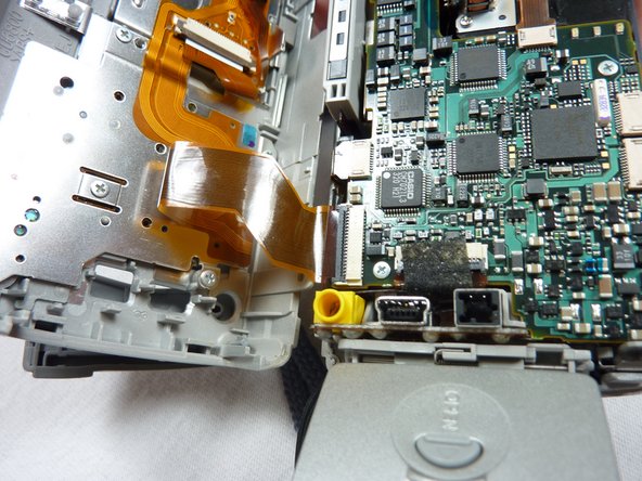

Add Note Edit Step 4  ¶
  • Unclip all of the clips holding in the circuitry simultaneously and remove the back case.
  • The circuitry will still be connected to the back case by ribbon cables.

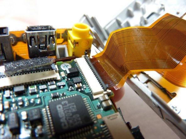

Add Note Edit Step 6  ¶
  • Unclip the clip holding the ribbon cable in.
  • Other ribbon cables might not have a clips.
Image #1
Add Note Edit Step 7  ¶
  • Pull the ribbon cable out.

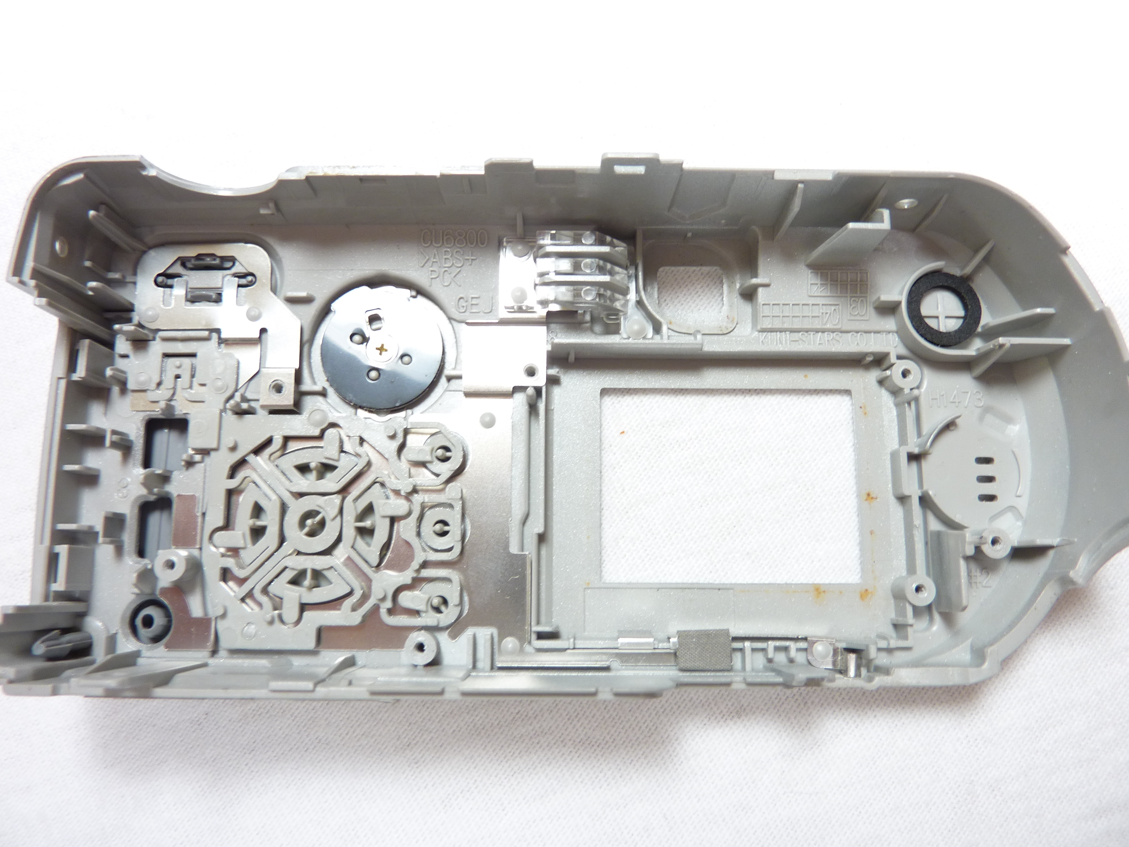

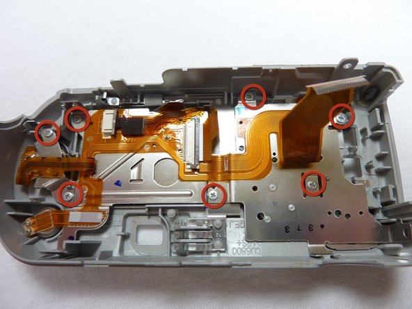

Add Note Edit Step 8 — Buttons  ¶
  • Remove the 7 screws on the back side of the case, as shown in the picture.
  • Remove the metal plate.
