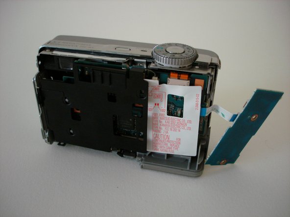

Add Note Edit Step 9  ¶

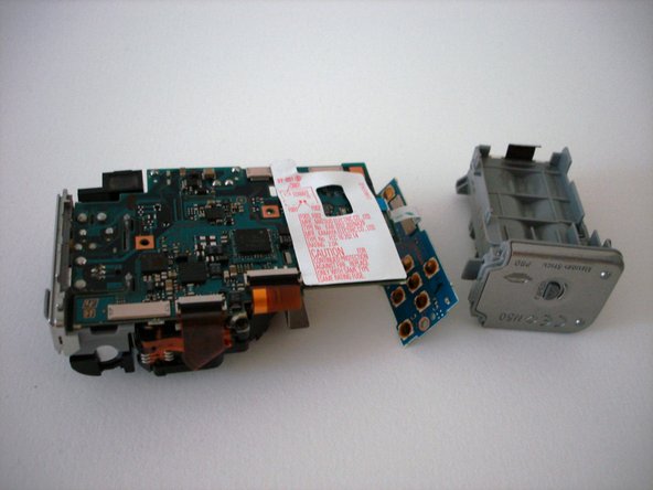

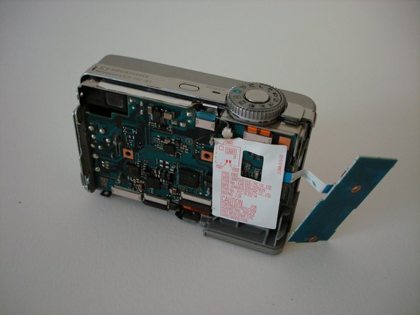

  • Now remove the plastic plate that covers the motherboard.
Image #1 Image #2

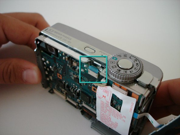

Add Note Edit Step 10  ¶

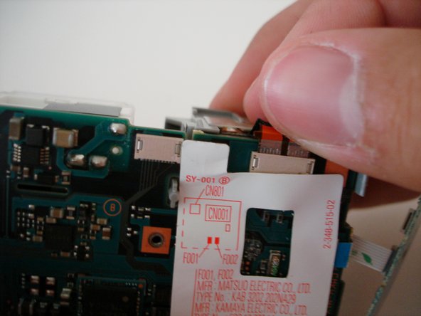

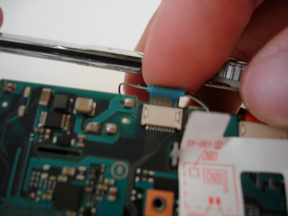

  • Warning: Electric Shock From this point on, hold the camera by the chrome edges ONLY. Capacitors store electric charge even if the batteries are removed.
  • Remove the blue cable.
Image #1 Image #2
Add Note Edit Step 11  ¶

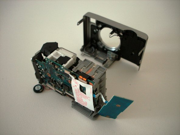

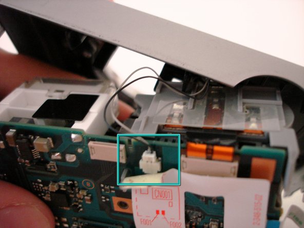

  • Disconnect the flash cable (black and white wires) before completely removing the front case.
  • Gently start to remove the case.
  • Once the cable is free, set aside the front case.
Image #1 Image #2

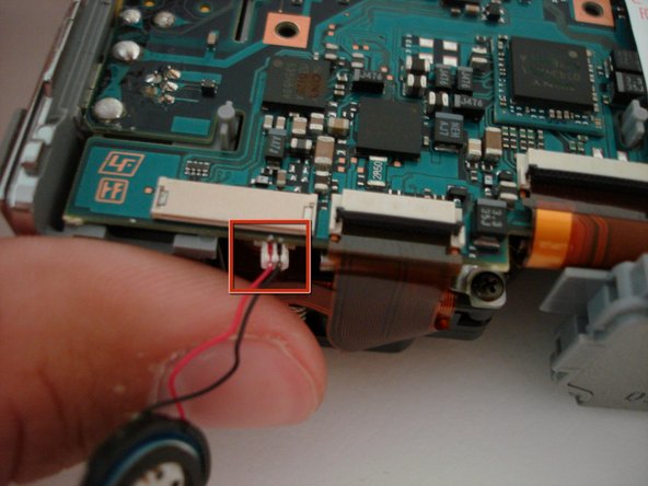

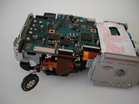

Add Note Edit Step 12  ¶
  • The speaker should now be clearly seen on the underside of the camera.
  • Gently unplug the speaker from the motherboard.
  • Replace the speaker.

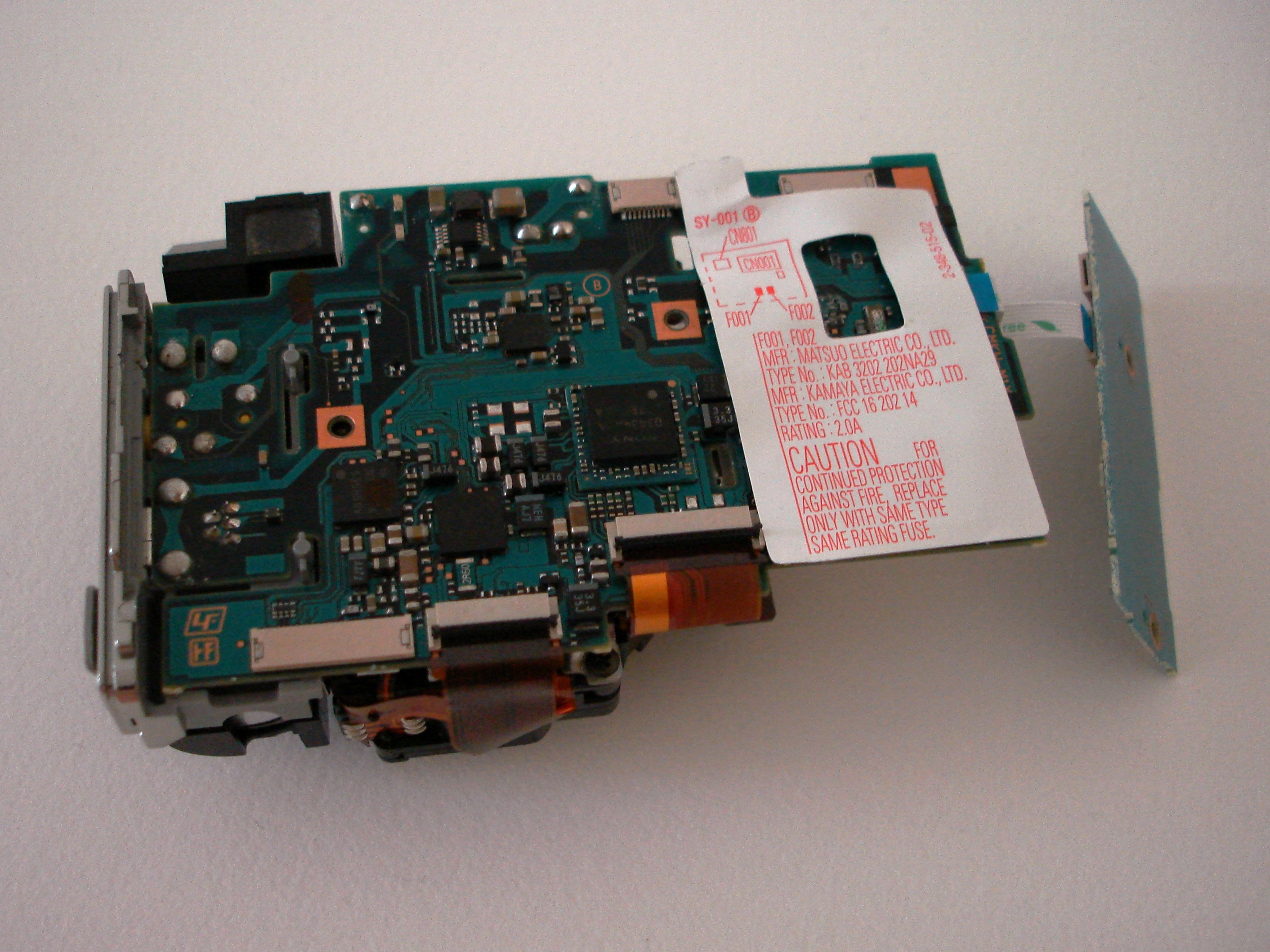

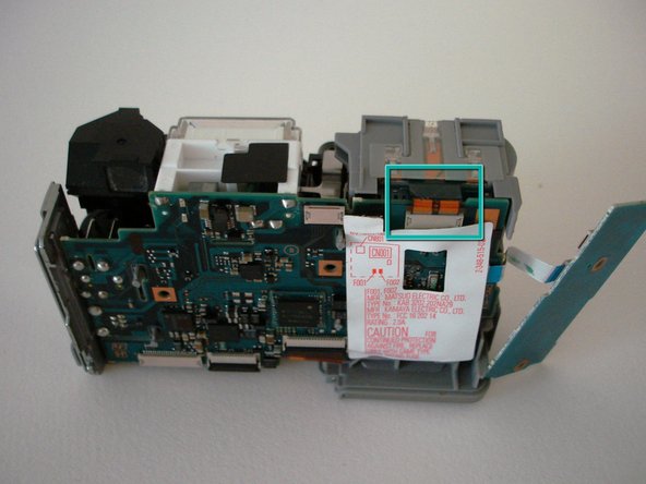

Add Note Edit Step 13 — Battery Terminal  ¶
  • Remove the orange cable connecting the battery terminal to the motherboard.
Image #1
Add Note Edit Step 14  ¶
  • The battery terminal is now free from the board and can be slid out.

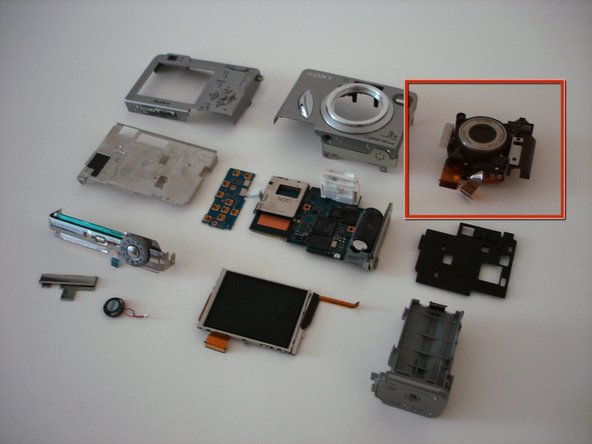

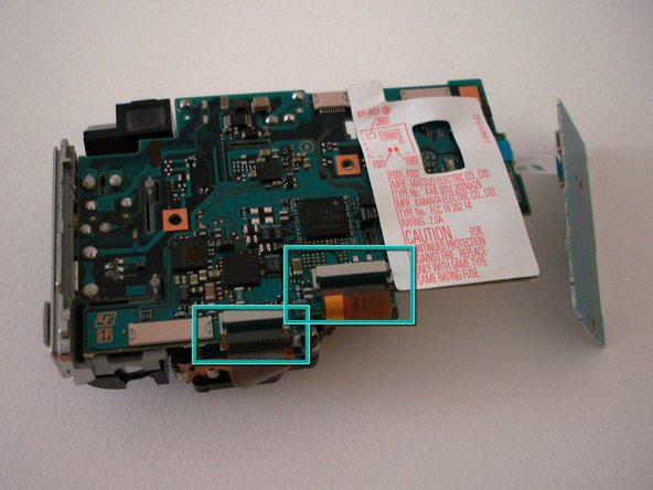

Add Note Edit Step 15 — Lens  ¶

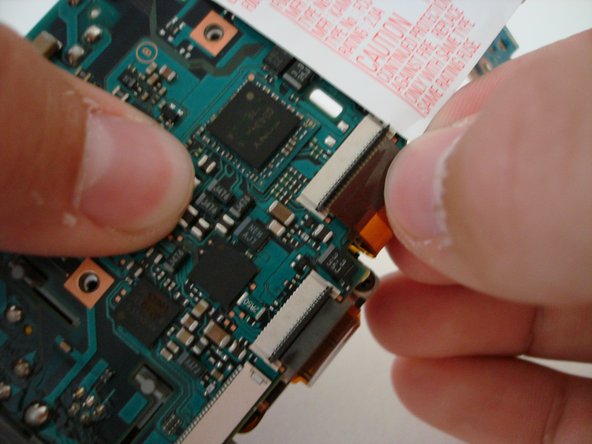

  • Detach two cables that go from the motherboard to the lens.
  • Remove lens.
Image #1

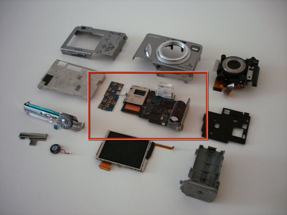

Add Note Edit Step 16 — Motherboard  ¶
  • After the lens is detached, you can replace the motherboard.
