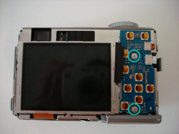

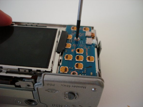

Add Note Edit Step 4 — LCD Screen  ¶
  • Remove the two screws holding the circuit board down.

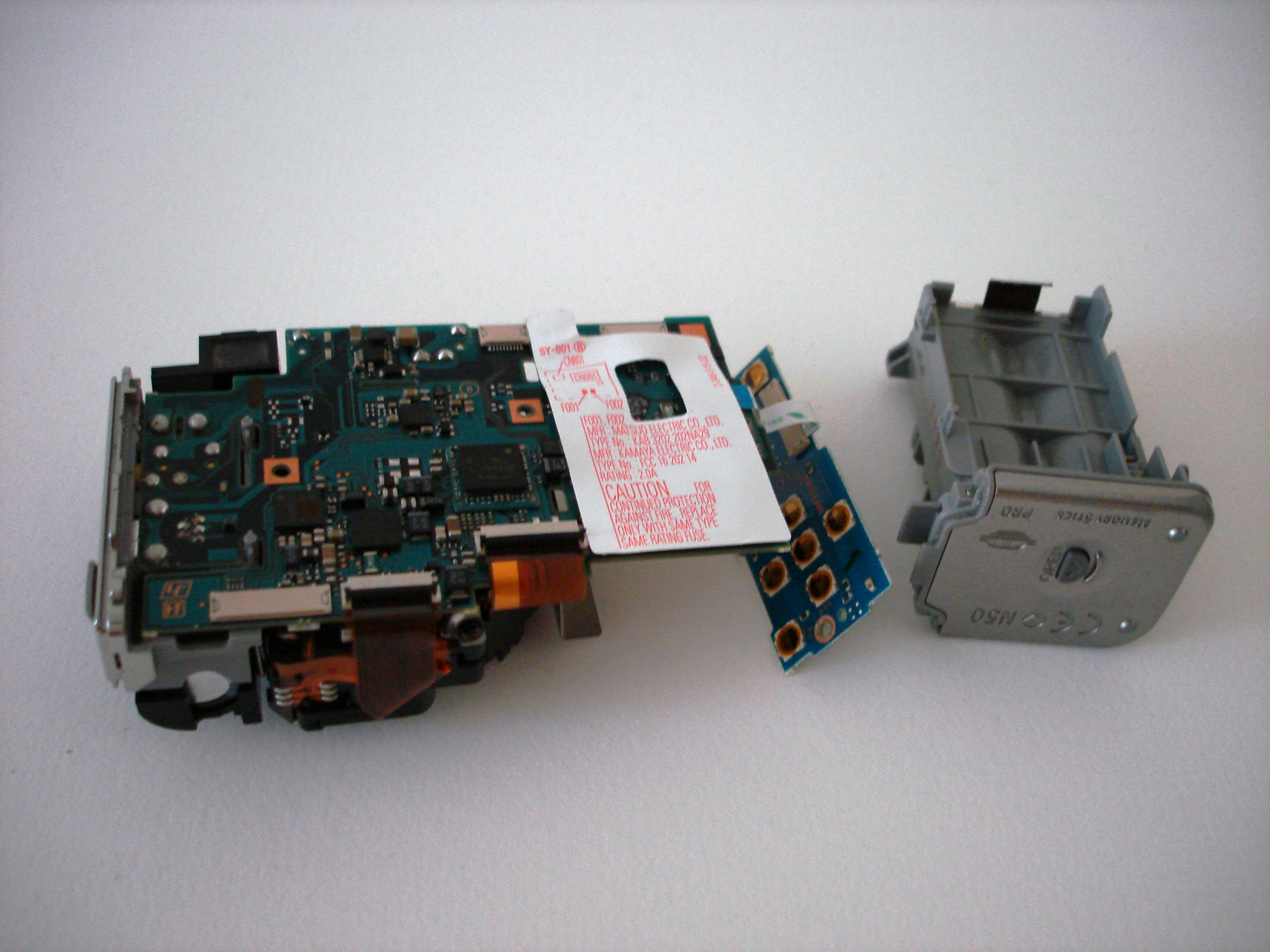

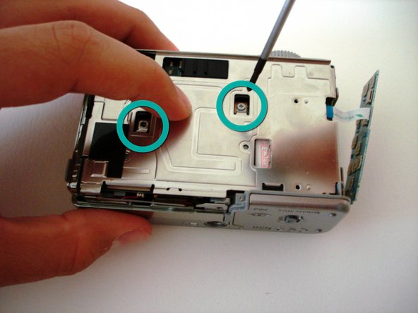

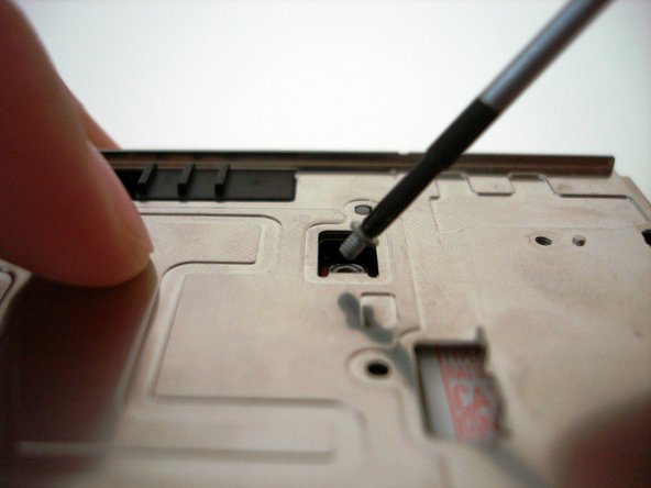

Add Note Edit Step 8 — Speaker  ¶
  • Remove the two screws holding down the steel back plate.
  • Remove steel back plate.
