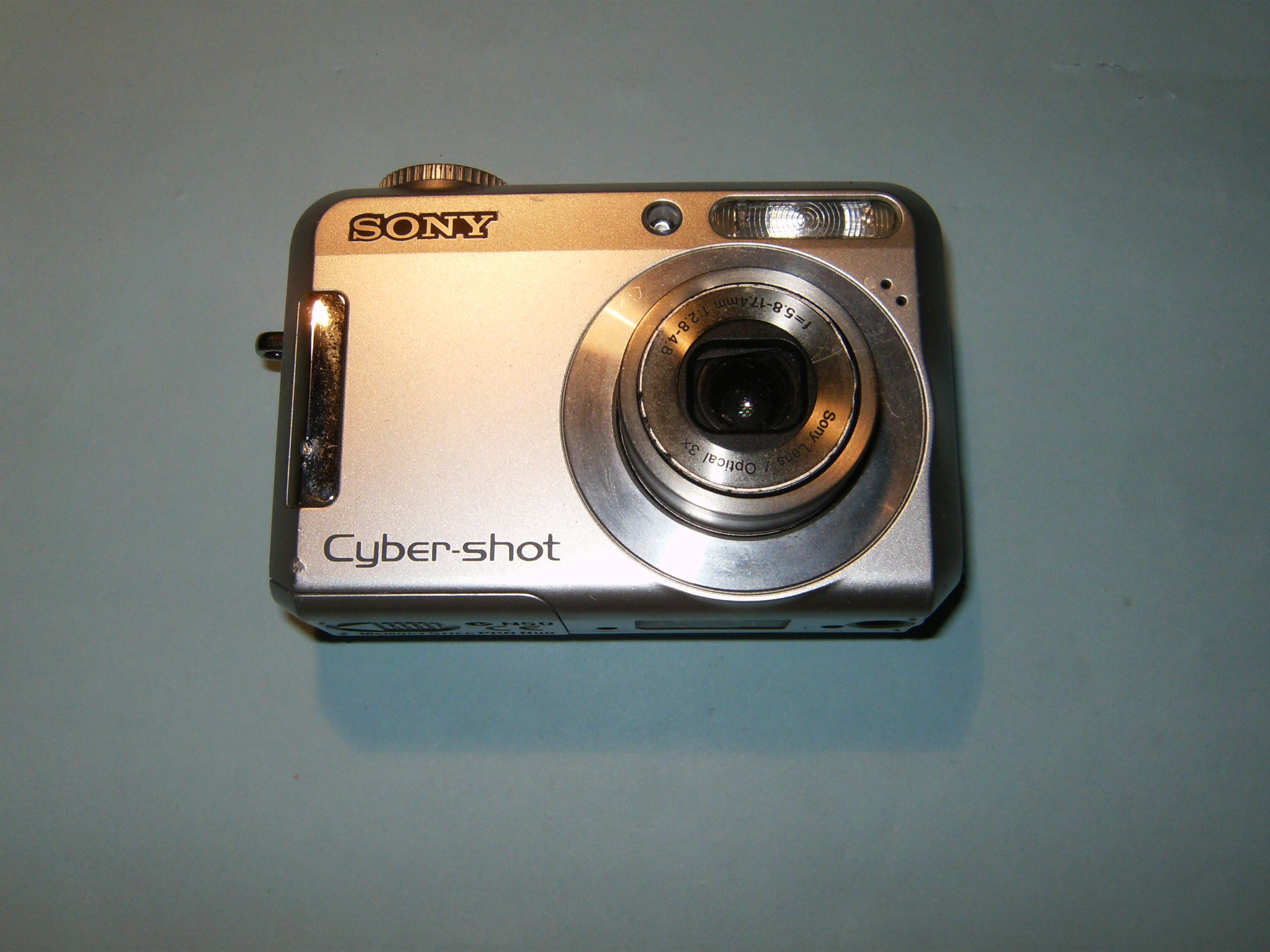

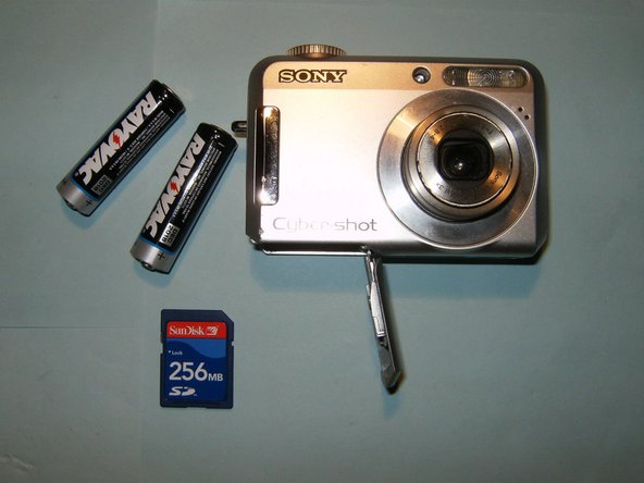

This is a camera that will not turn on. It has a partially stuck lens. (The stuck lens prevents the camera from turning on.)

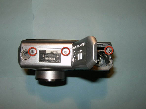

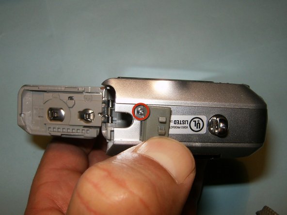

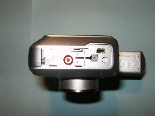

Open the compartment on the bottom of the camera. Remove the batteries and memory card.

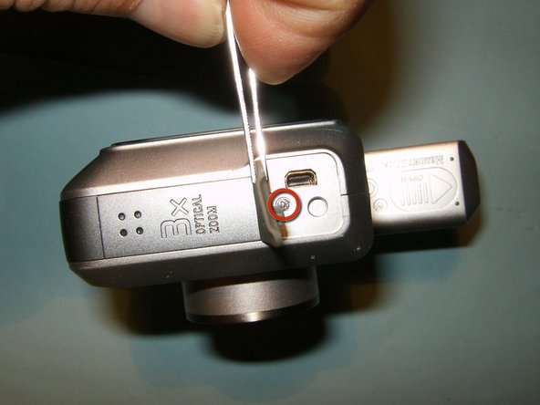

Turn the camera on its side, and remove the screw found under the USB-port cover.
Tool used on this step:Tweezers$4.99

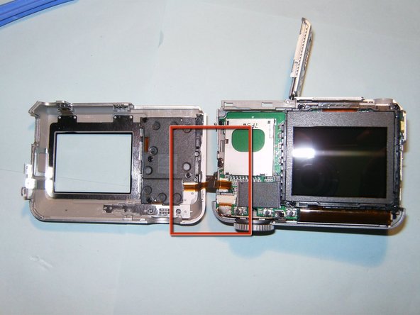

The cable is just pushed into the connector. Use a pair of hemostats or tweezers to pull it straight out. Grab it close to the connector so that the cable wont tear.

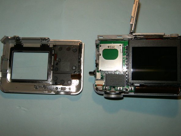

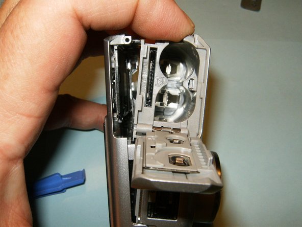

With the cable disconnected, separate the back-case from the camera.

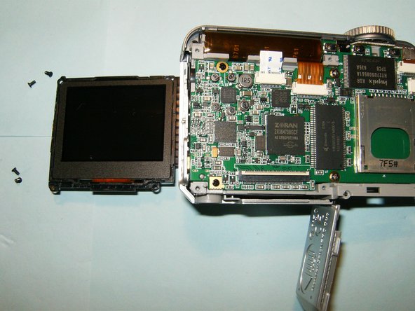

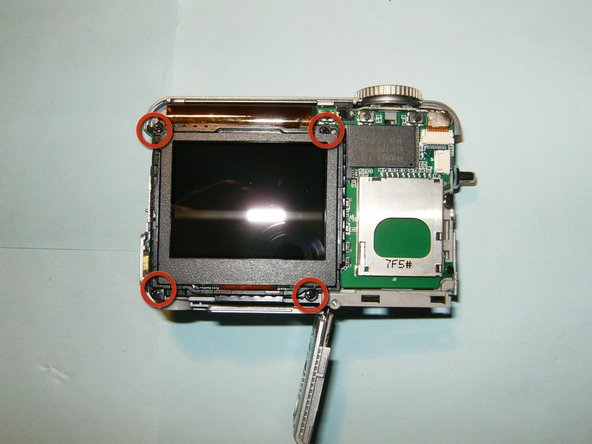

Remove the four screws from the LCD (Liquid-crystal display).
With the four screws removed, the connector for the LCD is easily accessed. Move the white clip in the opposite direction of the cable to open the connector.
Separate the LCD from the camera

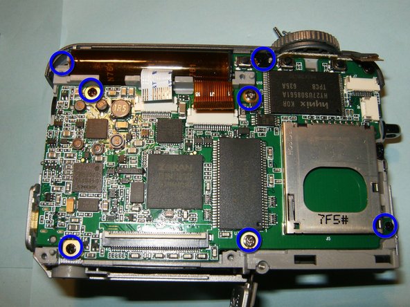

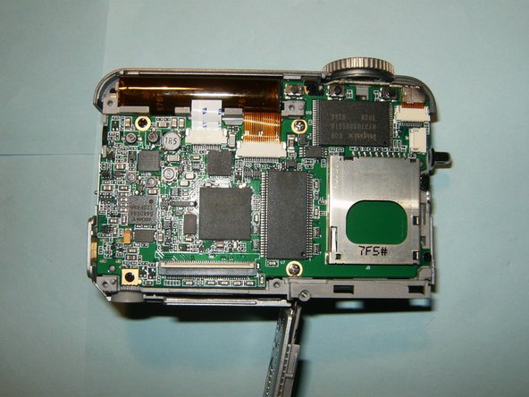

All the cable connectors and screws for the logic board are now fully visible. The cables are all a press fit.
Remove the three ribbon cables. From left to right, the cables are for the flash capacitor, the lens, and the top control buttons.
Remove the screws that hold the logic board, as well as the two long ones that attached the front case.

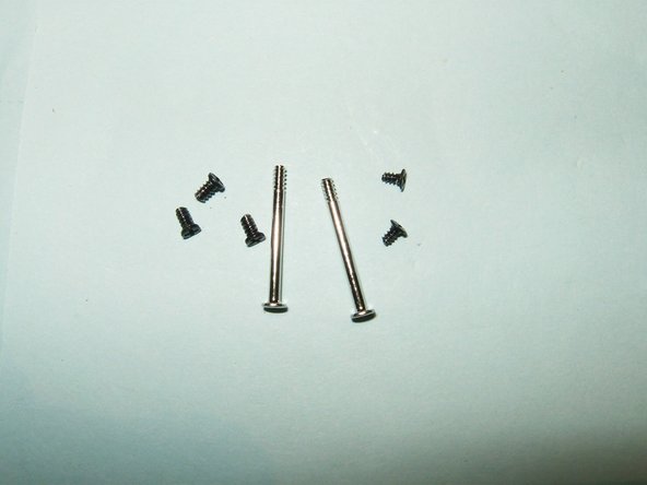

The screws are different sizes. Keep them separate. The two long ones will hold the front case to the camera, and they only fit in the middle of the logic board.

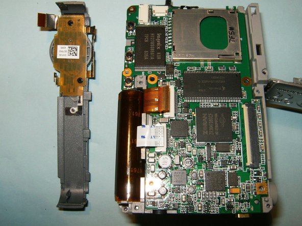

With all the screws removed from the logic board, there is now still the connector from the lens. Simply separate it by bending the cable in a downward direction
The logic board is still connected to the camera via the power cables. Do not try to remove the board. Fold it over instead. If the board needs to be replaced, the two wires would have to be desoldered.
View of the RTC battery
Remove the three screws that hold the lens to the camera.
