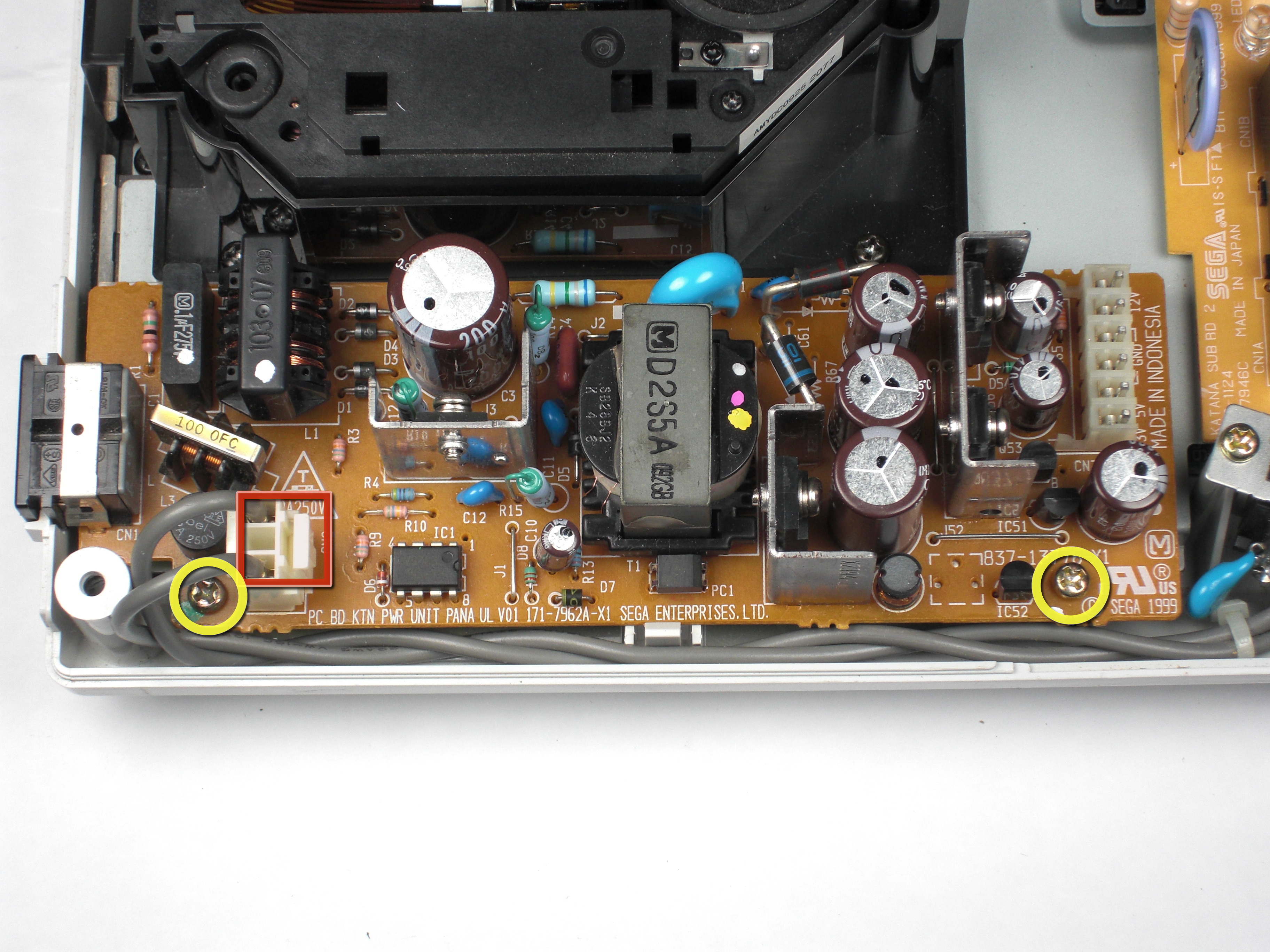

Add Note Edit Step 5 — Power Supply  ¶
  • Unplug the device from the outlet. If you have just powered off the system, allow a few minutes for the capacitors to discharge before you begin working.
  • Remove the white female pin head by pinching and lifting directly up on the harness.
  • Remove the two Philips #02 screws from the board.
  • Remove the power board. Using both hands, gently lift the power board away from the console without damaging the male pin head

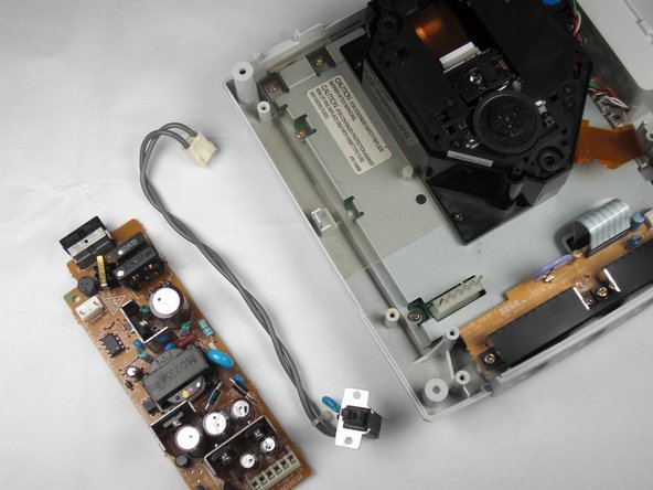

Image #1 Image #2
Add Note Edit Step 6  ¶
  • Remove the unit. Carefully remove the power board from the console by lightly grasping the board by the edge and lifting directly upward.
  • Remove the two 10mm #02 Philips screws to detach the switch module from the console.
  • Purchase a replacement power board.
