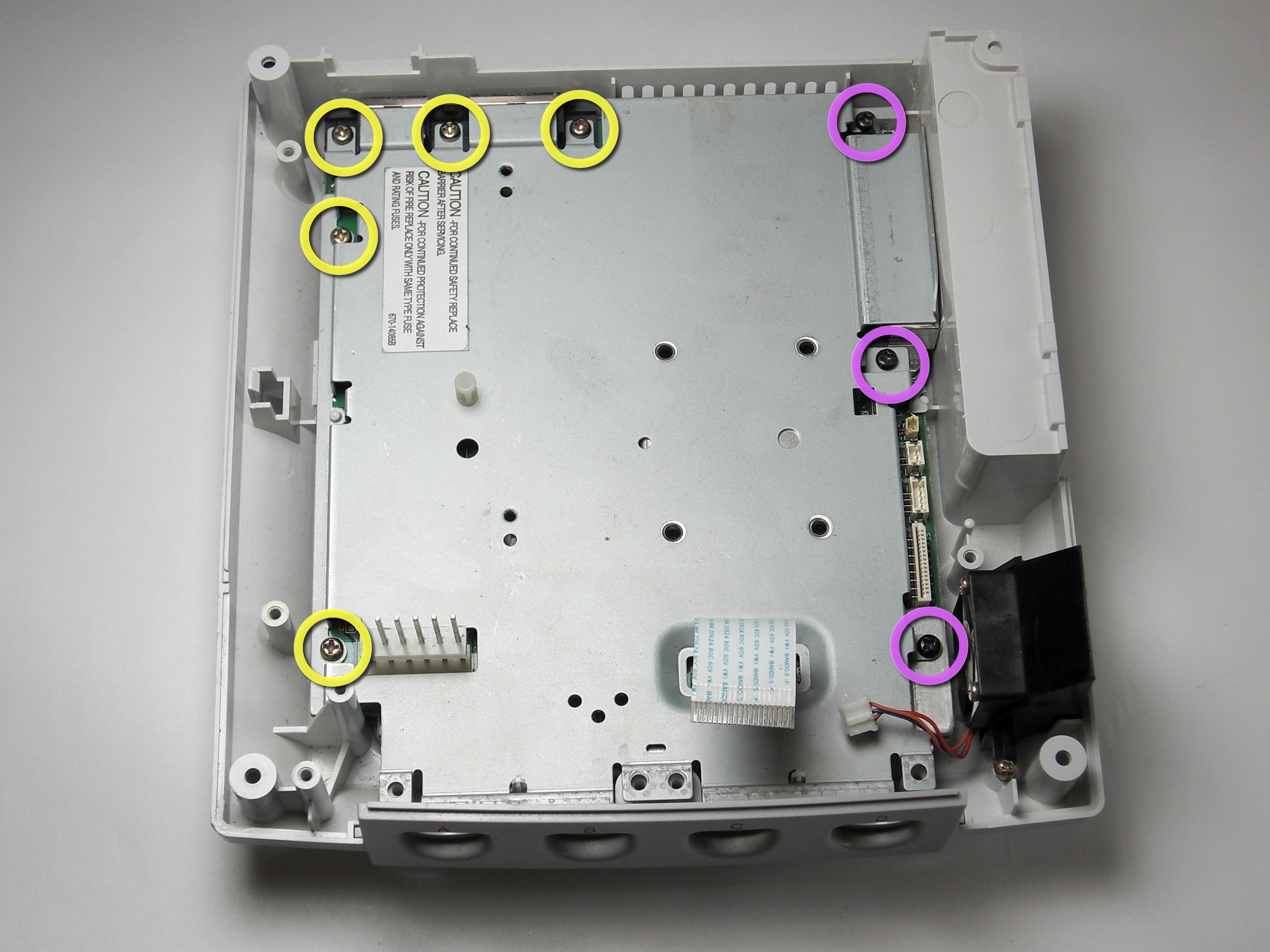

Add Note Edit Step 9 — Controller Port  ¶
  • Be gentle with the white controller cable as it can be a bit fragile.
  • Disconnect the white controller cable by gently pulling the the cable while wiggling it back and forth until it detaches from the controller board.
Image #1 Image #2
Add Note Edit Step 10  ¶
  • Remove the four 14mm Philips #02 located on the controller board.
Image #1 Image #2
Add Note Edit Step 11  ¶
  • Disconnect the white fan header from the controller port
Image #1 Image #2
Add Note Edit Step 12  ¶
  • Remove the controller board by lifting it up from the controller port.

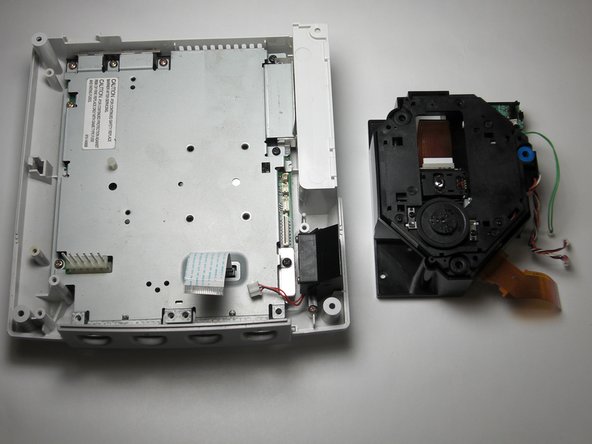

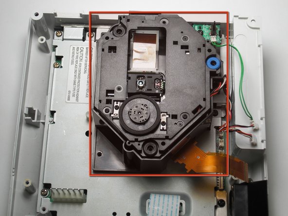

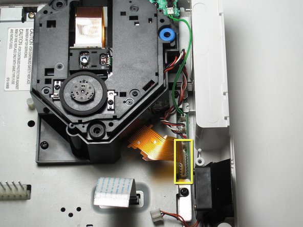

Add Note Edit Step 13 — GD-ROM  ¶
  • Detach the orange cable by giving it a gentle pull while wiggling the cable back and forth until it loosens from the logic board.

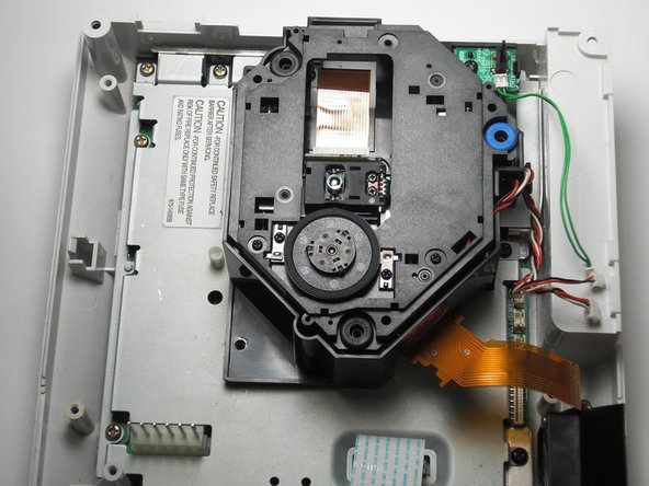

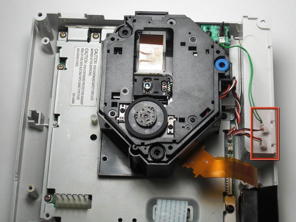

Image #1 Image #2
Add Note Edit Step 14  ¶
  • Detach the cables by gently pulling the three GD-ROM cables to remove them from the logic board.

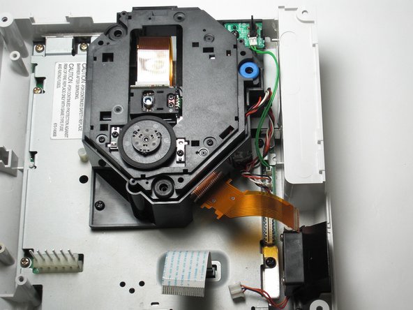

Image #1 Image #2

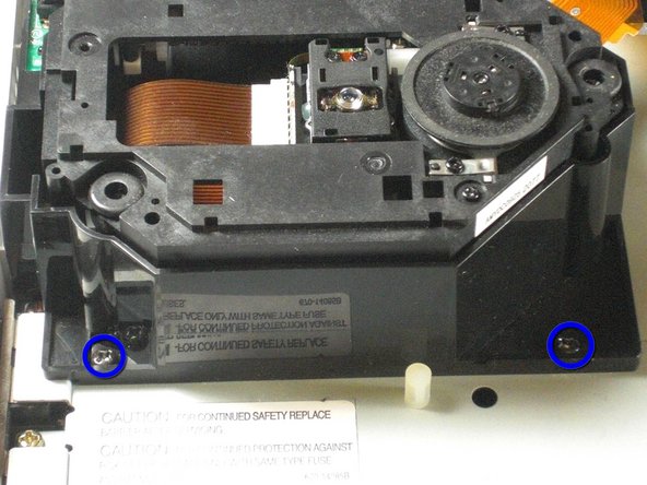

Add Note Edit Step 15  ¶
  • Remove the two black 12mm Philips #02 screws located on the left side of the GD-ROM bracket.
  • The console is rotated 90 degrees counter-clockwise in the first photo. The second photo depicts the normal position.
Image #1 Image #2
Add Note Edit Step 16  ¶
  • When lifting the GD-ROM, be careful that the top half of the casing does not detached from its base.
  • Remove the GD-ROM by gently lifting it from its base.
