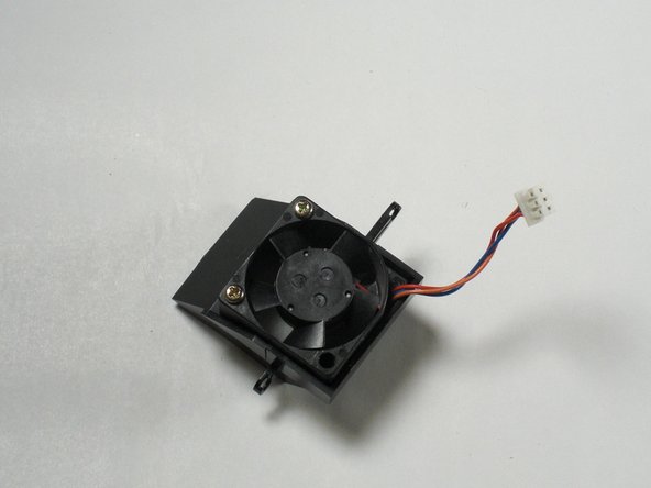

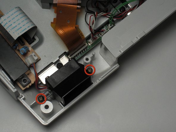

  • Remove the two 8.5mm Philips #00 screws from the fan bracket.
Image #1 Image #2
Add Note Edit Step 7  ¶

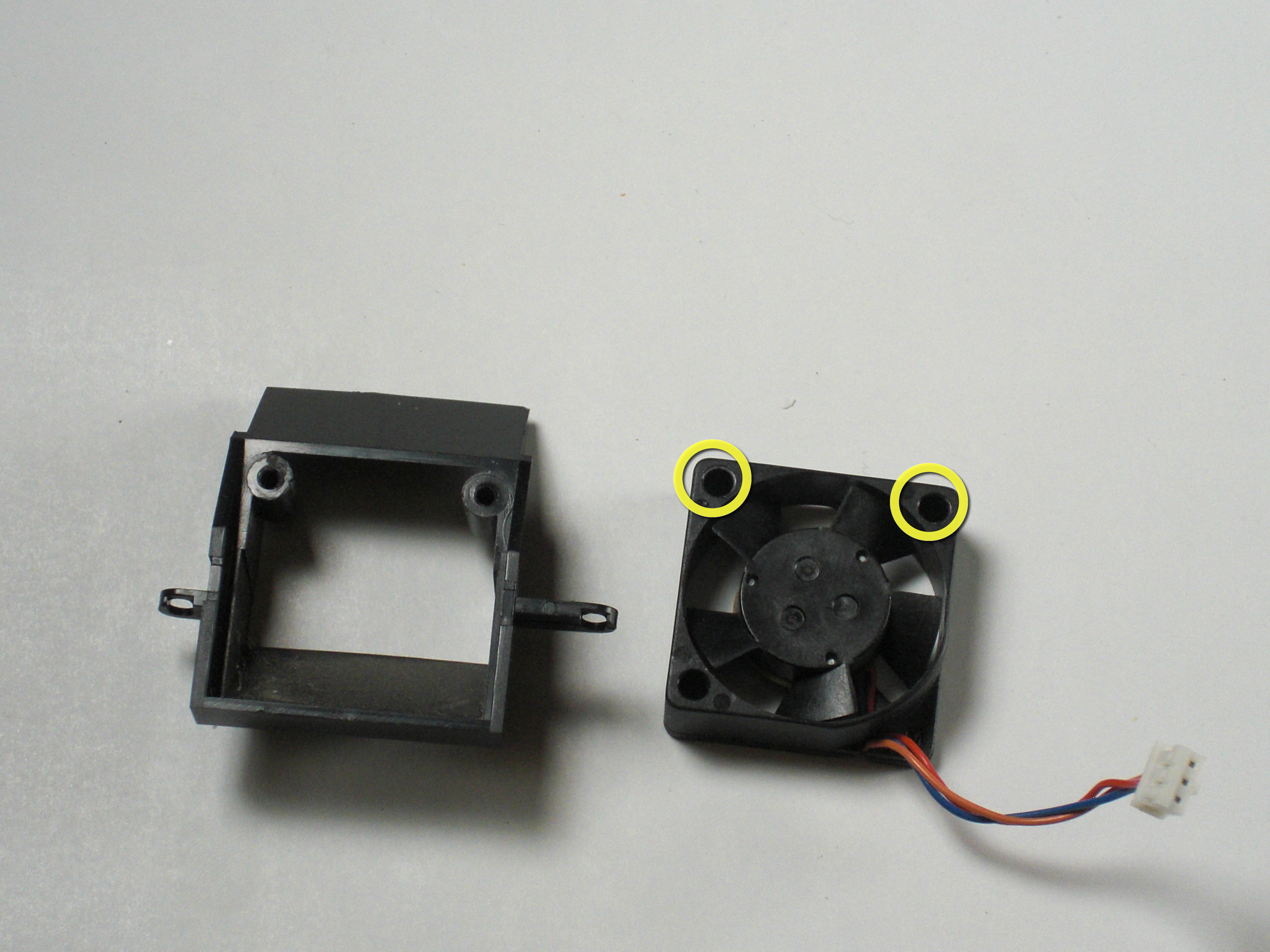

  • Remove the two 17.5mm Philips #00 screws from the fan bracket.
  • Remove the fan from the bracket.
Image #1 Image #2
Add Note Edit Step 8 — Fan  ¶
  • Connect the new fan to the fan bracket using two 17.5mm Philips #00 screws.
  • Replace the fan bracket in the Dreamcast using two 8.5mm Philips #00 screws.
