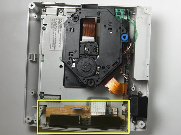

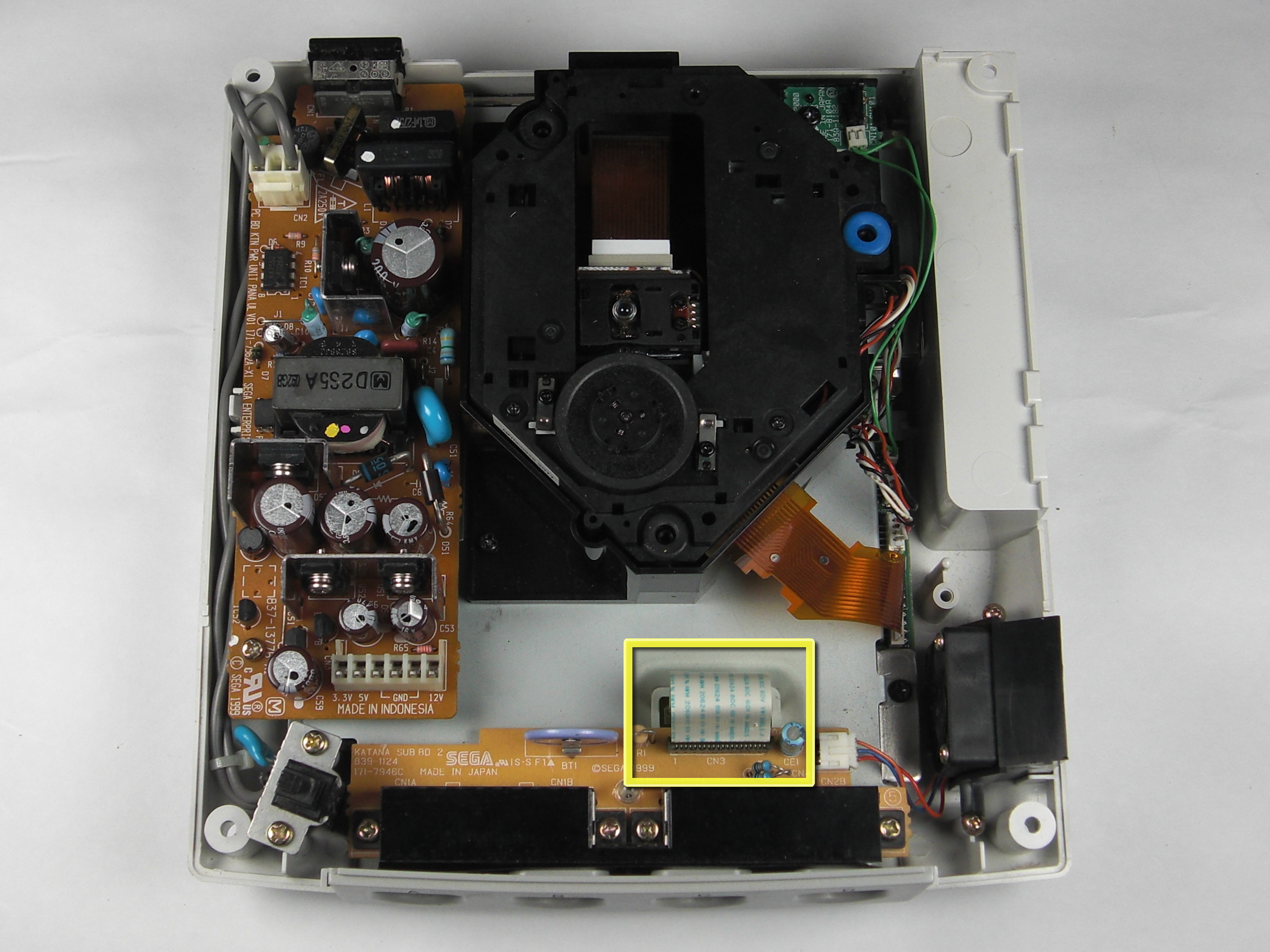

Add Note Edit Step 5 — Controller Port  ¶
  • Be gentle with the white controller cable as it can be a bit fragile.
  • Disconnect the white controller cable by gently pulling the the cable while wiggling it back and forth until it detaches from the controller board.
Image #1 Image #2

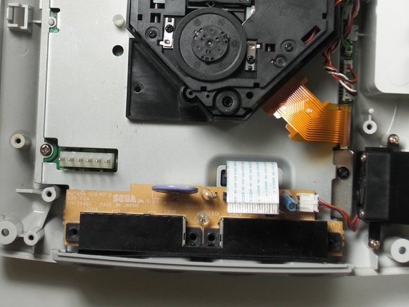

Add Note Edit Step 6  ¶
  • Remove the four 14mm Philips #02 located on the controller board.
Image #1 Image #2

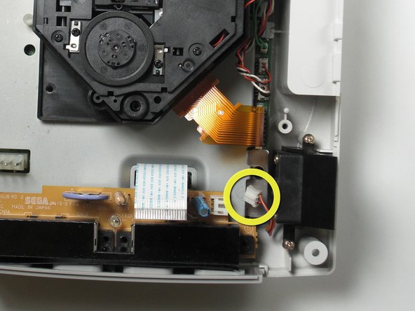

Add Note Edit Step 7  ¶
  • Disconnect the white fan header from the controller port
Image #1 Image #2

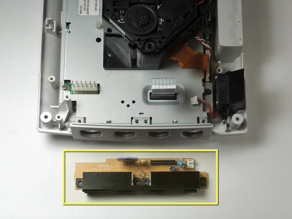

Add Note Edit Step 8  ¶
  • Remove the controller board by lifting it up from the controller port.
