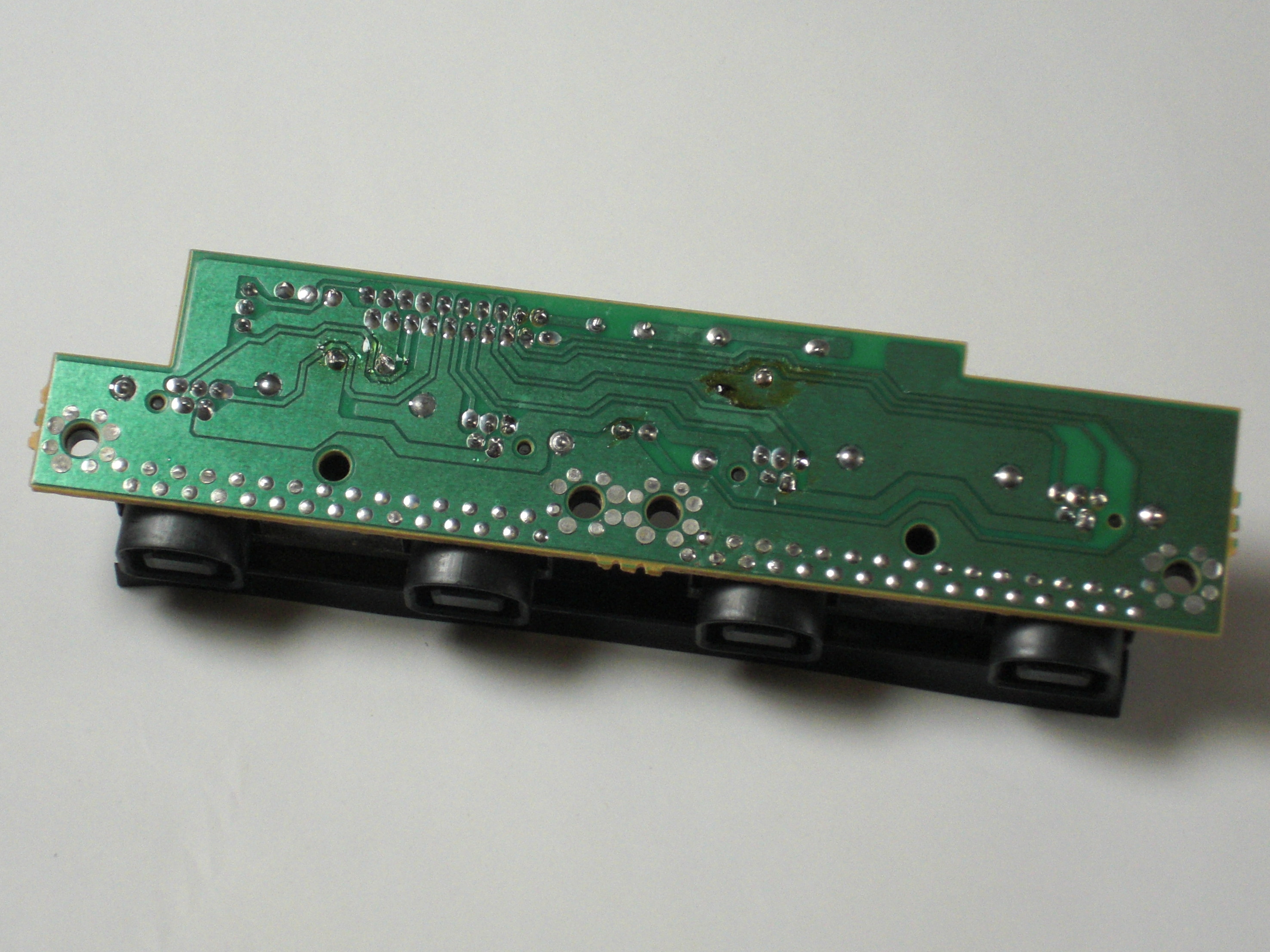

Replacing the F1 fuse on the controller board of the Sega Dreamcast. Soldering is required for repair.
Required parts
  • 5 Ohm 1/2 watt fuse resistor OR two 10 Ohm 1/4 watt metalized resistors
  • Controller board
Image #1 Image #2

Add Note Edit Step 6  ¶
  • Remove the four 14mm Philips #02 located on the controller board.
Image #1 Image #2
Add Note Edit Step 7  ¶
  • Disconnect the white fan header from the controller port
Image #1 Image #2
Add Note Edit Step 8  ¶
  • Remove the controller board by lifting it up from the controller port.
Next » « Previous
