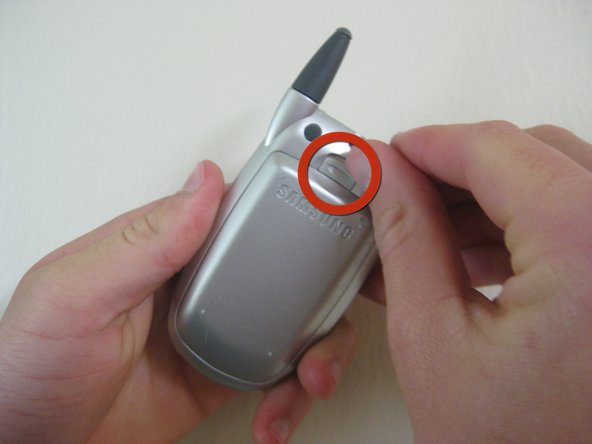

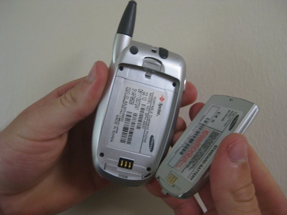

  • Turn phone over
  • Push the gray tab above the battery forward to remove the battery.
Image #1

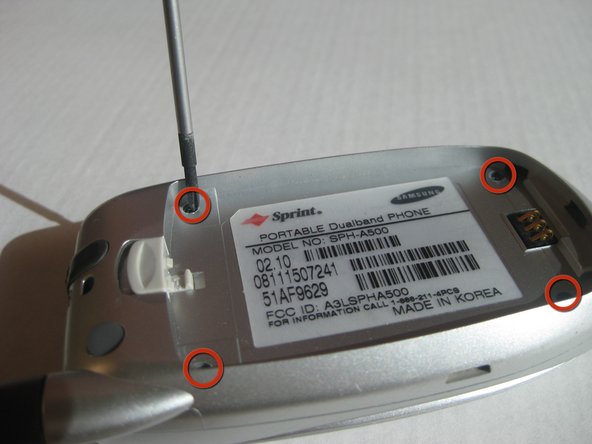

Add Note Edit Step 2  ¶
  • Remove the battery from the phone, which will reveal four screws at the corners of the phone.
Image #1
Add Note Edit Step 3  ¶
  • Remove all four screws using a small Philips screwdriver.
  • Note: The screws do not need to be completely removed from the case, as long as they are unscrewed.

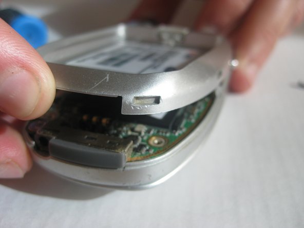

Add Note Edit Step 4  ¶
  • Remove back cover by carefully prying it open.
  • Note: Some force may be required.

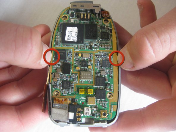

Add Note Edit Step 5  ¶
  • Pull the side tabs outward while simultaneously lifting up the circuit board.
  • Do not completely pull out the circuit board.

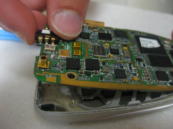

Add Note Edit Step 6  ¶

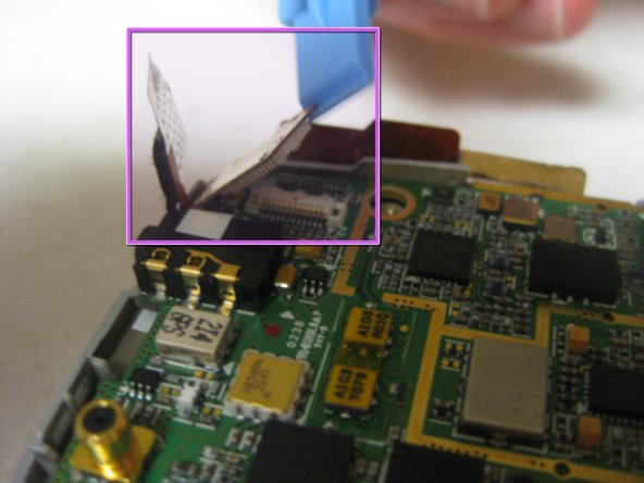

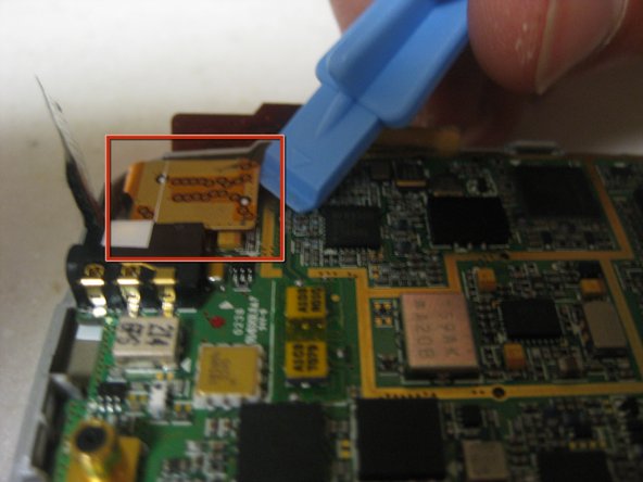

  • Look for the clip at the top right corner of the logic board.
Image #1

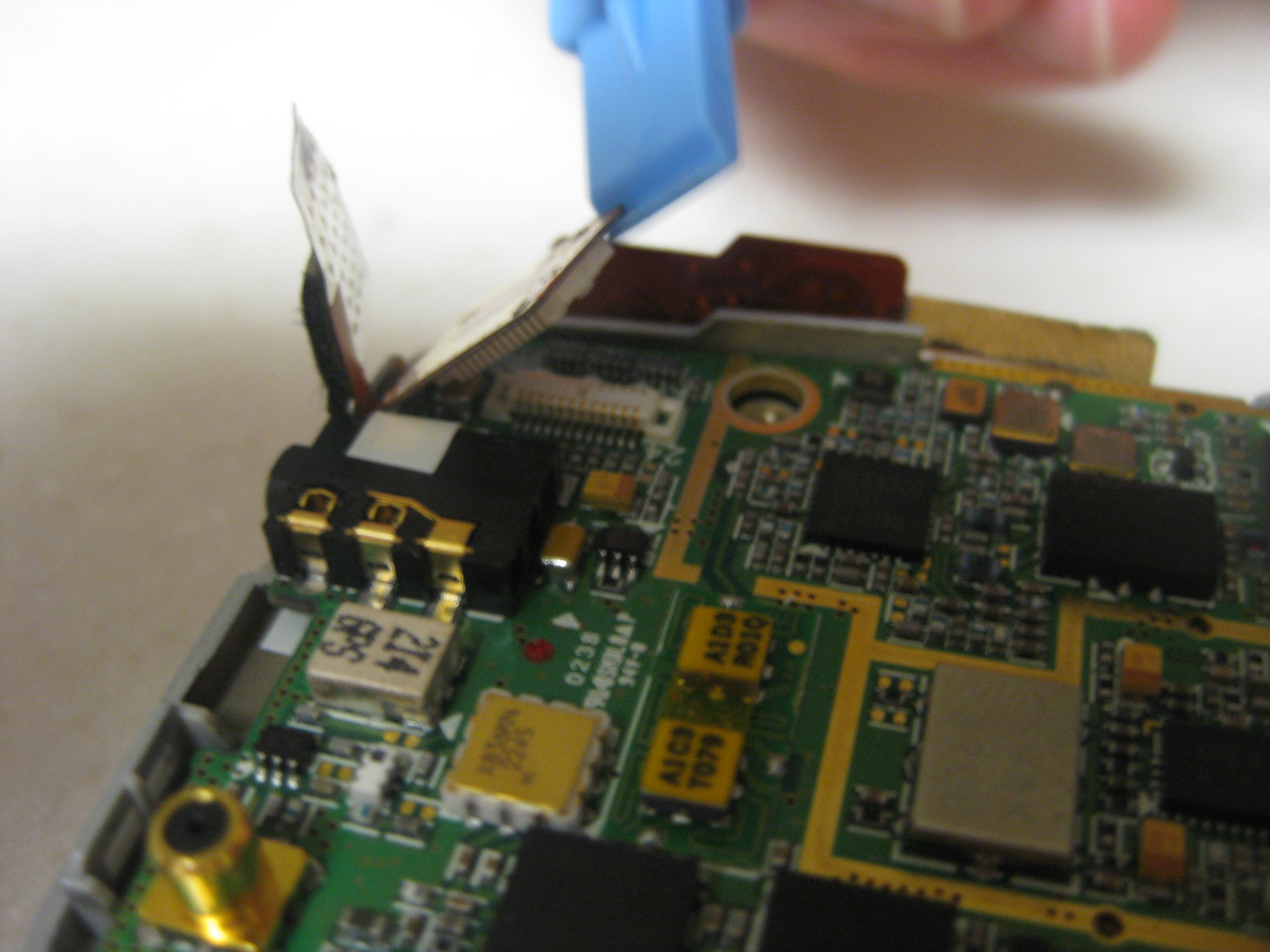

Add Note Edit Step 7  ¶
  • Remove the clip from the logic board.
Image #1
Add Note Edit Step 8  ¶
  • Remove the logic board.
  • Replace the broken logic board with a new one.
