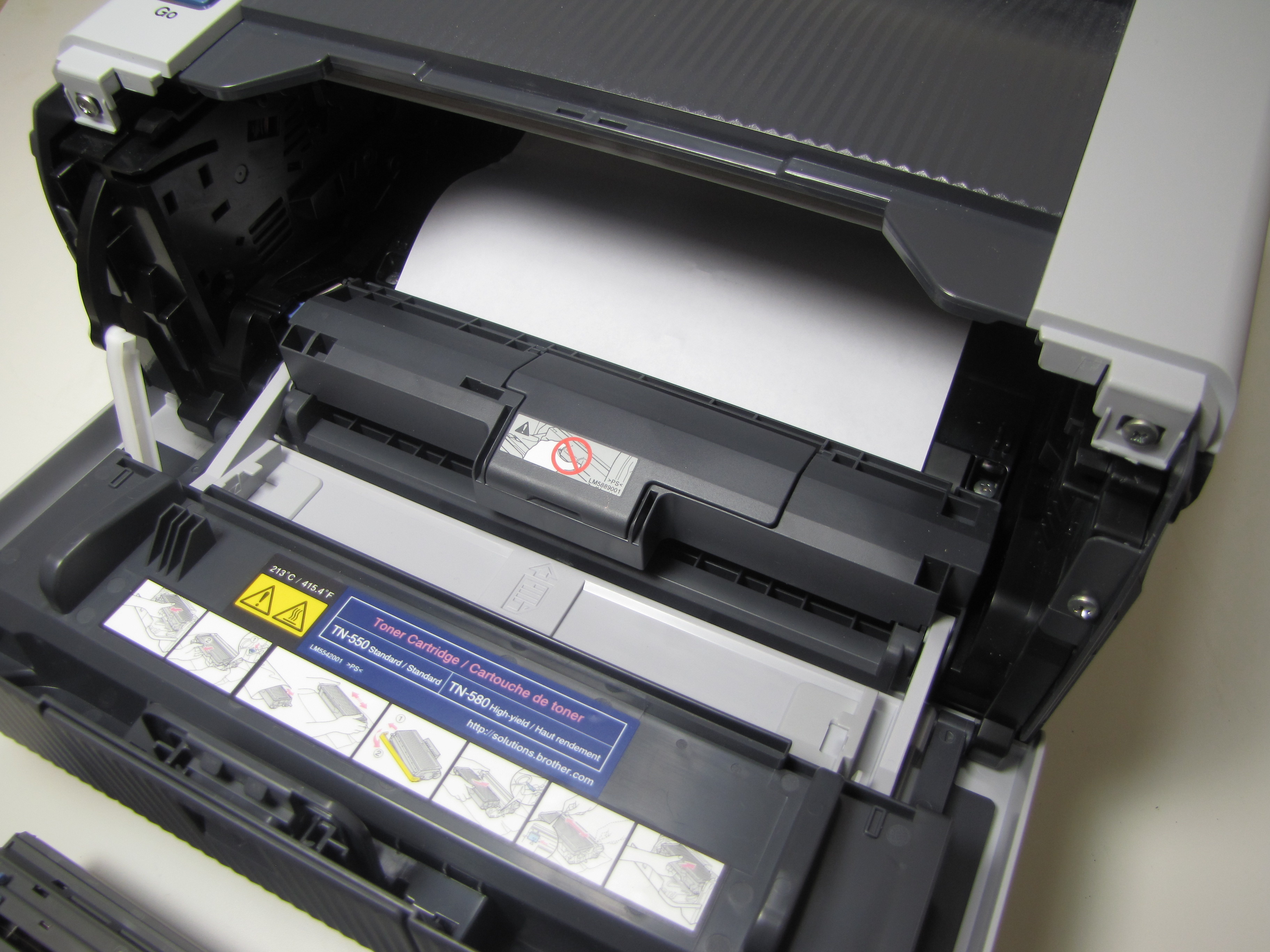

Add Note Edit Step 4 — Paper Jam Type 1  ¶
  • If jammed, paper will be visible after removing the drum unit. To clear paper jam, reach into printer and grab a corner of the paper.
  • Proceed to lift paper up and out of the printer.
  • Jammed paper may require an excess amount of force to be removed from printer.

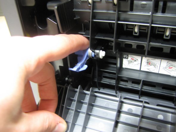

Add Note Edit Step 7 — Paper Jam Type 3  ¶
  • Located on the back of the printer, open up the cover by grabbing onto the tab and pulling down.
Image #1 Image #2 Image #3

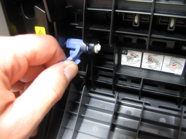

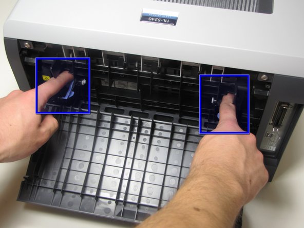

Add Note Edit Step 8  ¶
  • In front of you will see two blue tabs, one on the left and right side.
  • First, push the top part of the tab in until the bottom part of the tab lifts up.
  • Grab onto the bottom part of the tab.
