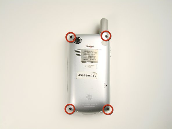

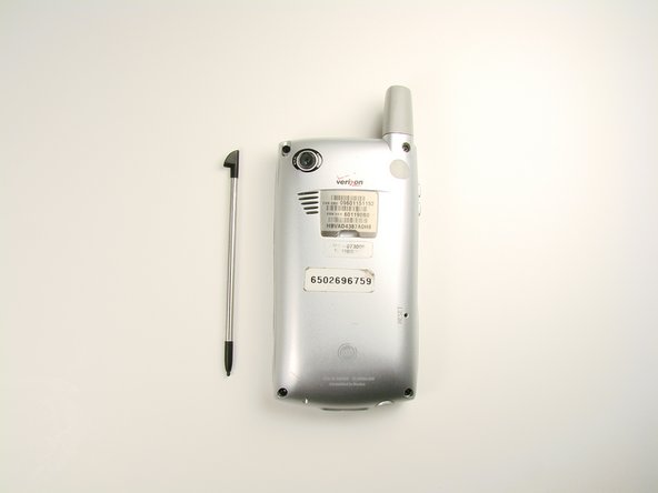

  • On the back of the device, locate the 3 rubber plugs, and use a plastic spudger to remove them.
Image #1 Image #2

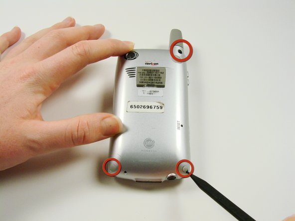

Add Note Edit Step 2  ¶
  • Use the T6 Torx Screwdriver to remove all 4 screws.
  • You have to first remove the Stylus to access the 4th screw.

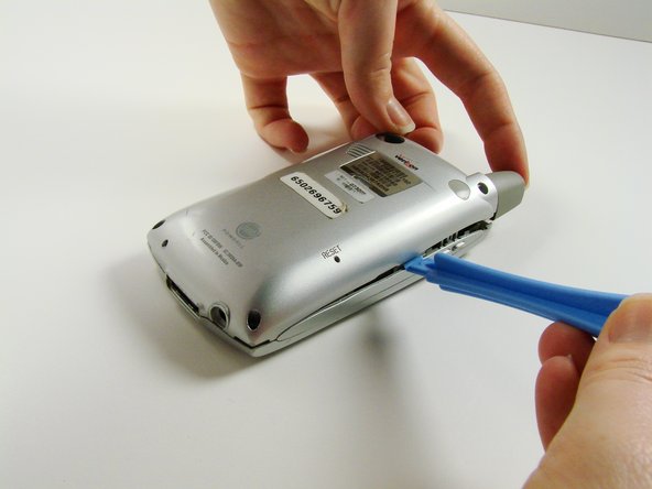

Add Note Edit Step 3  ¶
  • Using a plastic opening tool, carefully separate the front and back cases.
  • Note: The antenna will detach from the phone.

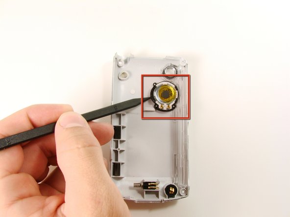

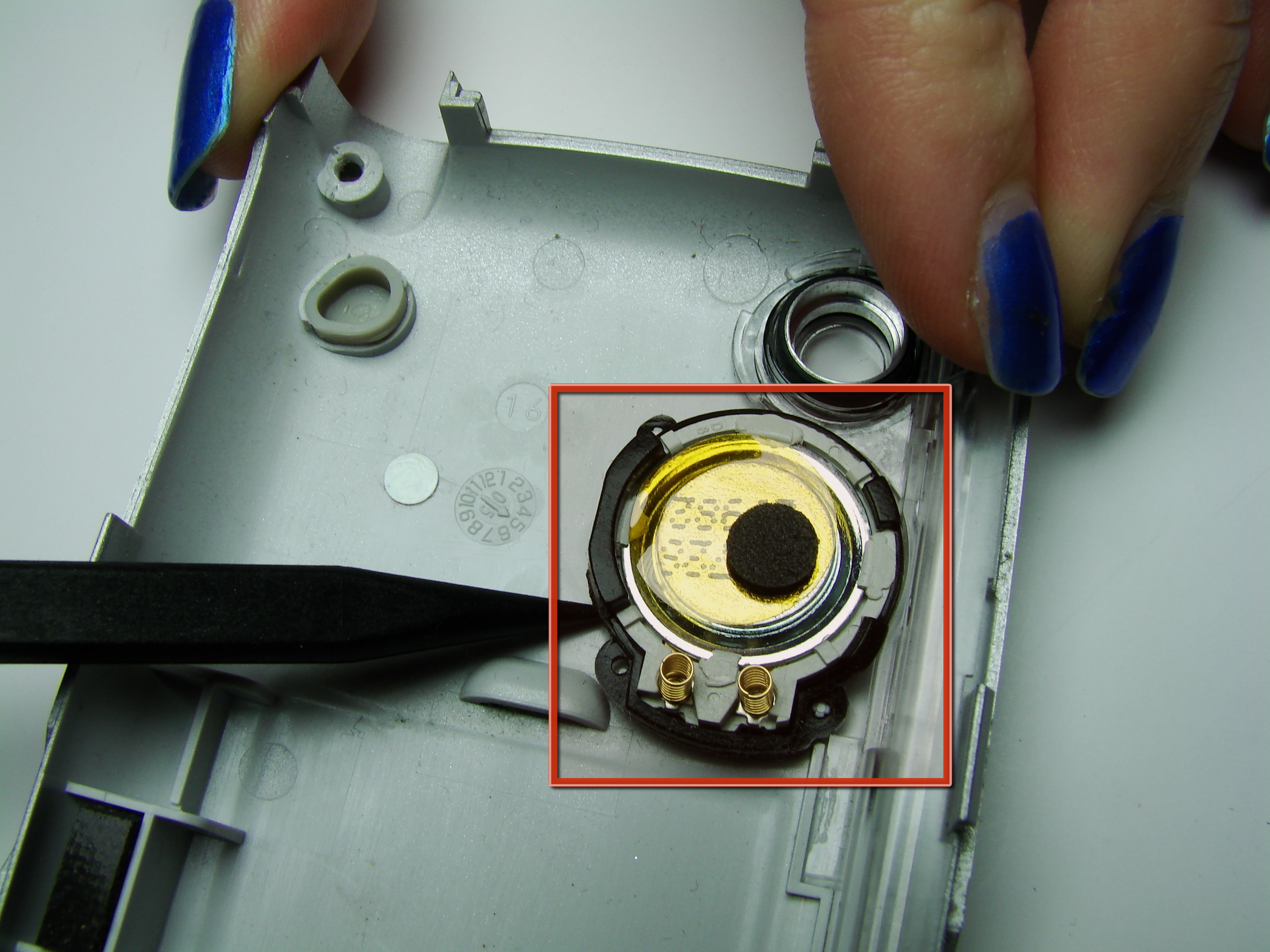

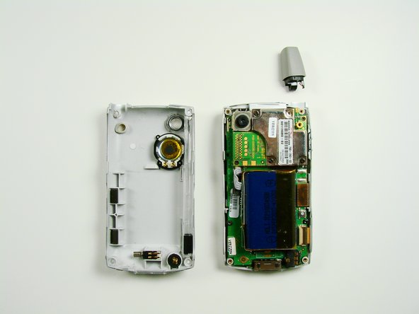

Add Note Edit Step 4 — Speaker  ¶
  • Using the spudger, pull the speaker straight up.
Image #1

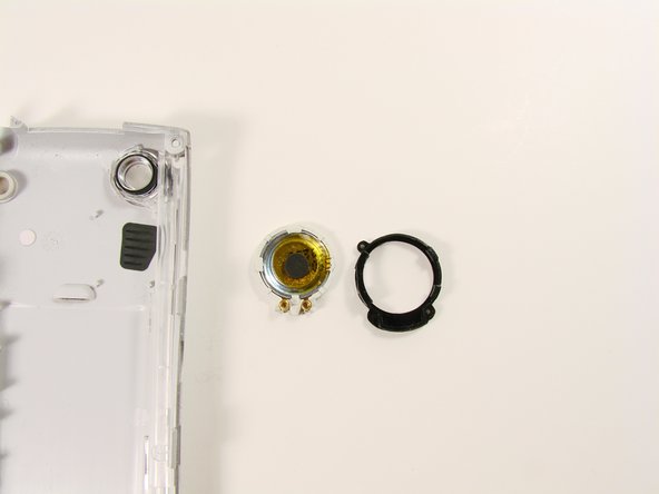

Add Note Edit Step 5  ¶
  • Gently pull the rubber coating off of the speaker.
