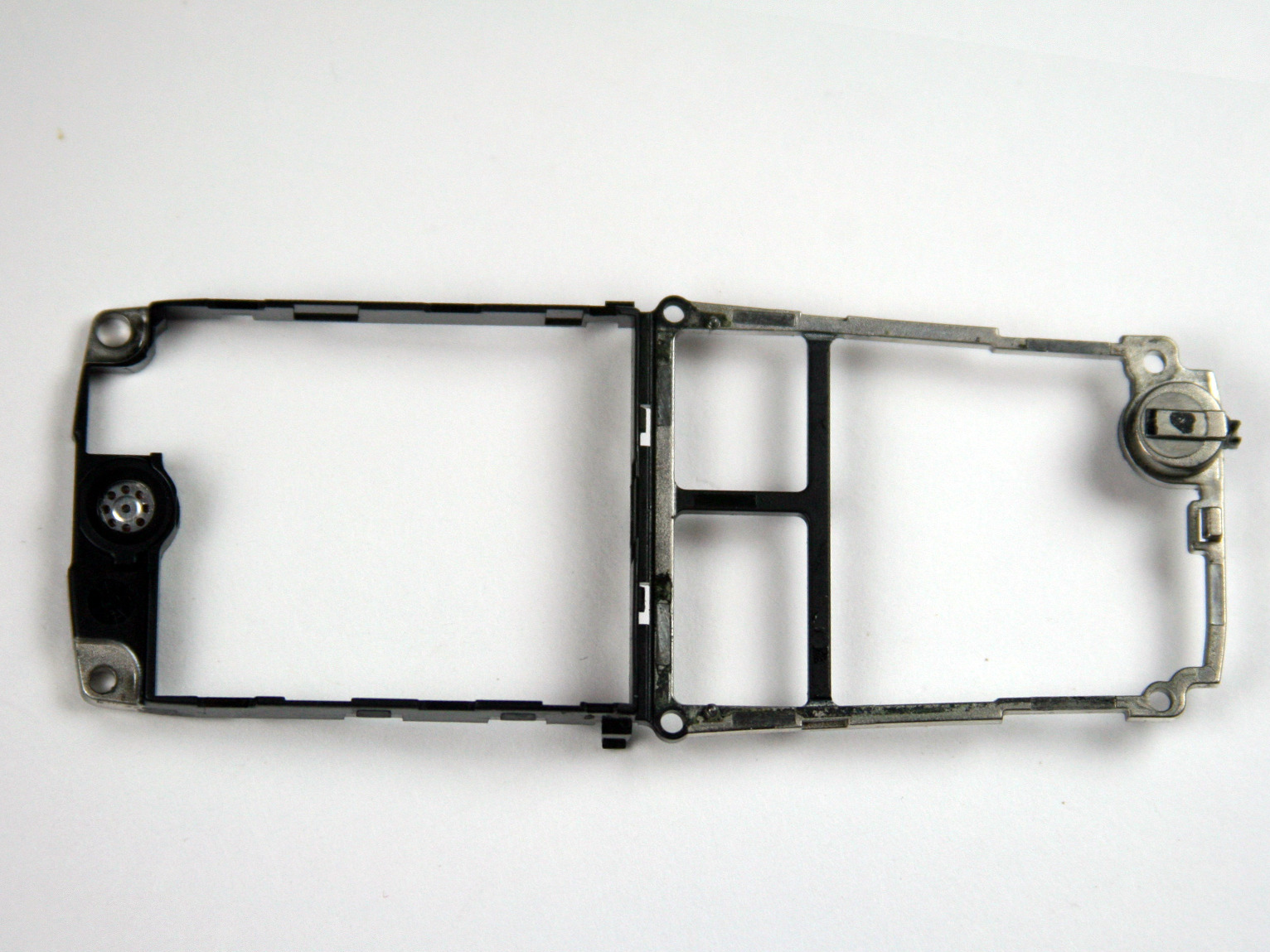

Image #1
Add Note Edit Step 7  ¶
  • Lift the keyboard out of the plastic frame.
Image #1 Image #2
Add Note Edit Step 8 — Display  ¶
  • Use the plastic opening tool to unmount the thin metal frame at the tab connections. You must do this on both sides.
  • Lift the thin metal frame off of the plastic frame.
  • Pay attention while lifting the frame off because it can easily be bent.
