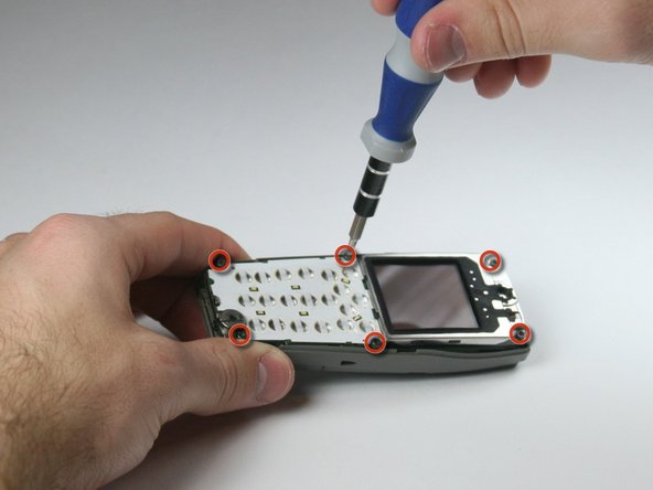

  • Remove six Torx 6 screws with the screwdriver.

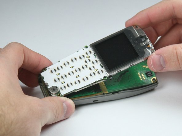

  • Remove the frame that holds the keyboard and the display.

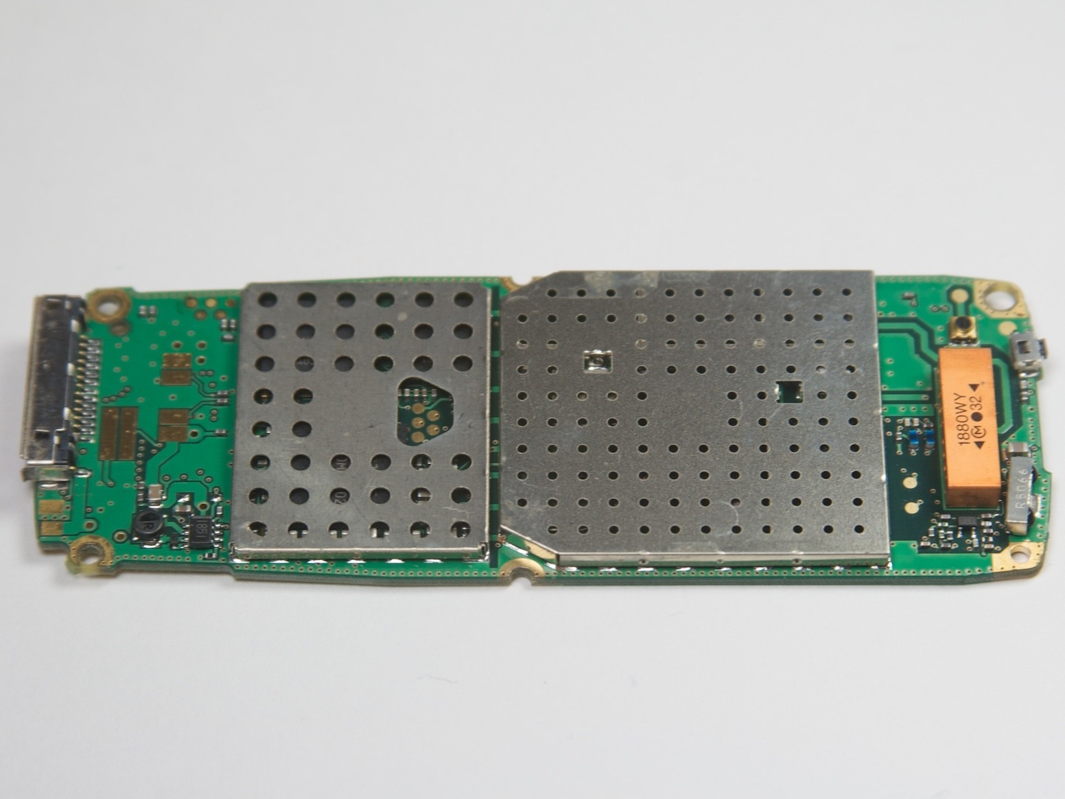

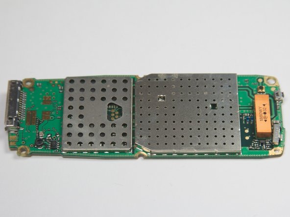

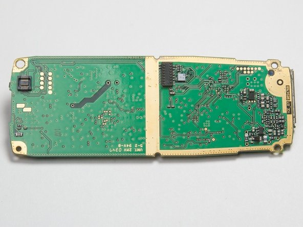

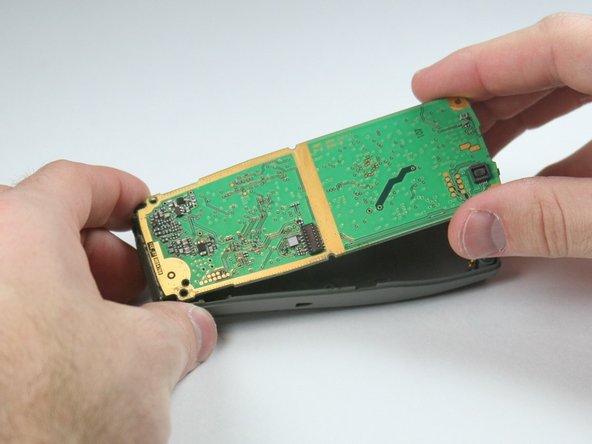

  • Lift the logic board of out the rear case of the phone.
Image #1 Image #2
Add Note Edit Step 8  ¶
  • This is the logic board of your cell phone.
  • Make sure that you get the right logic board to replace your old one by comparing the serial numbers on it.
