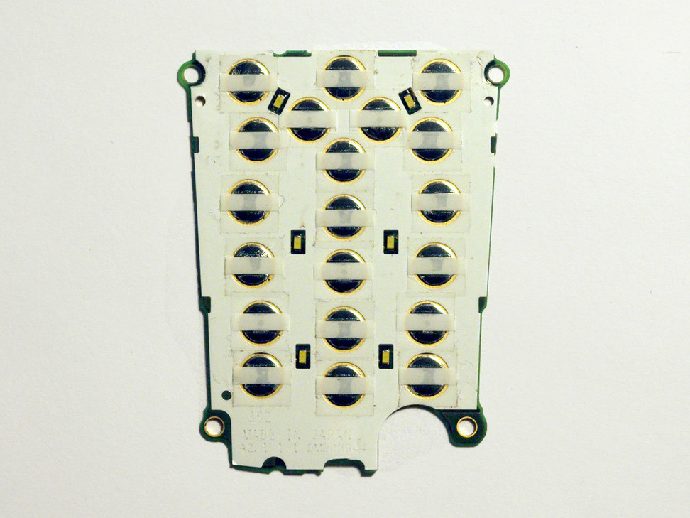

Add Note Edit Step 5 — Keyboard  ¶
  • Unscrew the six T6 torx screws which attach the frame to the cell phone case.
  • Be careful not to scratch your display with the screw driver.
Image #1
Add Note Edit Step 6  ¶
  • Lift the frame off of your cell phone.
Image #1
Add Note Edit Step 7  ¶
  • Lift the keyboard out of the plastic frame.
