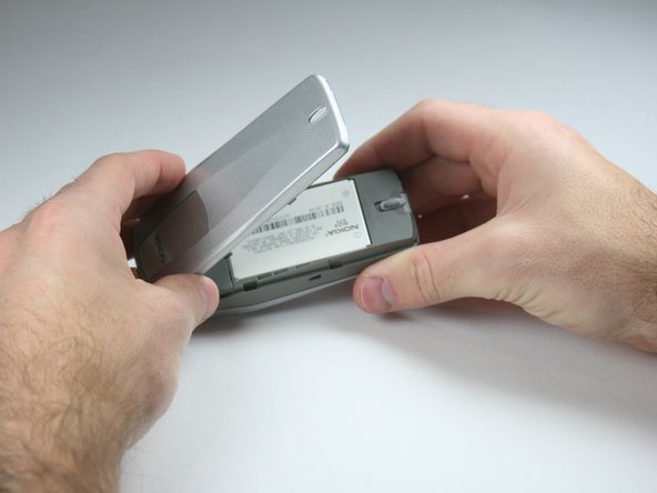

  • Remove the back cover of your cell phone by pushing the small slider with your fingernail towards the top of the phone.
  • Lift off your cell phone's back cover.

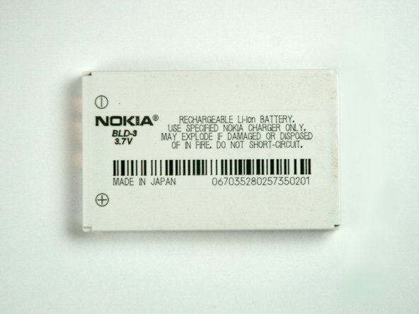

  • Use your index finger to first push down and then lift up the battery as shown.
  • Remove the battery from your cell phone.

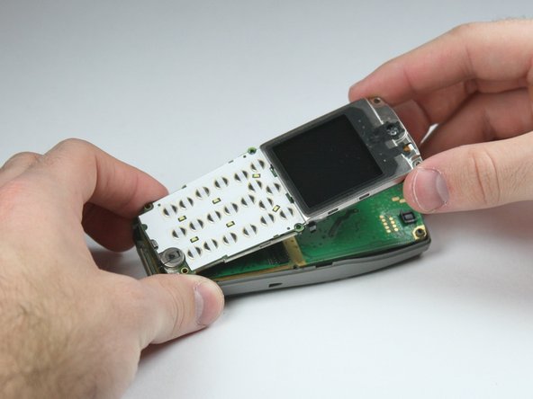

  • Open the front cover of your cell phone with the plastic opening tool or finger nail.
  • Lift the cover upwards, starting from the bottom below the keypad.

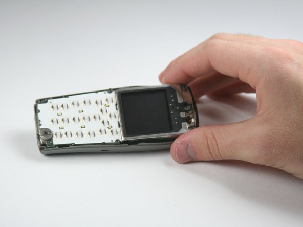

  • Lift the frame off of your cell phone.

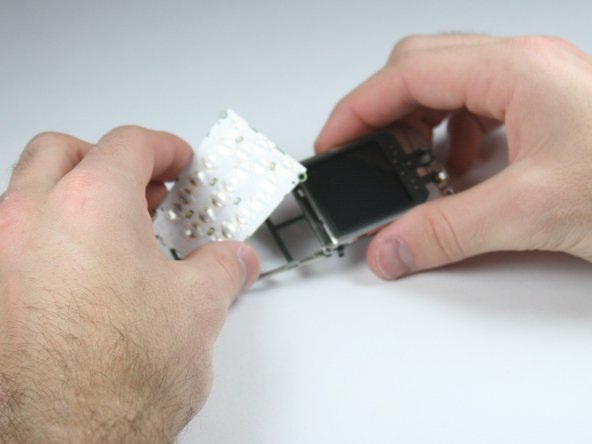

Add Note Edit Step 7  ¶
  • Lift the keyboard out of the plastic frame.
Image #1 Image #2
Add Note Edit Step 8 — Display  ¶

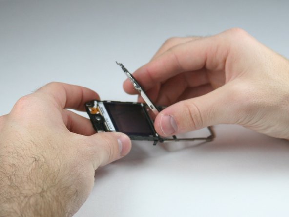

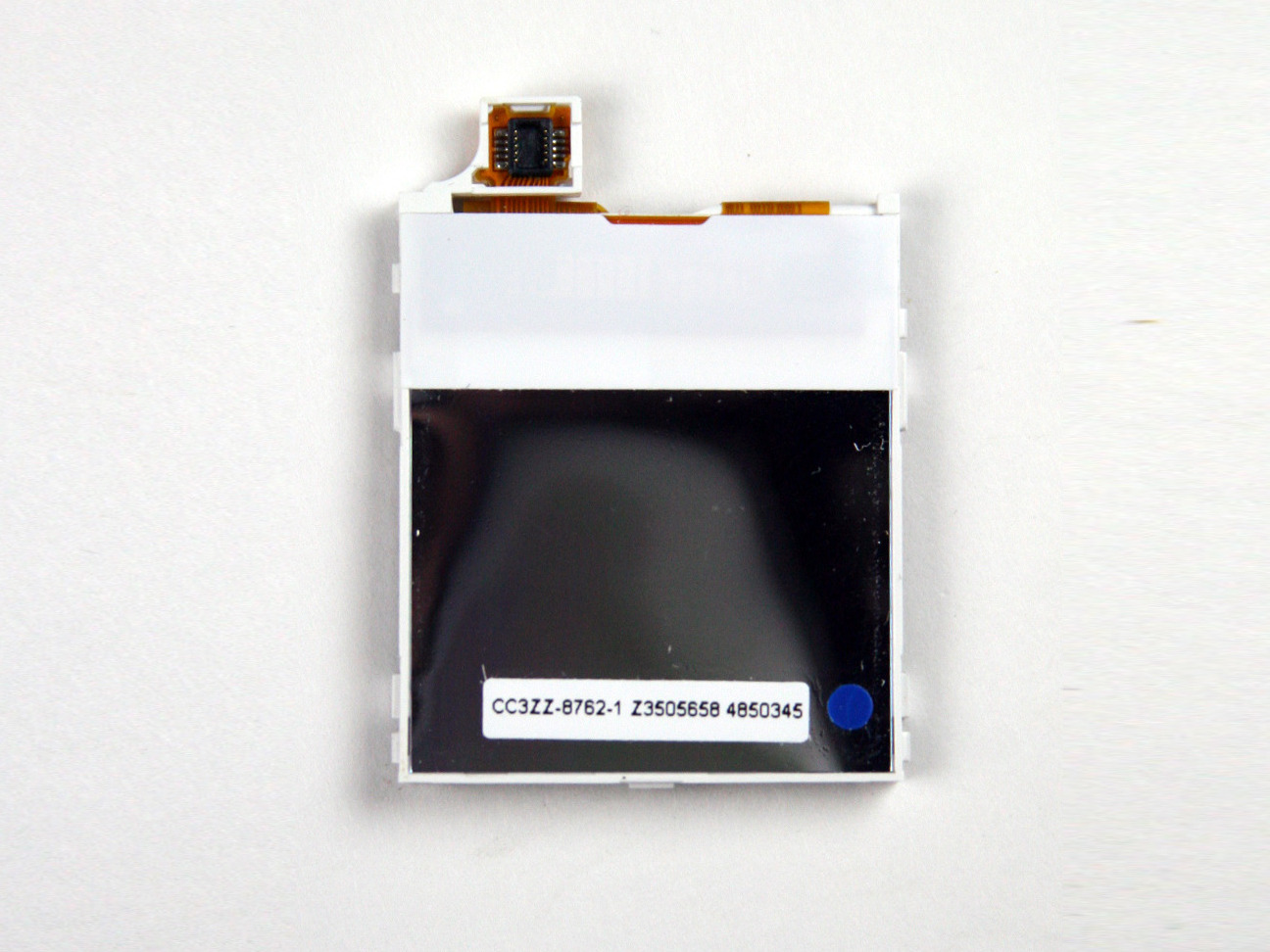

  • Use the plastic opening tool to unmount the thin metal frame at the tab connections. You must do this on both sides.
  • Lift the thin metal frame off of the plastic frame.
  • Pay attention while lifting the frame off because it can easily be bent.
