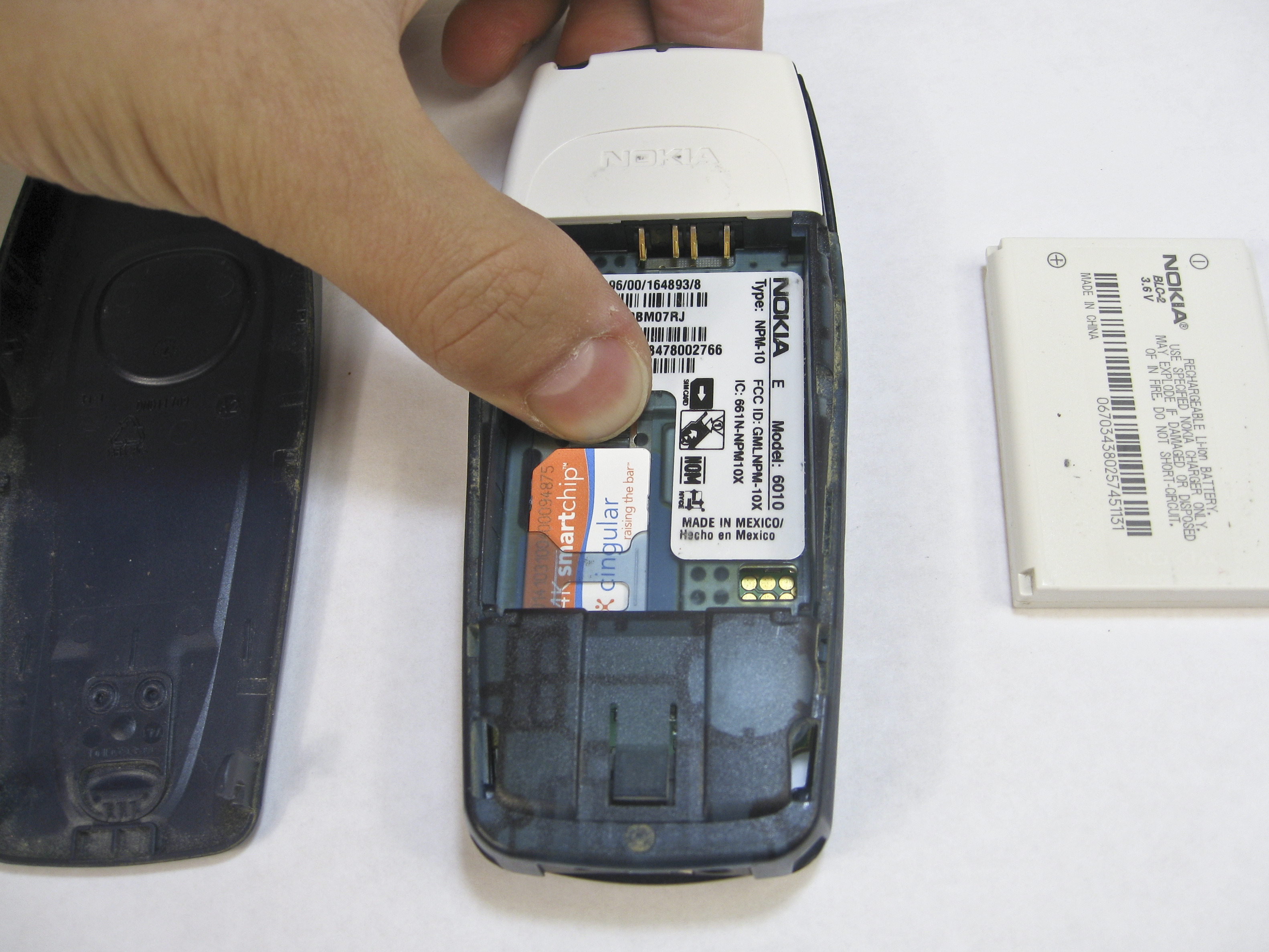

  • Press the small tab on the bottom of the back of the phone.
  • Push the back case upward towards the power button. The back case will then pop off.
    • It requires some force, so be careful.
Image #1 Image #2
Add Note Edit Step 2  ¶
  • Lift the battery near the bottom and pry up.
Image #1
Add Note Edit Step 3 — SIM Card  ¶
  • With one hand, press the ridged tab near the visible side of the SIM card.
  • Slide the card out with your other hand.
