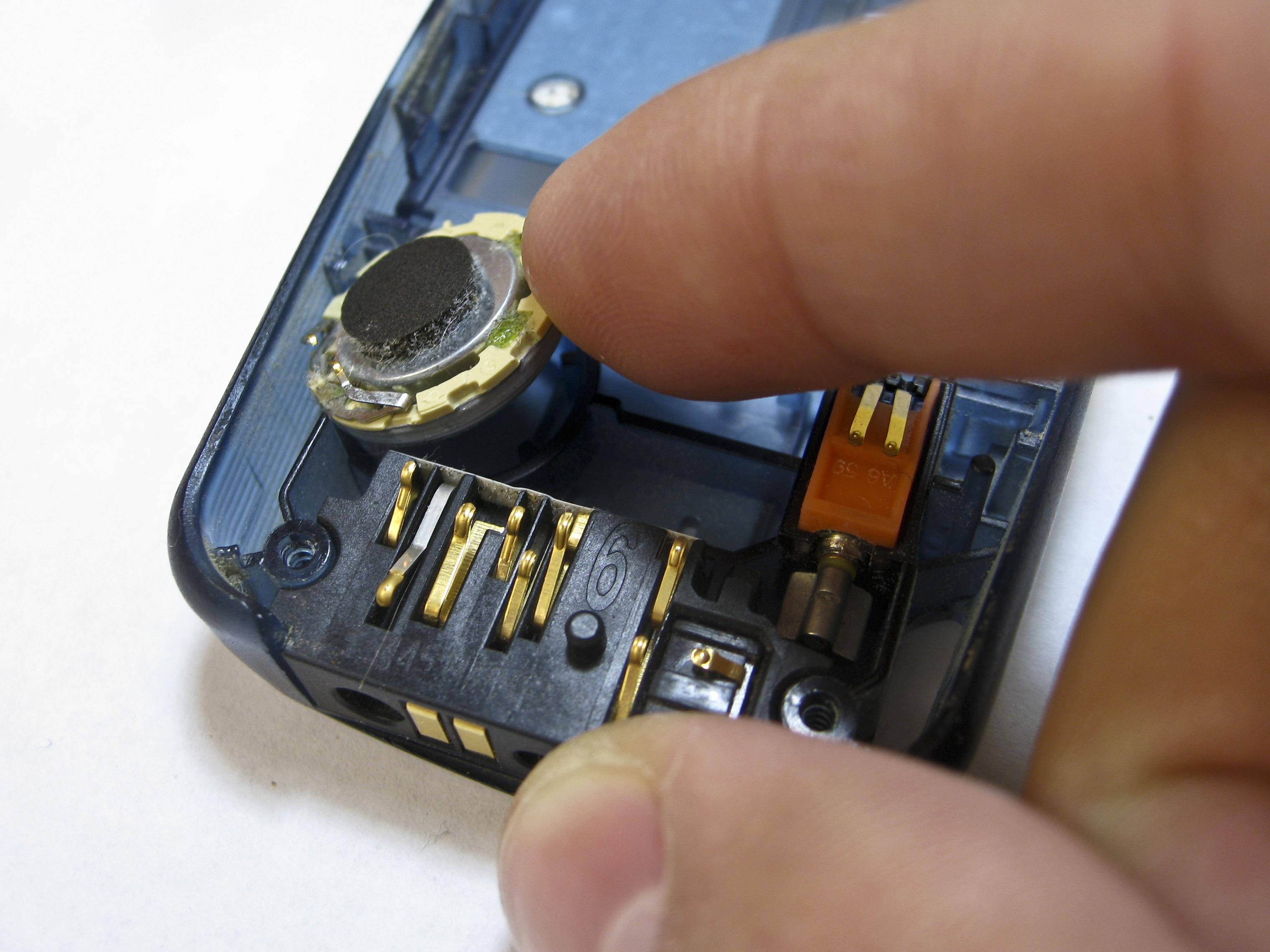

Use this guide to remove and replace the Nokia 6010's microphone.

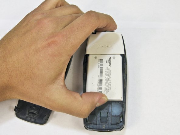

  • Press the small tab on the bottom of the back of the phone.
  • Push the back case upward towards the power button. The back case will then pop off.
    • It requires some force, so be careful.

  • Lift the battery near the bottom and pry up.

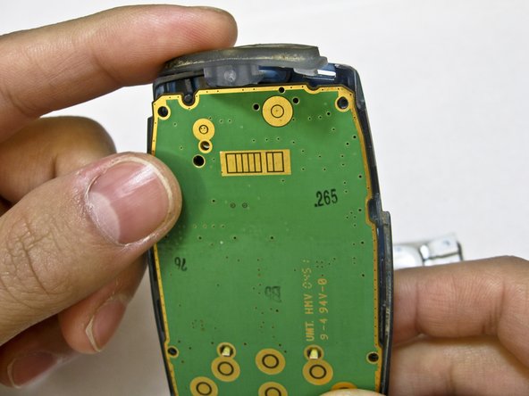

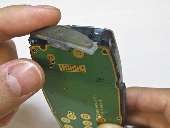

Add Note Edit Step 8 — Logic Board  ¶
  • Slide the rubber power button away from the body of the phone.
    • The power button is the rubber piece on the top of the phone.
