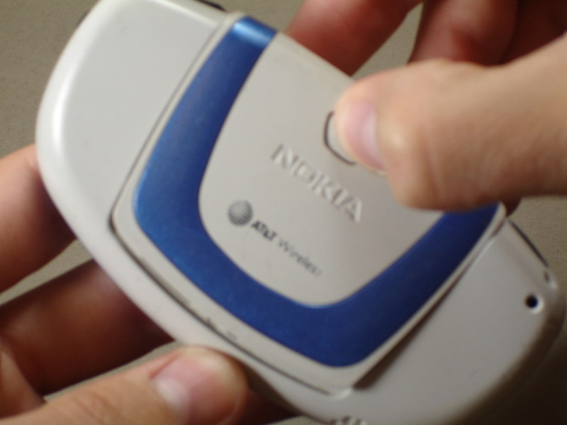

  • Hold the phone with the back-side facing you.
  • Gently press the button on the back of the battery cover. Slide the cover up.

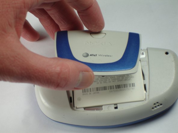

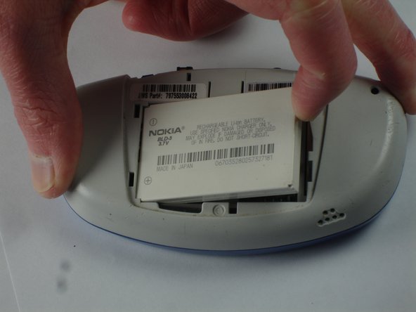

  • Lift the battery out of the phone.
  • Note: It is easiest to lift the battery out from the right-hand side, as seen in the picture.

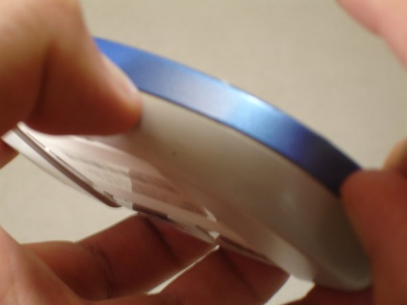

  • Gently push the blue tabs on the top of the phone out of their slots.
  • With the phone facing up, pop the blue faceplate off by using your fingernail (or some tweezers) and working your way around the phone.
  • Note: If the blue cover does not detach easily use your finger nails to try and split it open, as seen in the picture.

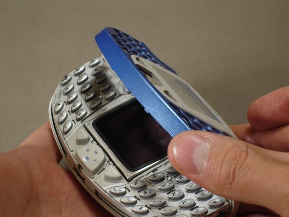

  • With the screen still facing you, remove the blue faceplate.

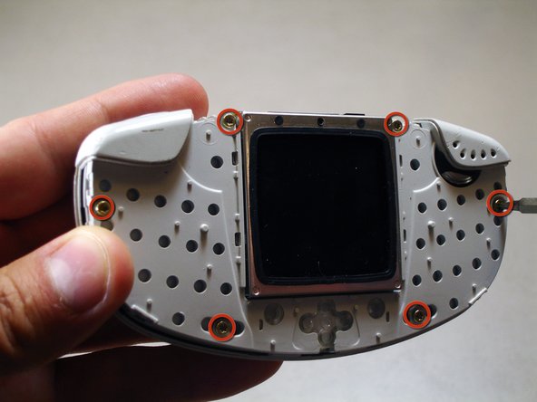

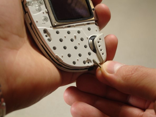

  • Remove six Torx T6 screws from the phone's front case.
Image #1
Add Note Edit Step 7  ¶

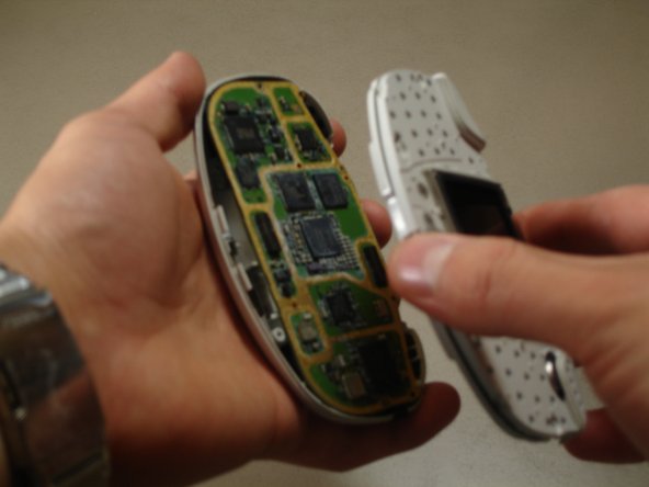

  • Pull up on the front case / screen assembly to separate it from the rest of the phone.
  • Gently lift the main board out of the back case.
