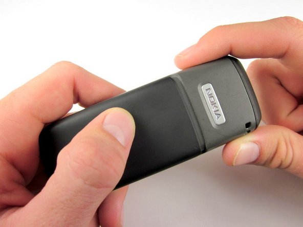

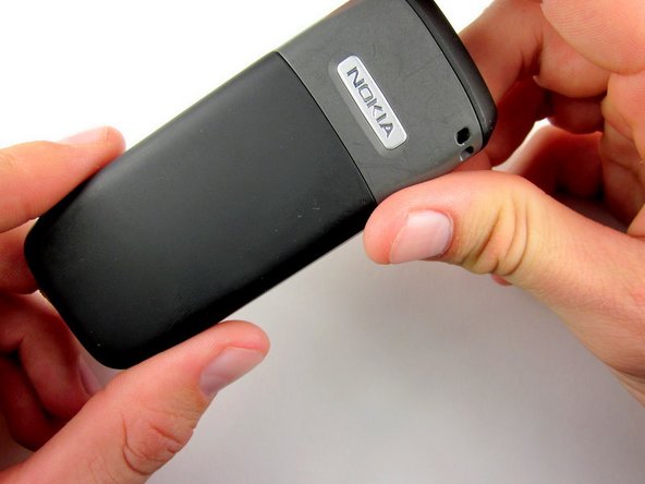

Add Note Edit Step 1 — Battery and Sim Card  ¶
  • Place your thumb on the middle of the back cover and push it toward the bottom of the phone to slide the cover off.

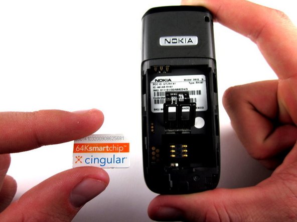

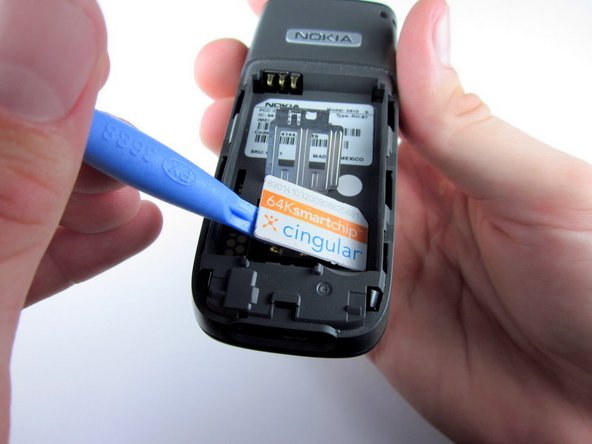

Add Note Edit Step 3  ¶
  • Lift the metal sim card holder (at the bottom of the battery slot) up and carefully pry the sim card out of its slot with a plastic opening tool or your finger.
  • After removal, lower the metal sim card holder into its original position.

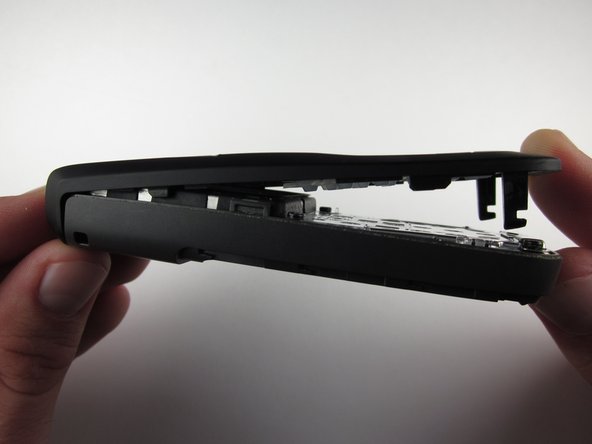

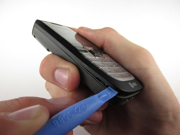

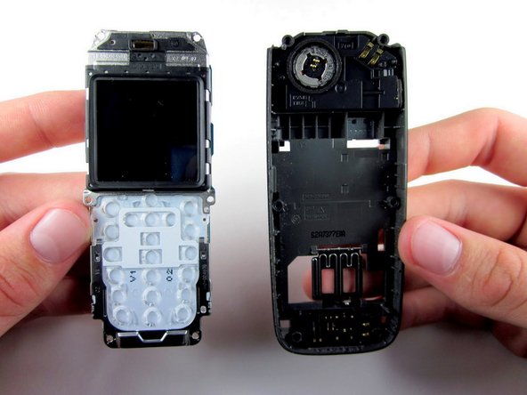

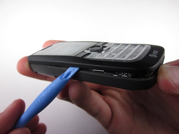

Add Note Edit Step 4 — Front Pannel  ¶
  • Insert the plastic opening tool into the crack between the front and back panels.
  • Gently pry the front cover away from the back cover while sliding the plastic opening tool towards the top of the phone.
Image #1 Image #2

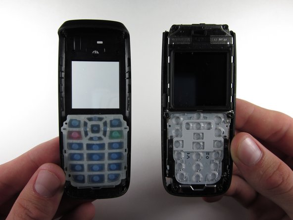

Add Note Edit Step 5  ¶
  • Lift the bottom of the front cover away from the phone.
  • Continue lifting until the top of the front cover is fully removed from the phone.
  • Note: To replace the Keypad, gently lift it out of the front cover. It is located below the clear viewing window.

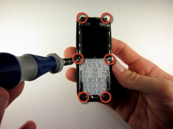

Add Note Edit Step 6 — Circuit Board  ¶
  • Use the Torx screwdriver with the T6 attachmet to remove the 6 .4 mm screws around the outside of the circuit board.
  • Note: Removing the 4 T6 screws around the screen will loosen it, so don't worry if the screen also separates from the circuit board.

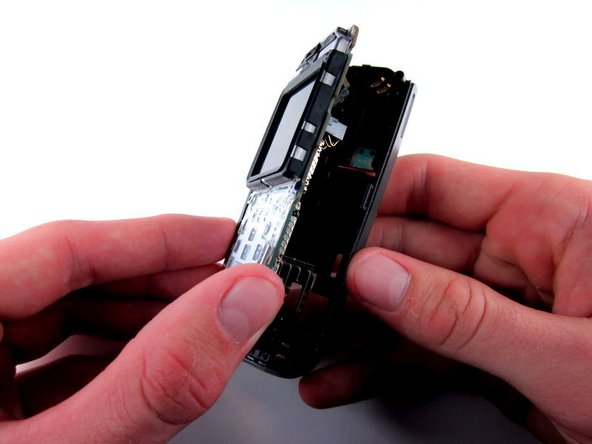

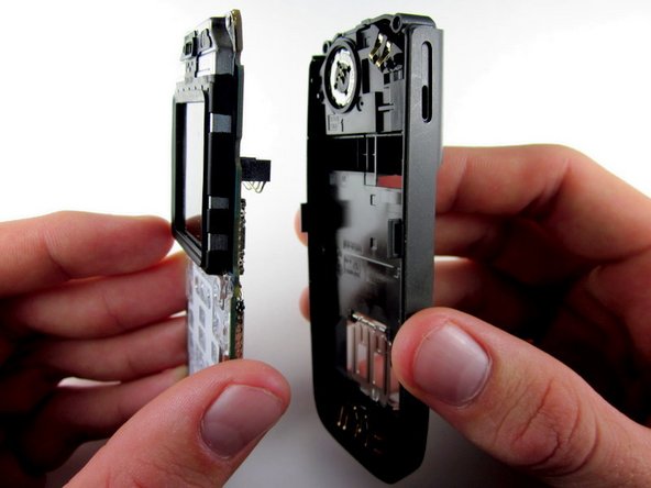

Add Note Edit Step 7  ¶
  • Lift the circuit board out of the back cover.

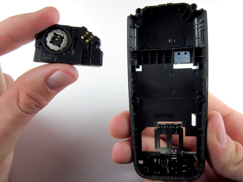

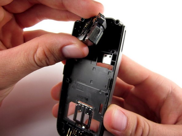

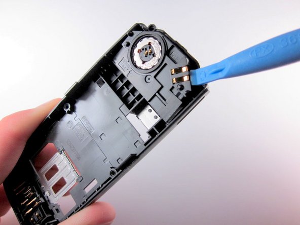

Add Note Edit Step 8 — Speaker  ¶
  • Using the plastic opening tool, gently pry the speaker out of its slot in the back cover of the phone.
  • Note: The easiest way to remove the speaker is to insert the plastic opening tool in the upper right corner of the speaker.
