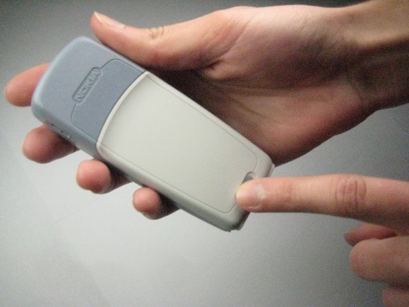

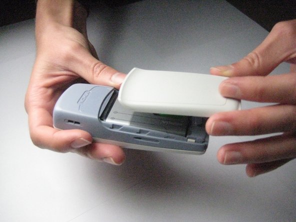

  • To prevent shock, press down on the power button located on the top of the phone until the phone shuts off.
  • Press down on the small gray button located on the back of the phone.
  • Slide the back plate down and off.

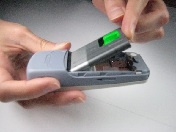

Add Note Edit Step 2  ¶
  • To remove the battery, begin by holding the phone sideways.
  • Then, insert your thumb in the groove below the battery and push the battery up and out.

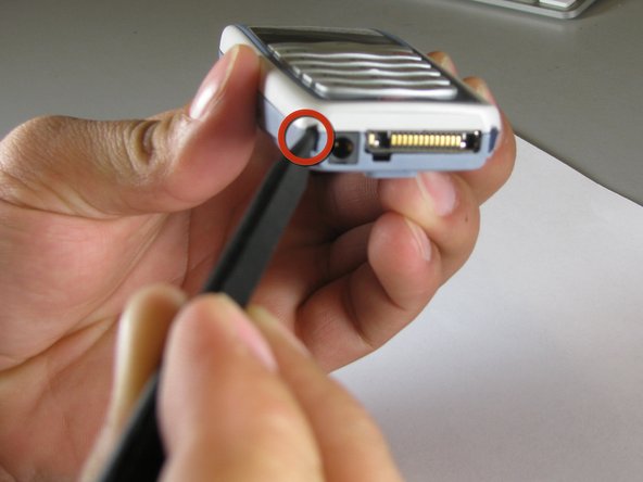

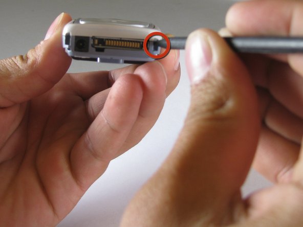

Add Note Edit Step 3 — Removing the Faceplate  ¶
  • Locate the spudger. A photo of the correct spudger is provided to the left.
  • Turn the front of the phone to face you. Find the two small square holes on the bottom left and right sides of the faceplate.
  • Insert the spudger into each square hole and push up to detach the face plate.

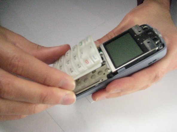

Add Note Edit Step 4 — Removing the Keypad  ¶
  • Note: The keypad will be loose and may fall off during this step.
  • Pull the face plate up and off of the phone.
  • To remove the keypad, simply lift it off the phone.

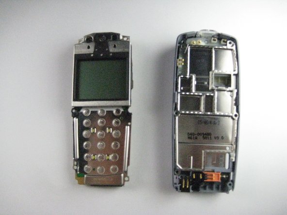

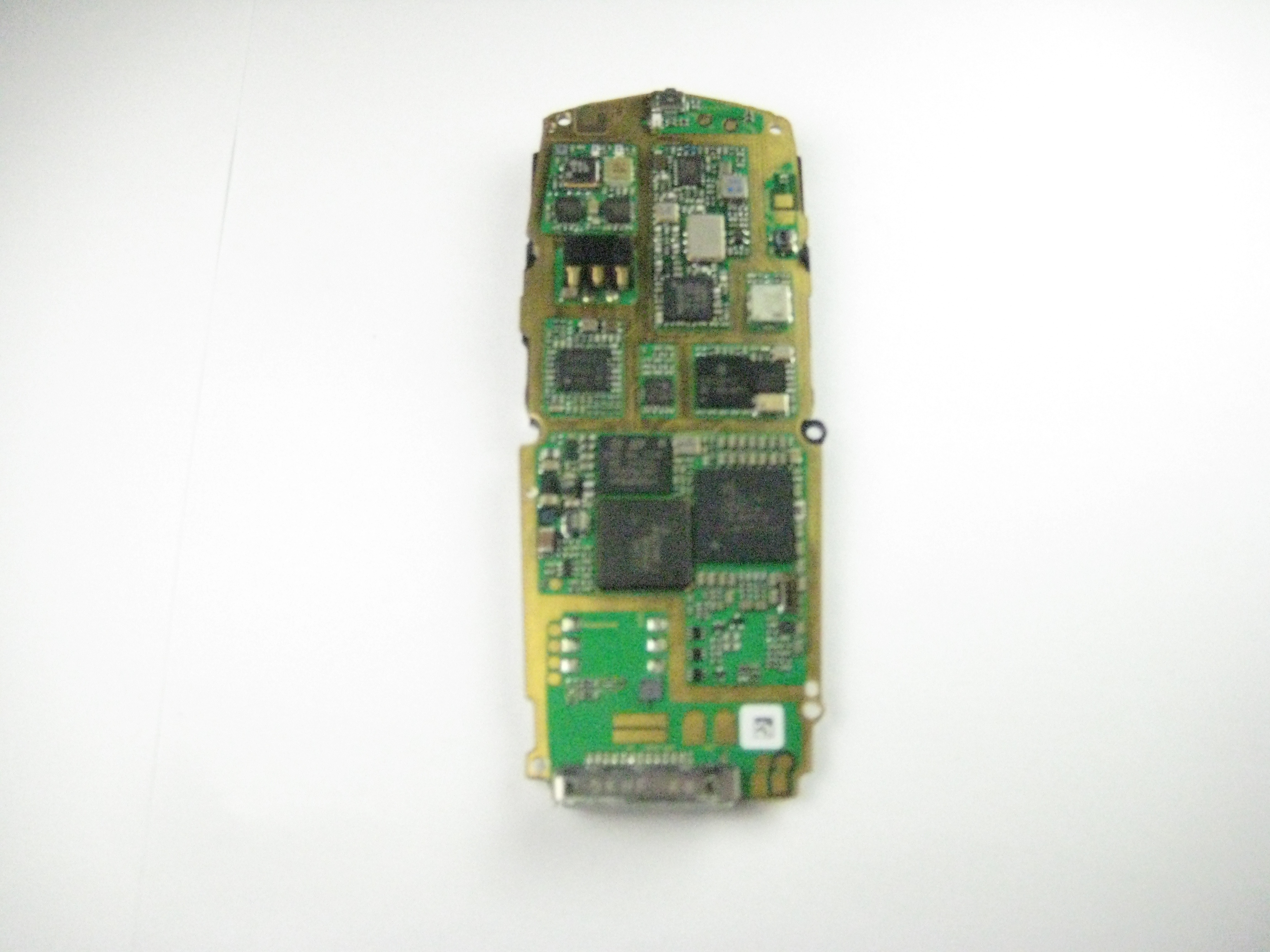

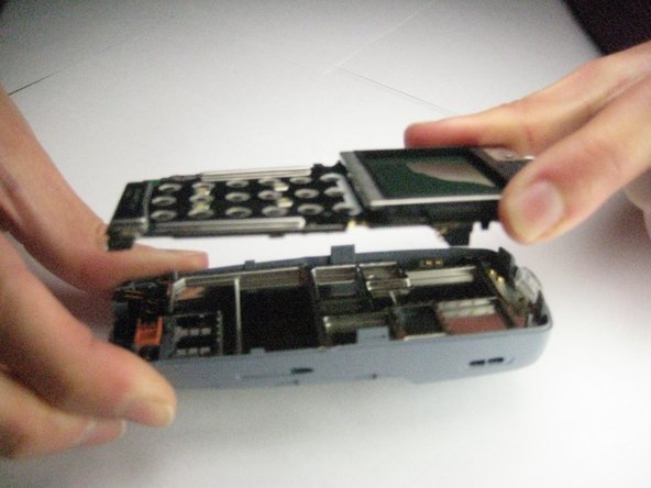

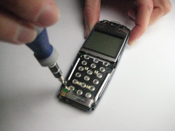

Add Note Edit Step 5 — Removing the Motherboard  ¶
  • Locate the 6 screws on the metallic sheet that previously held the keypad. (This sheet, shown in the pictures, is the top side of the motherboard).
  • Note: 2 of the screws are on the bottom corners, 2 are on the right and left edges of the phone below the screen, and 2 are on the very top corners of the phone, above the screen.
  • Warning: The middle two screws are attached to the base of the phone with two black plastic rings. Use tweezers to remove the screws carefully to avoid breaking the plastic rings
  • Use a size T6 Torx screwdriver to remove each of these 6 screws.
Image #1 Image #2 Image #3

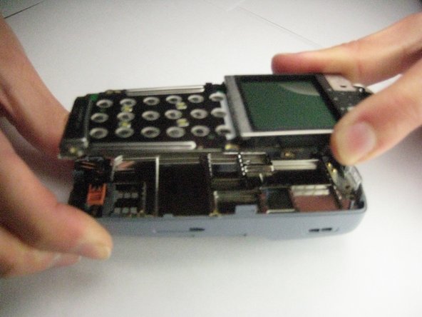

Add Note Edit Step 6  ¶
  • To remove the motherboard, lift it up and off the phone.
  • Note: The screen will still be attached to the motherboard.
