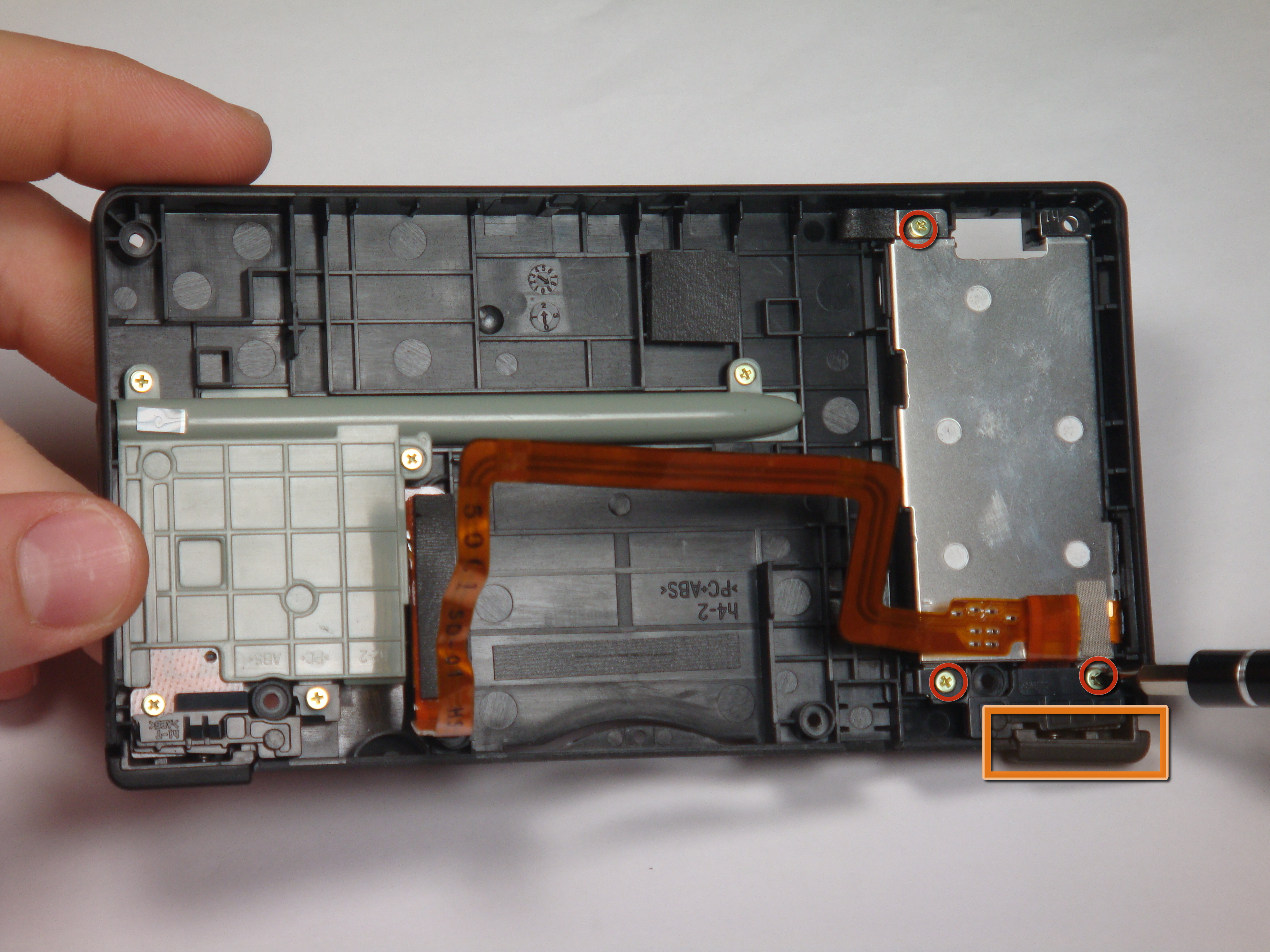

Add Note Edit Step 4  ¶
  • Remove the following screws securing the lower case to the body of the DSi:
    • Six 5.2 mm Phillips screws.
    • One 2.7 mm Phillips screw.
Image #1 Image #2 Image #3
