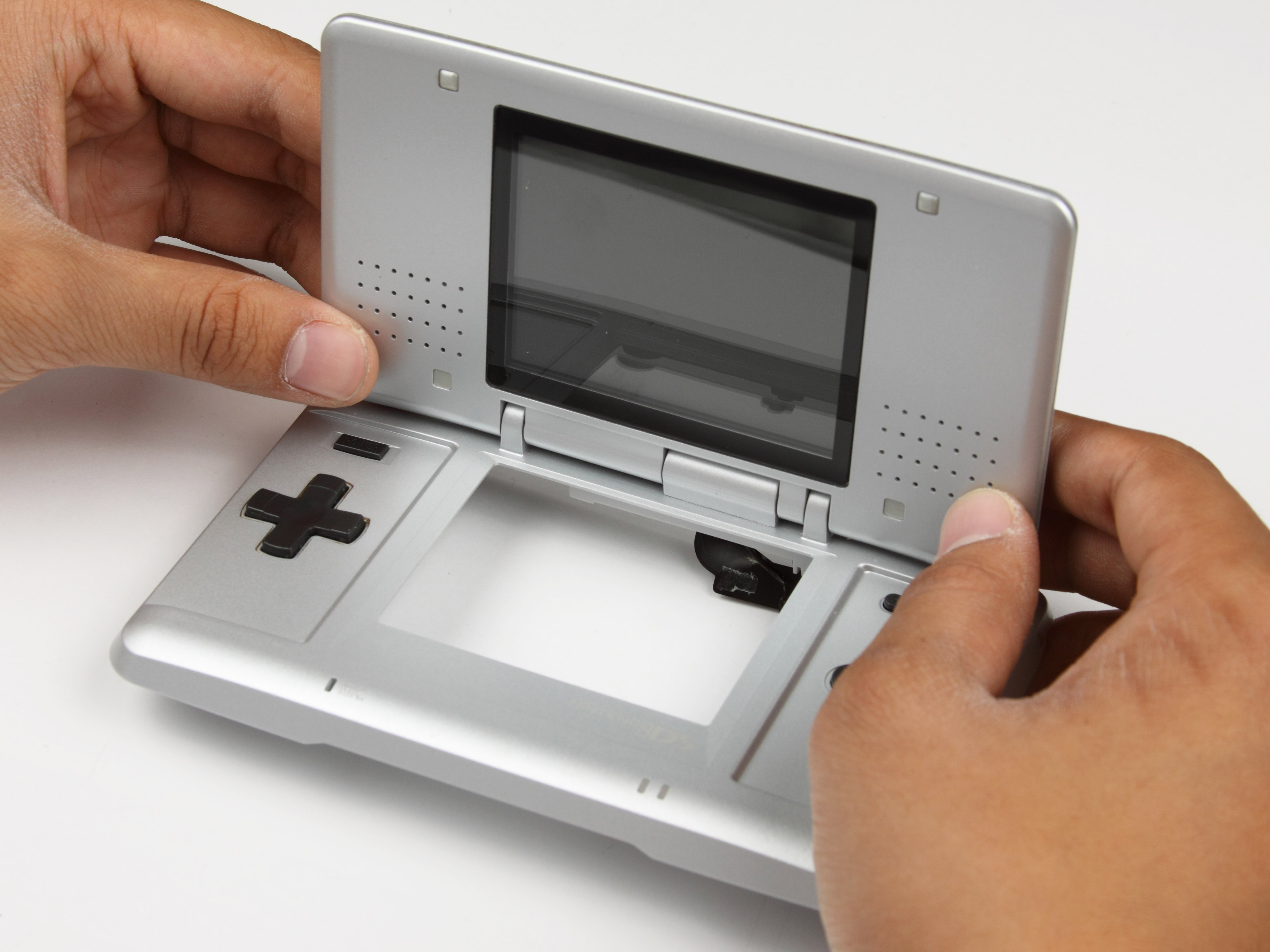

  • Using a soft plastic tool, pry the edges of the plastic case apart at the seam.
first image
thumb image 1
thumb image 2
thumb image 3
Add Note Edit Step 14  ¶
  • Separate the top cover from the body.
  • Using a Phillips #00 screwdriver, remove the screw holding the hinge cover in place.
  • Remove the hinge cover and set it aside.
