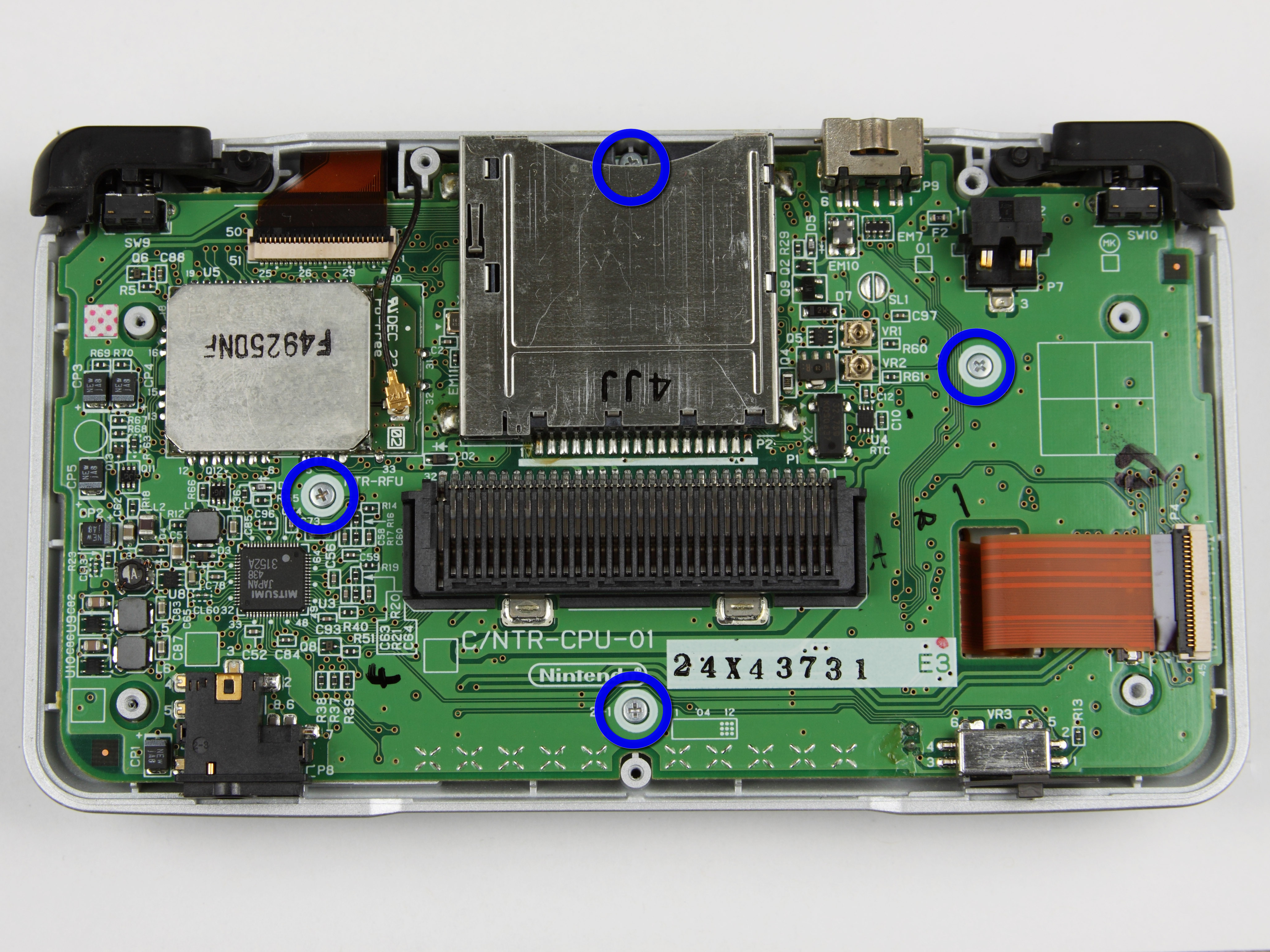

Add Note Edit Step 6 — Main Circuit Board  ¶
  • Using a Phillips #00 screwdriver, remove the 4 screws on the circuit board.
  • Be careful NOT to slip with the screwdriver, you can damage the circuit board!
Image #1 Image #2 Image #3
