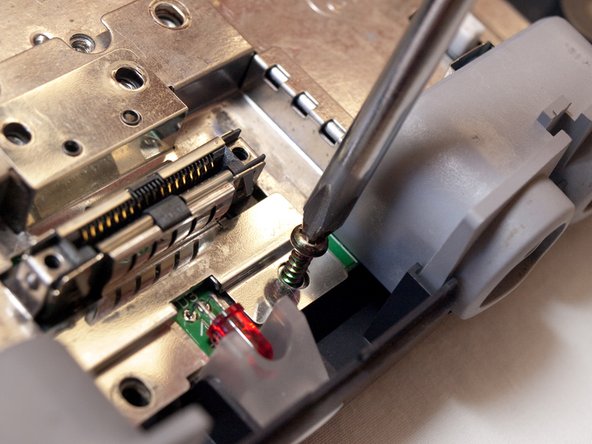

Add Note Edit Step 9  ¶
  • Remove the screw to the right of the LED using the large Phillips screwdriver.
Image #1

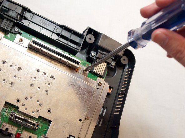

Add Note Edit Step 10  ¶
  • Remove the small metal bracket from the back of the expansion pack slot.
Image #1 Image #2

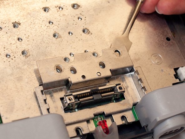

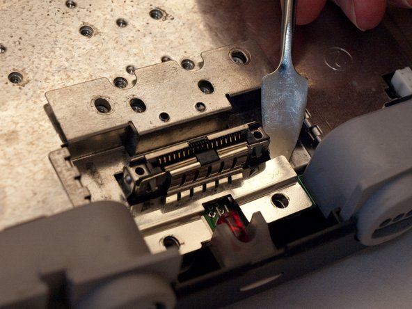

Add Note Edit Step 11  ¶
  • Remove the small metal bracket from the front of the expansion pack slot with the metal spudger.
Image #1 Image #2

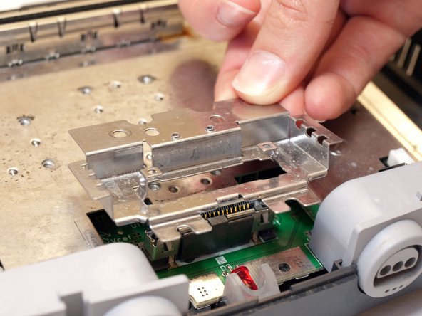

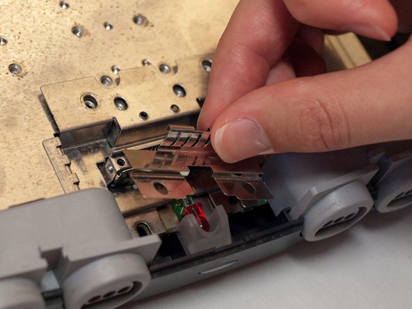

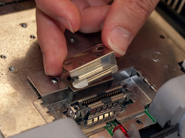

Add Note Edit Step 12  ¶
  • Remove the small metal bracket using the spudger.
Image #1 Image #2

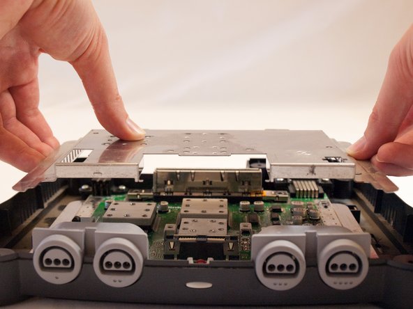

Add Note Edit Step 14  ¶
  • Remove the metal plate shown.
Image #1

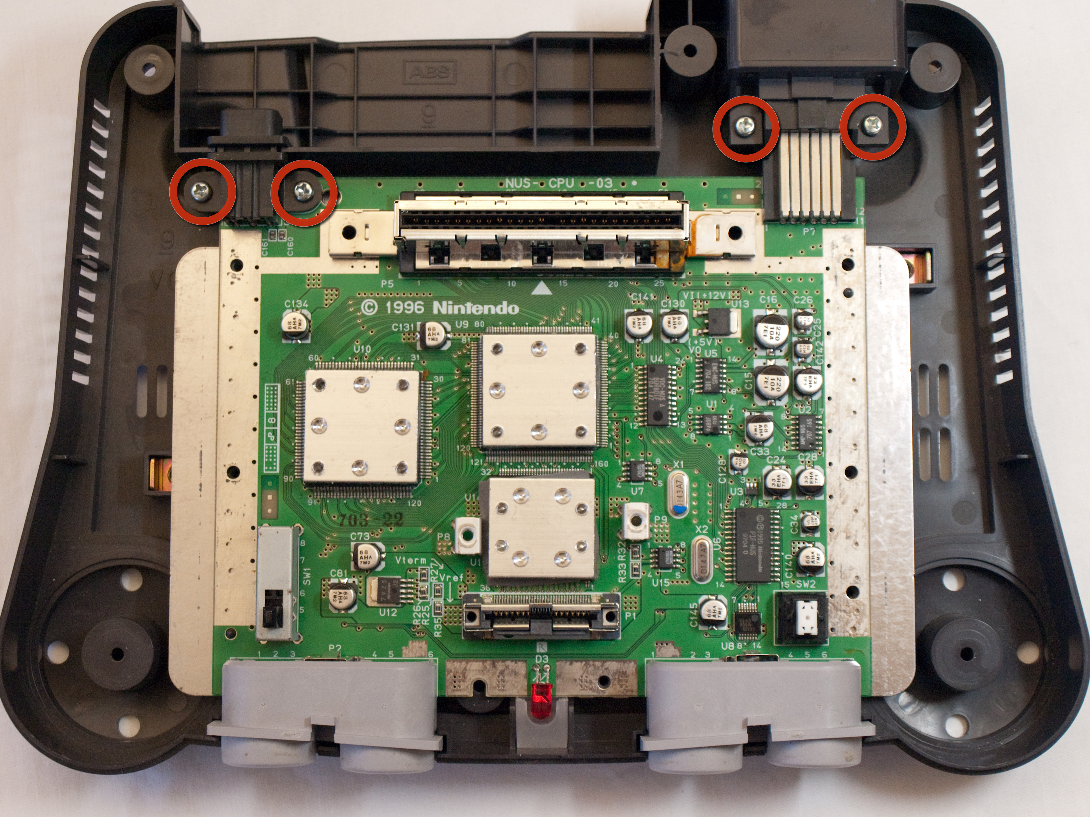

Add Note Edit Step 15 — Motherboard  ¶
  • Remove the 4 screws shown using the large Phillips screwdriver.
Image #1
Add Note Edit Step 16  ¶
  • Slide up and remove the motherboard.
