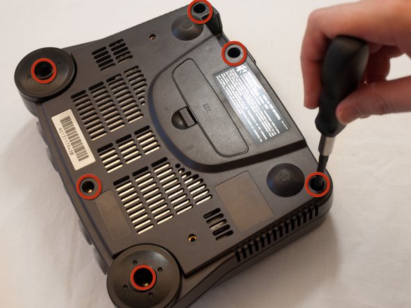

Add Note Edit Step 3  ¶
  • Remove the 6 screws shown with a gamebit head or screwdriver.

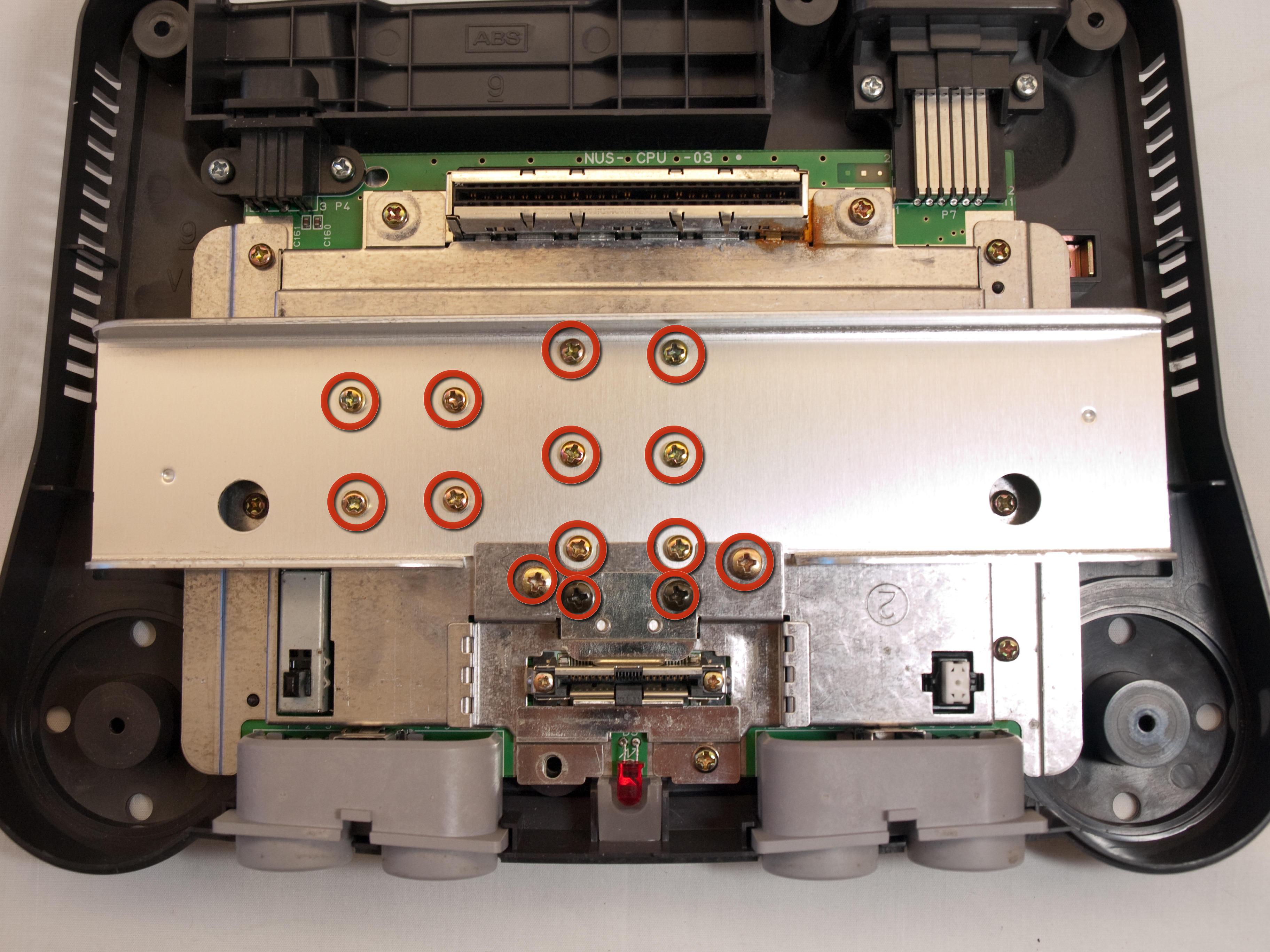

Add Note Edit Step 6 — Metal Plate  ¶
  • Remove the 14 screws shown using the large Phillips screwdriver.

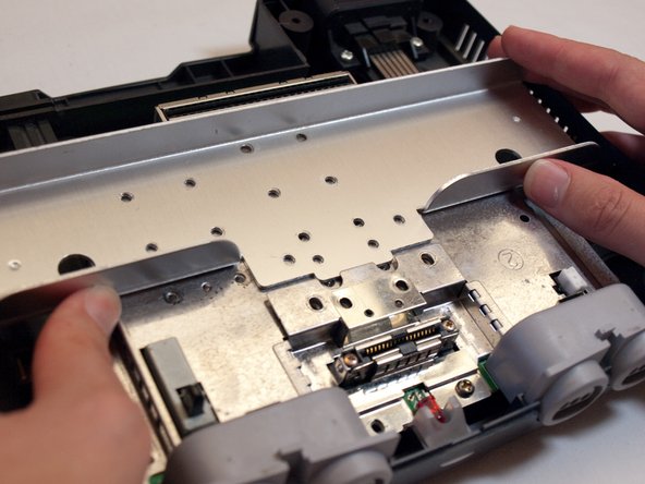

Add Note Edit Step 7  ¶
  • Remove the metal plate by sliding it back then up.

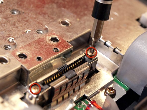

Add Note Edit Step 8  ¶
  • Remove the 2 screws shown using the small Phillips screwdriver.

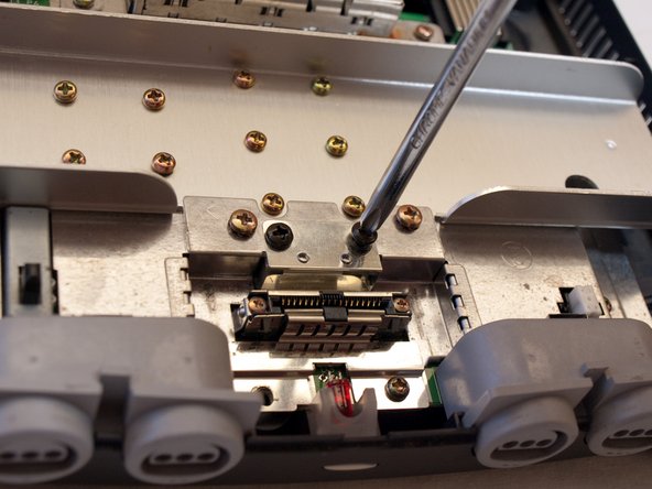

Add Note Edit Step 11  ¶
  • Remove the small metal bracket from the front of the expansion pack slot with the metal spudger.

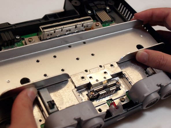

Add Note Edit Step 12  ¶
  • Remove the small metal bracket using the spudger.
