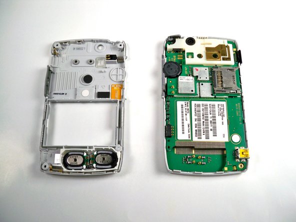

  • Use the T6 screwdriver to remove the four screws holding the casing together.
  • Note: they are in the same place where you removed the four rubber coverings
Image #1 Image #2

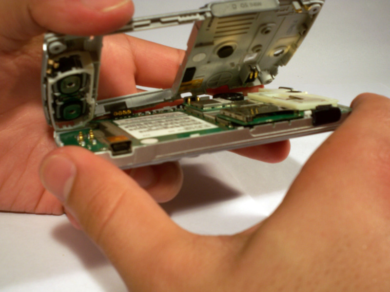

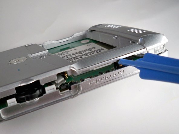

Add Note Edit Step 3  ¶
  • Wedge the plastic opening tool in between the top and bottom cases. This may require a little or a lot of force so be careful.
  • Note: the phone should be face up and the plastic opening tool should be face downwards
  • Once you get the plastic opening tool in, slide it across the side of the phone, making sure to keep the plastic opening tool wedged in between the two casings.
  • Repeat the 3 steps above for the top, bottom, and opposite side.
Image #1 Image #2

  • Gently lift and remove the back casing.
