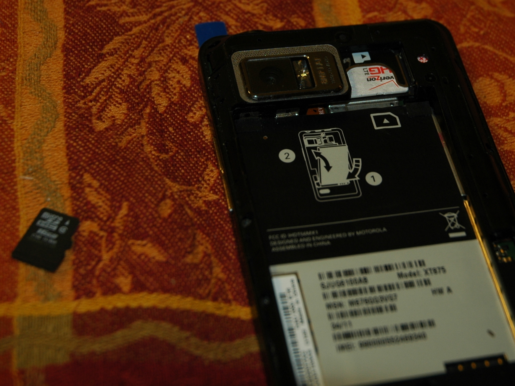

  1. Motorola Droid Bionic Screen with digitizer Replacement, Front Glass/Digitizer: step 1, image 1 of 1
    • Open Case, remove Battery, SD Card, and SIM Card

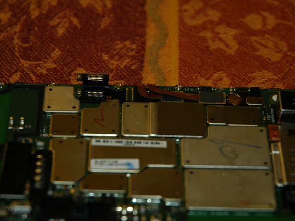

  5. Motorola Droid Bionic Screen with digitizer Replacement: step 6, image 1 of 2 Motorola Droid Bionic Screen with digitizer Replacement: step 6, image 2 of 2
    • Disconnect three ribbon cables from the mother board EDIT Under the Black Spacer Bar is a Fourth Ribbon cable.
    • One of them is from the LCD screen and the other two are for the digitizer. EDIT Looks like it goes to the forward facing camera.

What a royal pain in the a$$... haha it actually was pretty simple, you guys left out that when removing the motherboard from the LCD, the earphone part is stuck together with sticky stuff and has to be pried apart carefully, so not to damage the small cable, I also used a hairdryer to help remove the "lens" from the frame, I salvaged most of the two sided tape but it was stretched out so I had to trim and tuck a little, overall it went back together very simple and everything works great!! Thx for the help!

Thank you. Helped to have photos. I agree with the other post - you left out the step to pull up the orange cable near the sim card holder (earphone). It does take a bit of wrangling to get it up, but I found that instruction on a video so all is good. The lens I bought came with tools and 3M tape so I didn't have to reuse the old tape from the phone.
